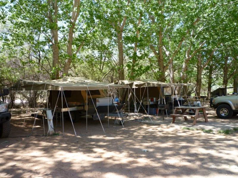

Here is the Kimberly. Mine is on the left and Ken Romer's is on the right. These were from the first small group that were brought over from Australia in 2002. These trailers have VINS that are 5 digits apart.
