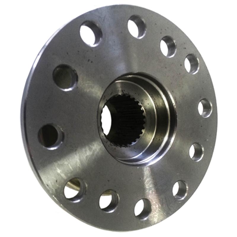

I want to buy a new pinion companion flange for the 80 front axle I'm rebuilding for the swap into my '82 BJ60. From googling it seems that the BJ60 flange is 60 x 68.5 mm 27 spline. The 1994 (I think, but maybe 1993 - it has a locker) 80 axle has either 60 x 60 or 64 x 56 mm 27 spline. (I'm away right now so can't check which one it is). How have people been dealing with this for bolting to the front driveshaft?
I bought a multi hole companion flange and it didn't work. Had to take the original 80 flange to the driveline shop and have it drilled and tapped. Still waiting for it to come back. But should have done that in the first place. plenty of room on the companion flange to add the extra holes.
STOCK 80 gears with 27 spline
Toyota 8 Inch Flange V6 60x60 66x60mm/70x61.5mm 27 Spline
AFTERMARKET gears with 29 spline (to a 60 flange DS)
66mm x 66mm x 11mm, 60mm x 60mm x 10mm, 60mm x 68.3mm x 10mm, & 61.5mm x 70mm x 10mm.
