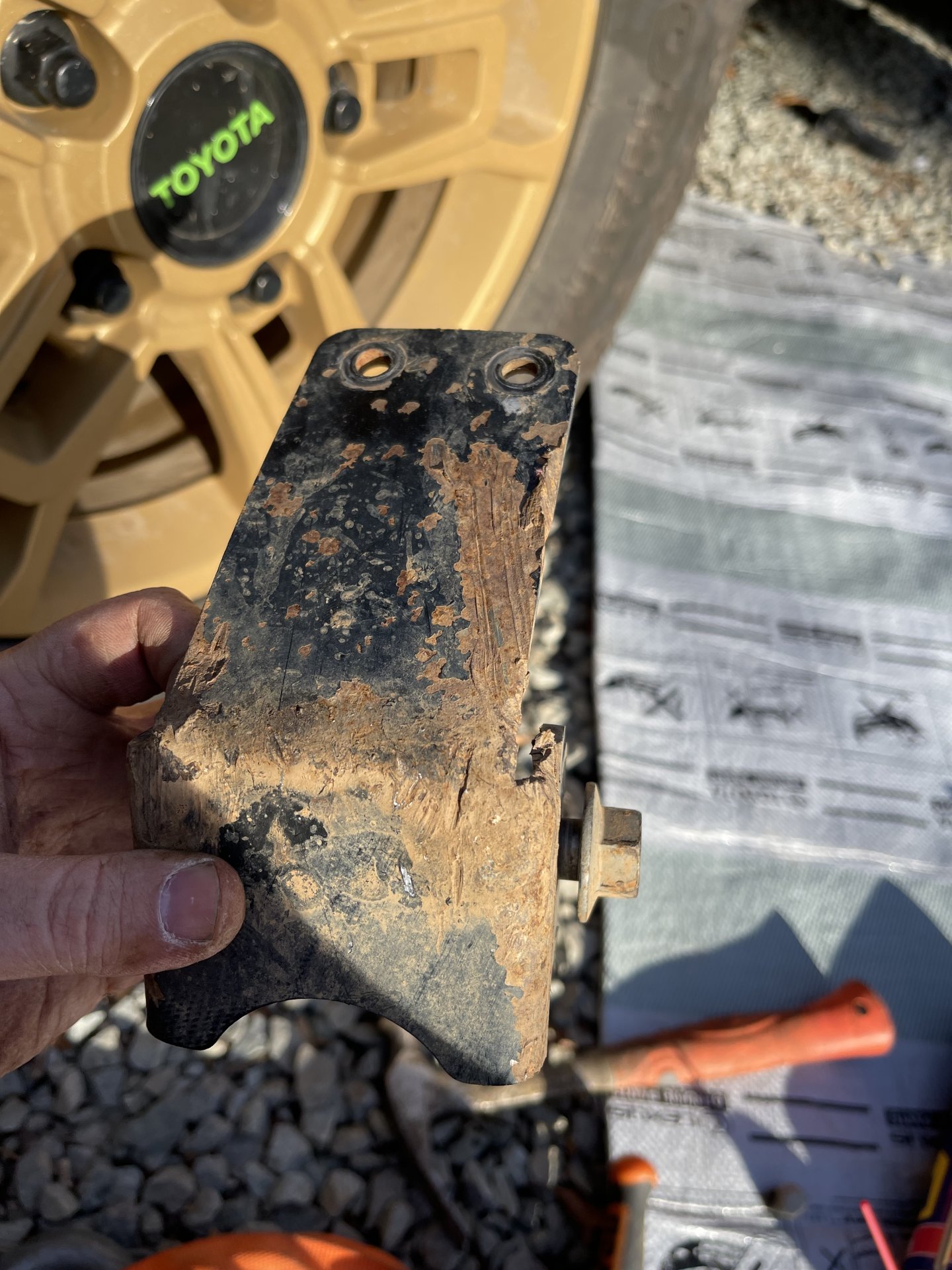

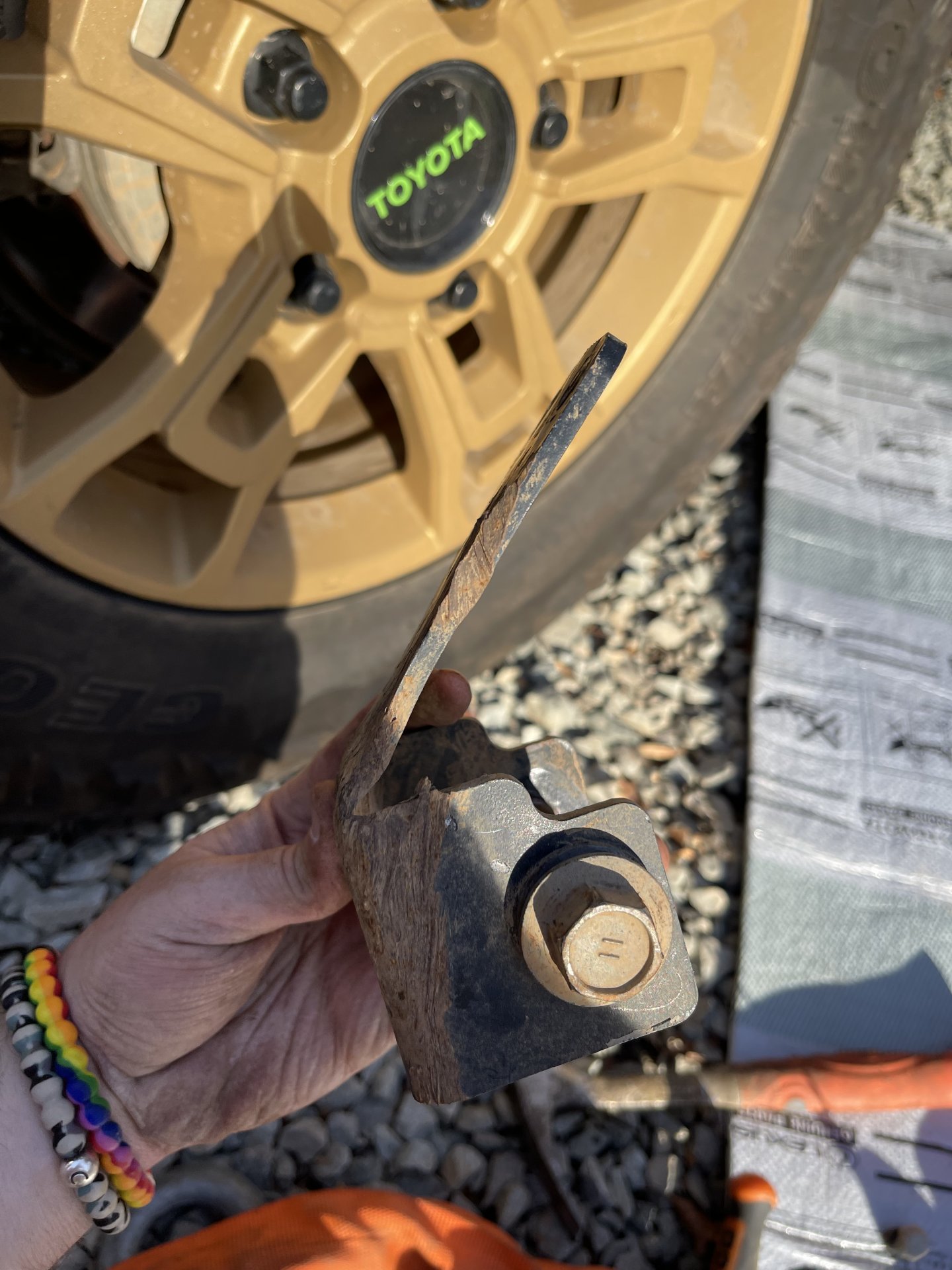

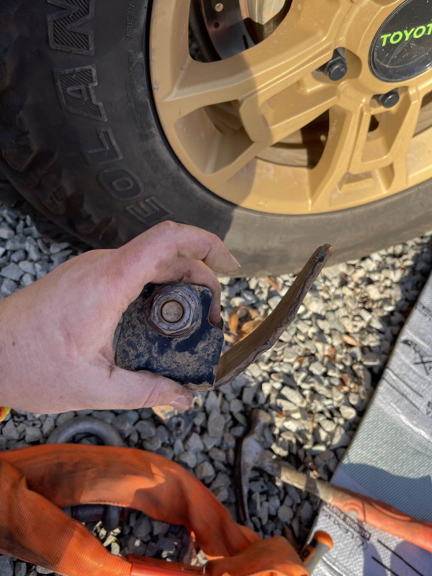

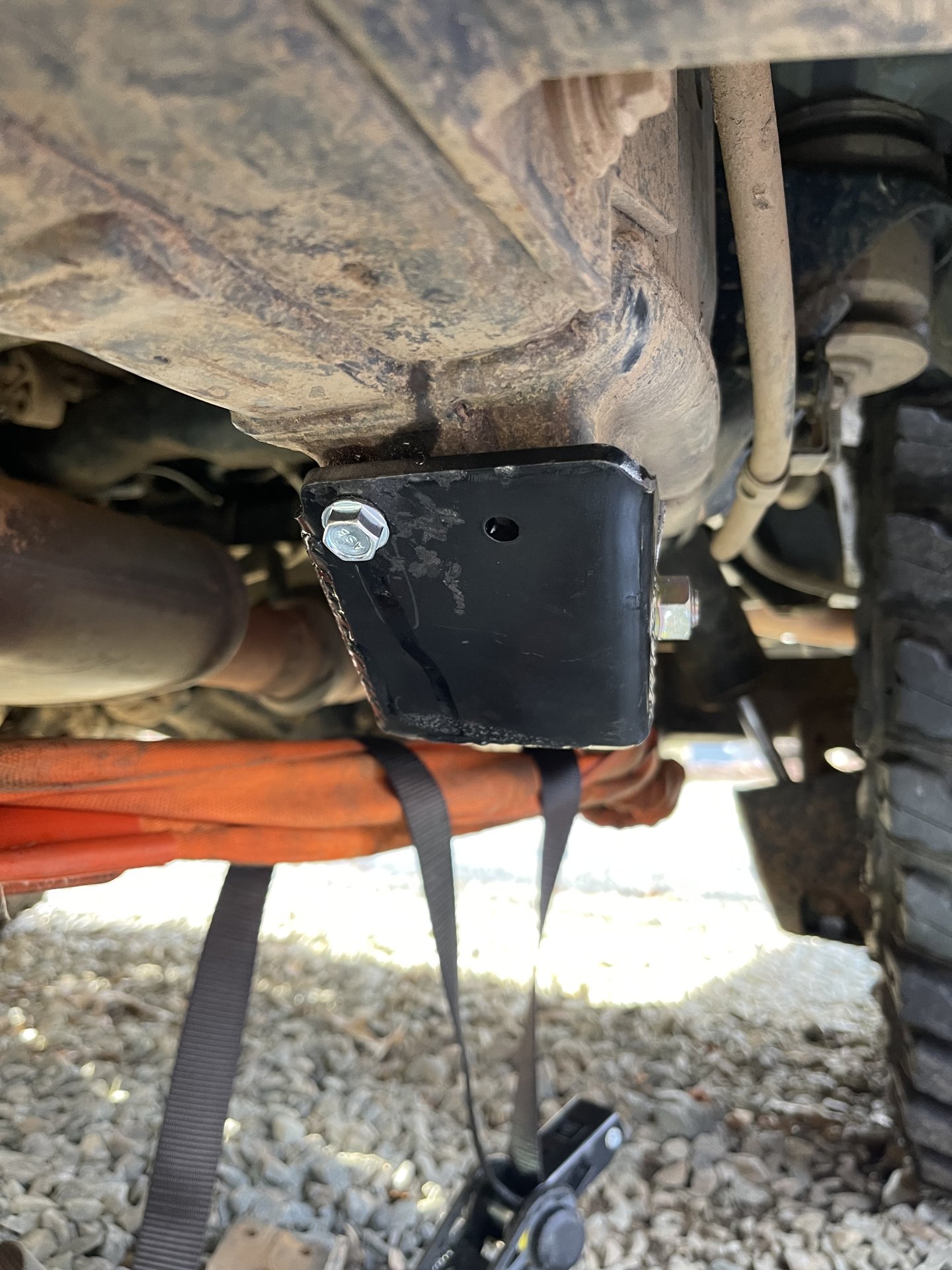

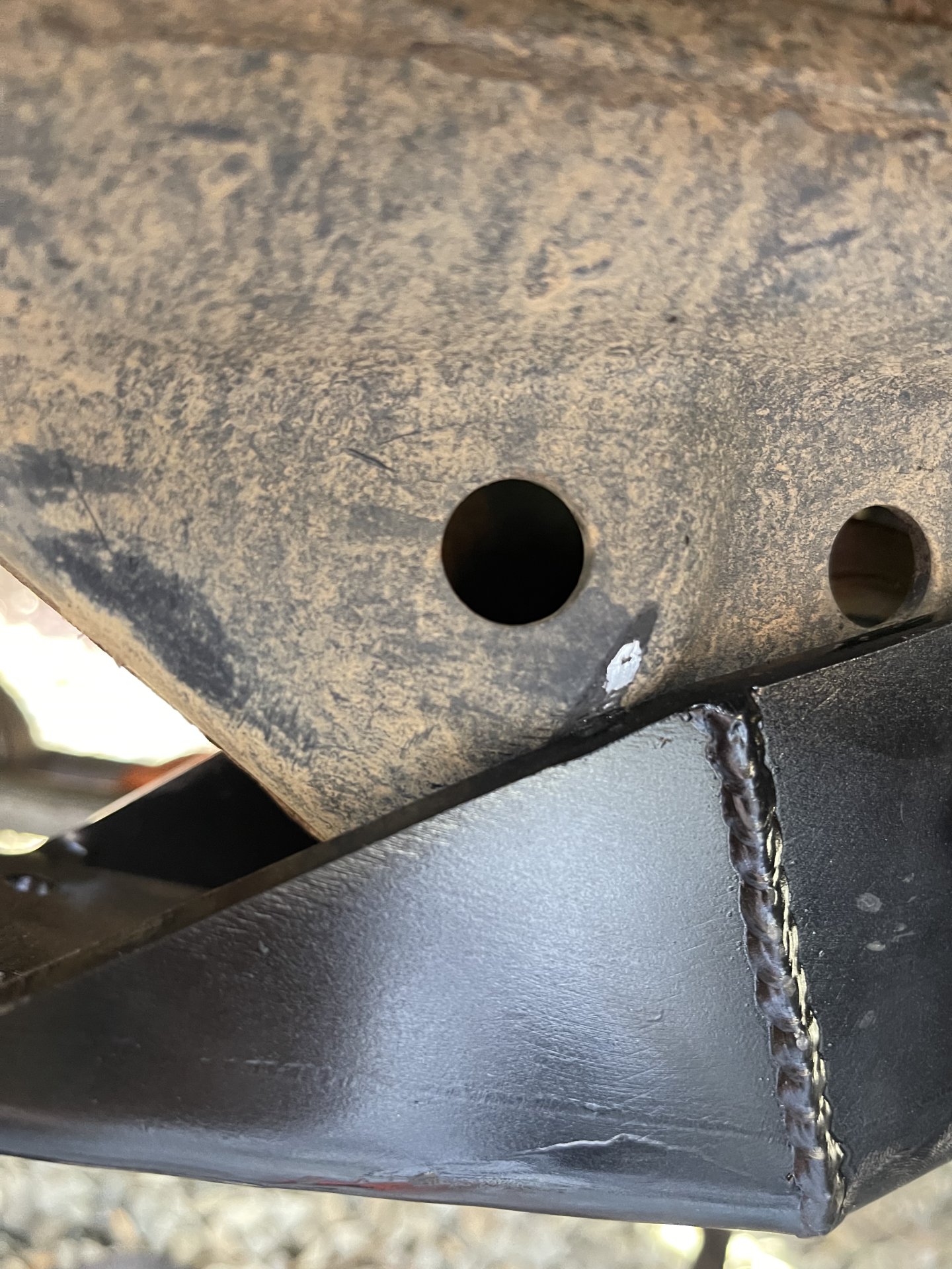

So what year was your prototype land cruiser for the lower skids?

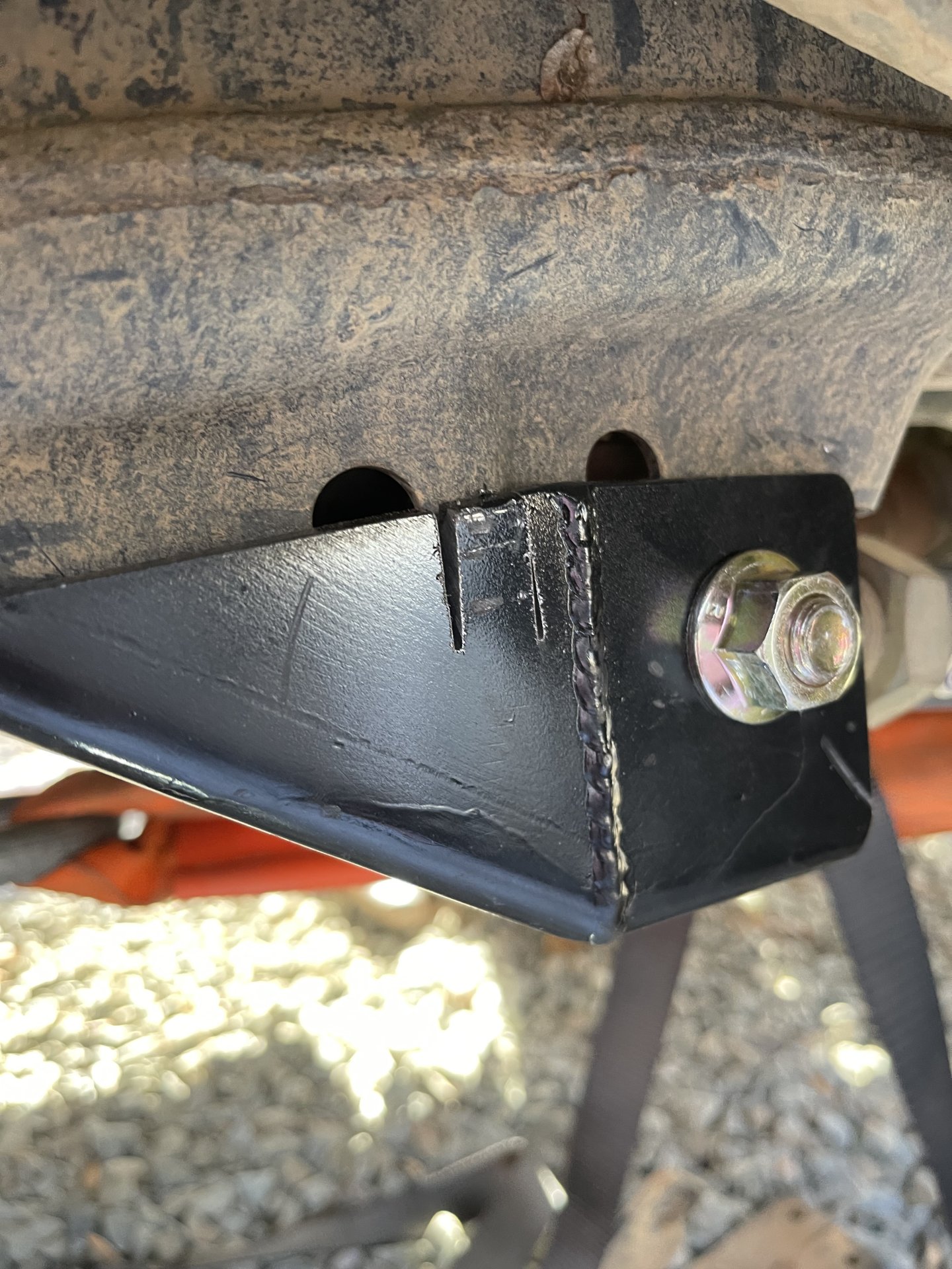

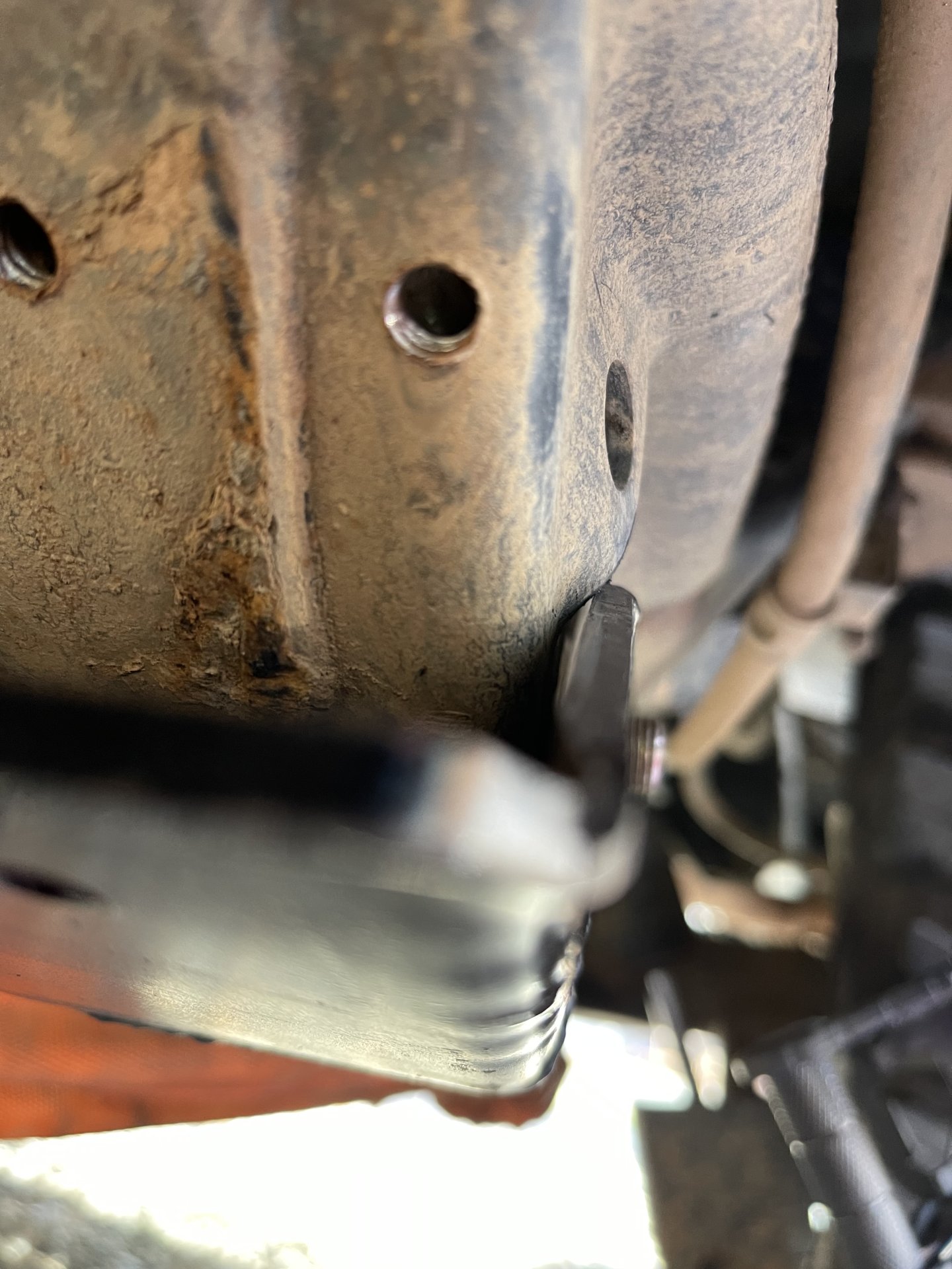

EDIT: Appears as something must be Bent or out of alignment on the driver side. Because I just did the passenger side and it fit way better. My apologies. Still 10/10 would recommend.
Mines a 2011 had a little issue on the driver side. Appears to have an extra “kick” in the frame so I May two relief cuts to help slide it in. But made it work. And I love them.

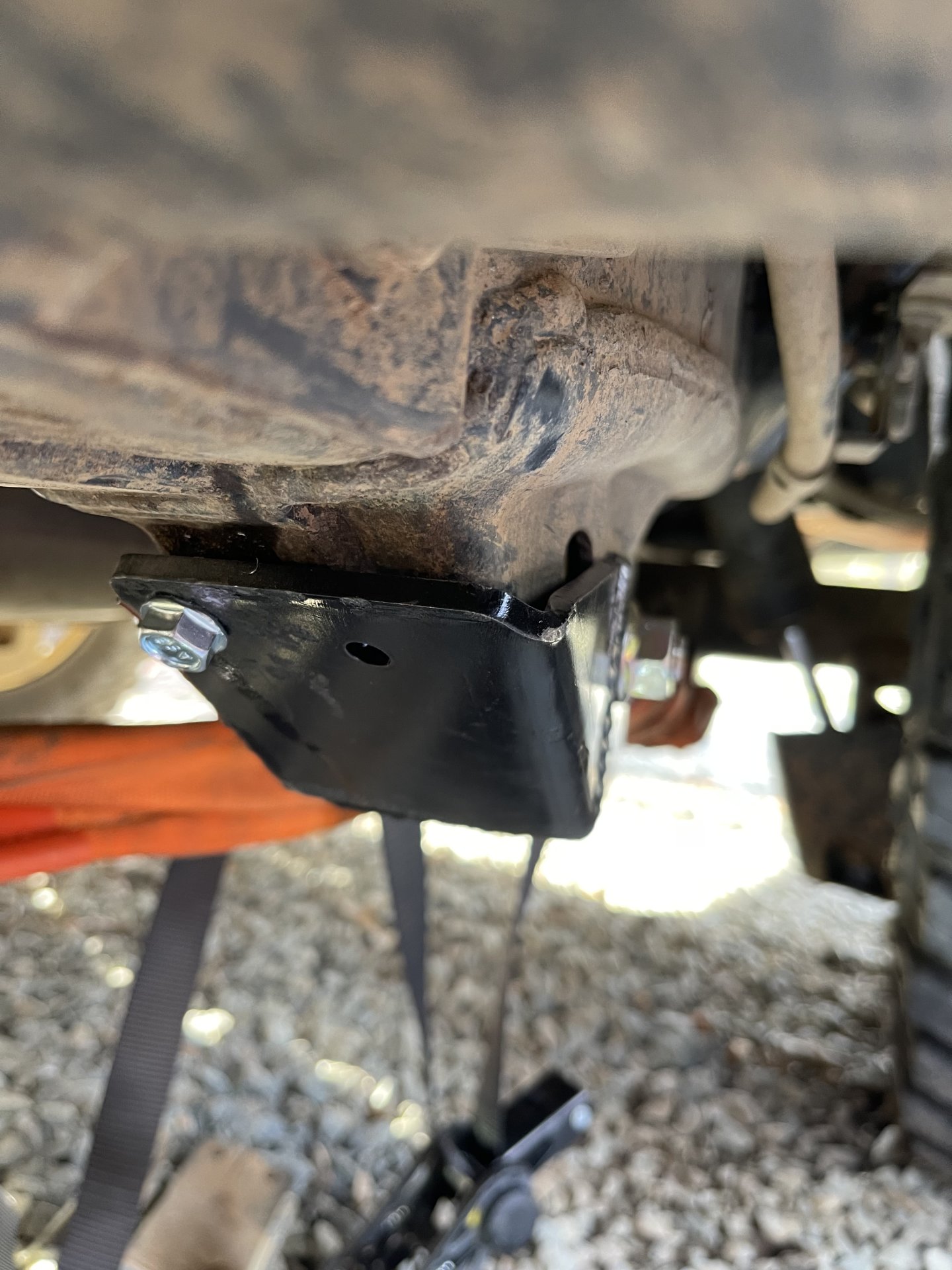

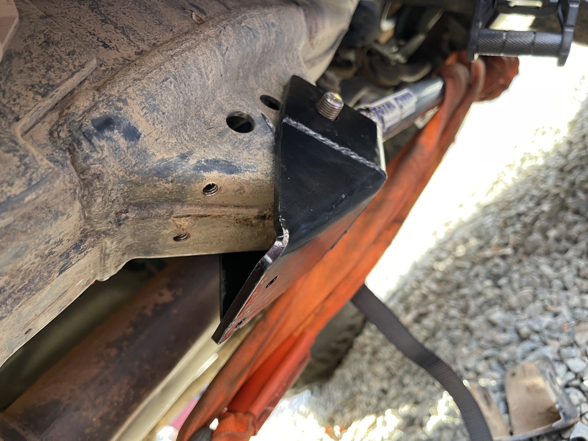

Right on nice work getting them on. I finished painting mine and will install once there's a break in the weather. I see you used ratchet straps, were they necessary to keep the lower arm in line while you replaced the bolt and added the skid? Any tips or lessons learned ?
Yes but I ended up just using the winch and ran it under the truck to the rear lower control arm where it mounts to the axel. So much easier than using the ratchet straps. Also, bring a punch guide to help get the holes aligned and to hit the bolts out. Other than that it was easy. but the winch saved the day.
Also @TRAIL TAILOR first set save me quite a few times. Glad I got new ones.
Cool, nicely done. Good call on the winch. Hadn't thought of using mine, thanks! Love your build, how are those geolander MTs for daily use and on the highway? Ive been eyeing this tire but not sure i am ready to take the plunge into a full MT tire just yet.
To align the holes you can jack the rear diff pumpkin.
Thanks, that was my initial thought process, before winching it, nice to hear this will also work. Would I use the pumpkin itself or off to the side on the rear axle?
Low point/center of pumpkin. Easy to align, though I used a floor jack to make it even easier, as I could jack and push the bolt at the same time.
I did one side at a time.
So leave the car on 4 wheels and just jack up the rear pumpkin?
