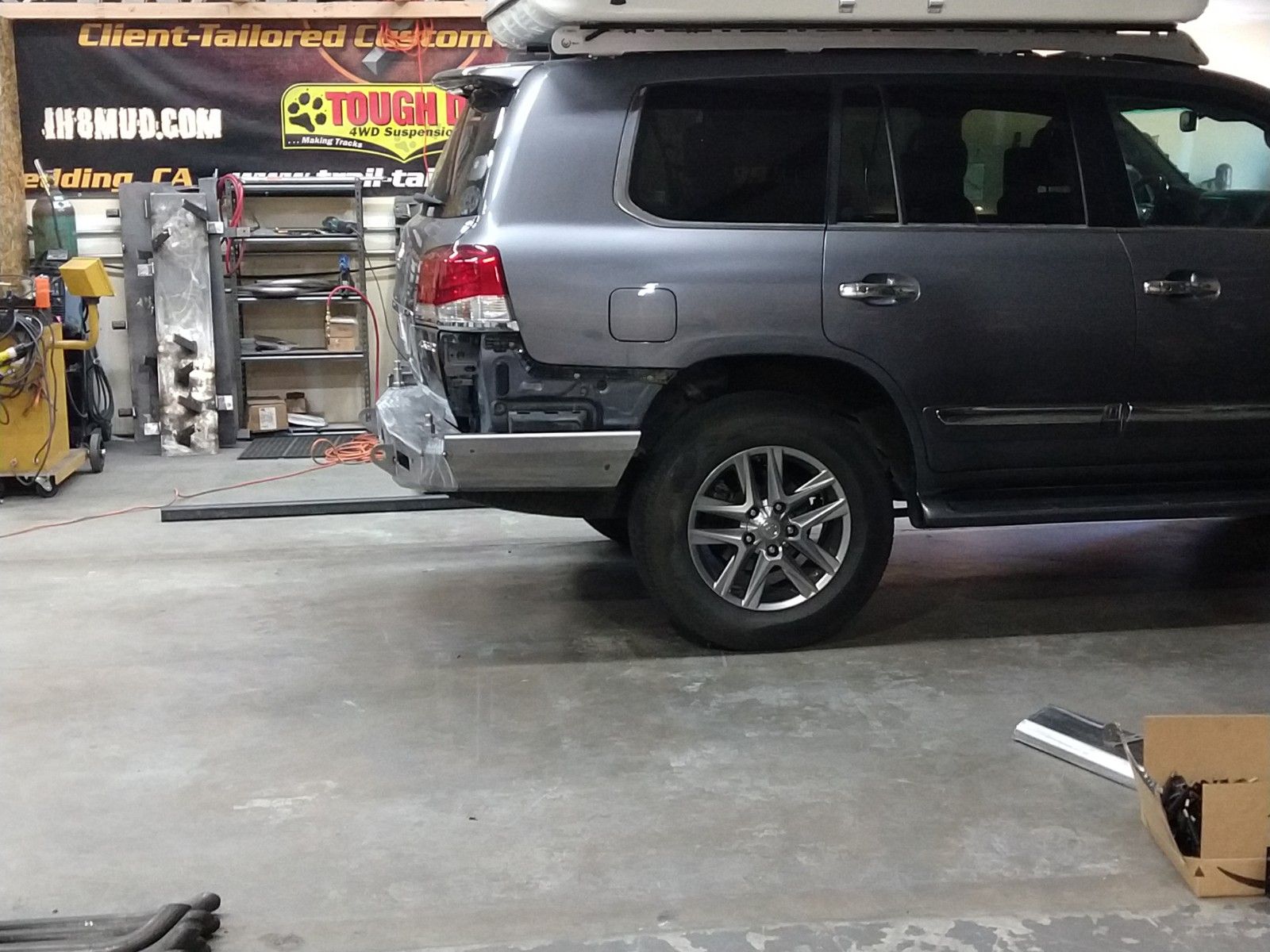

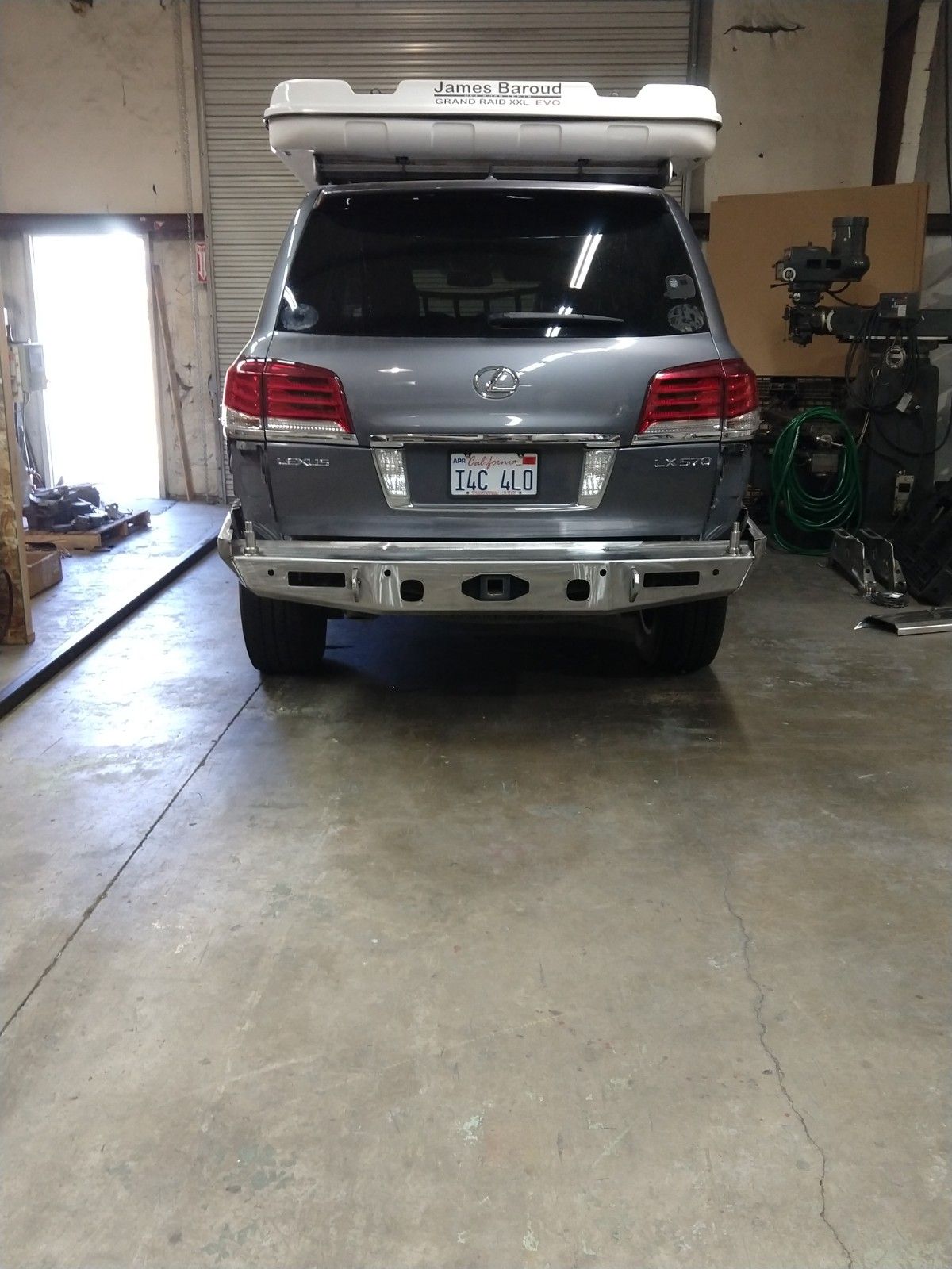

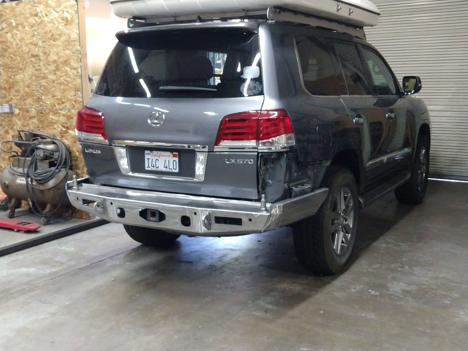

LX570 rear getting finished up and headed to powder tomorrow.
J
Would love to see what you did with AHC pump bracket underneath!
Still in the same place................ no need to reinvent the wheel, just a simple forward bracket and frame to wing plate and its done and very strong.

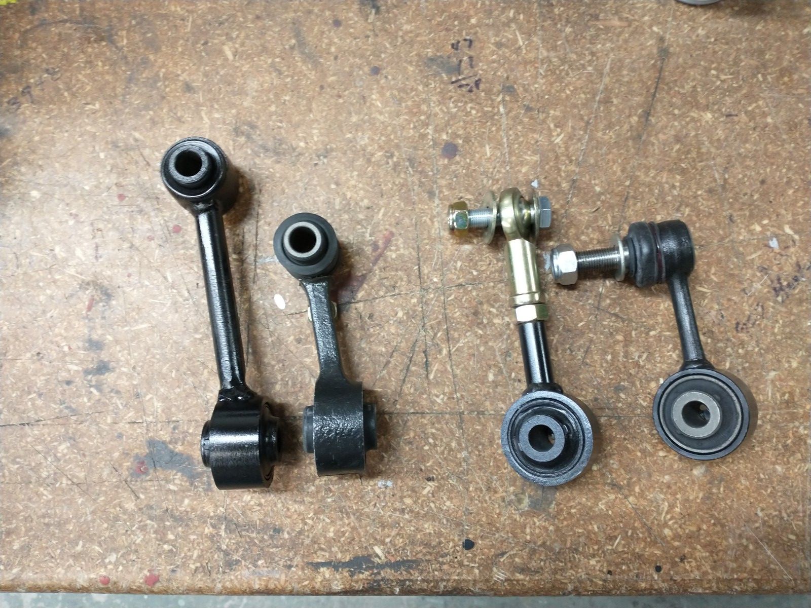

After going through this entire thread I noticed you haven't done any 16+ LX front bumpers, is it only something you would do custom? Thanks
Having recently had fun with the OME version of these parts, +1 here for aftermarket options. Trail Tailor for the win if you can fill this niche.

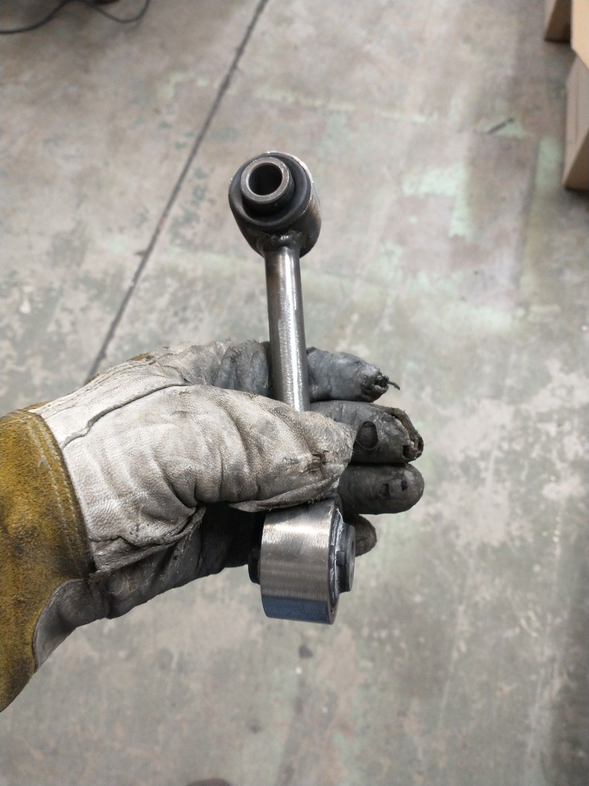

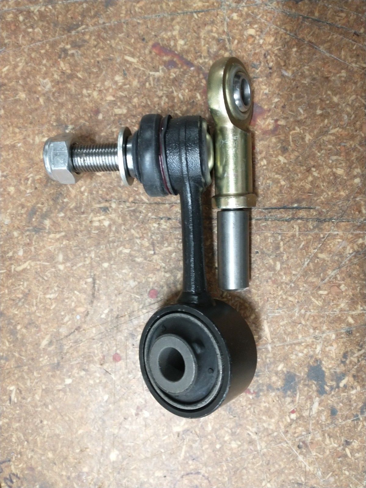

The niche is easily filled if the interest is there. As some know the BDS version for the tundra were too long and hit the TR. I'm trying to find an actual sealed ball joint for the one end as I'm not a fan of heims. Waiting on one call back from a vendor on those. Finding a quality 14mm x 1.5 BJ is a PITA.... if that doesn't work, there is another option, but will increase costs about 25$ per link. Lastly the heim.
These will be approx. 1" longer than stock and with a 2:1 motion rate they should be fine and will serve most up to a 3" lift without hitting the TR.
The rear is an easy extension and plate., but the main interest is for the fronts.

Hey Jason, do the fronts improve the angle with the KDSS relo kit or is it still tweaked?
