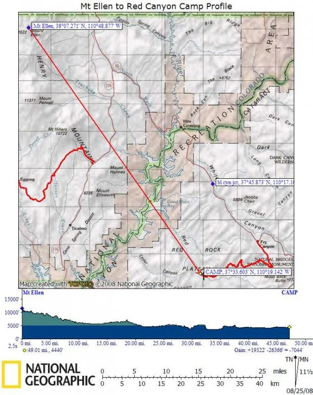

Real live example for those of you not familiar with HAM.
I was in Utah a few weeks ago. I went there for a little R'nR that was NOT supposed to involve any wheeling. Ya ... right. No tools, no spare parts, no recovery gear, just camping stuff. I ended up in a remote canyon 24 miles from the main road, with no town even close (Hanksville?). After I made camp I tuned in the repeater on Mt. Ellen in the Henry Mountains. I'll be dang, I was able to contact the repeater which turned out to be 47 miles away. This repeater is part of a larger linked system that covers a good chunk of E. Utah all the way to Provo and SLC. The result? Even though cell phones were worthless, I had contact with the outside world with the HAM. HAM radio offers a degree of confidence when camping solo that you can't get with other forms of communication ... except for maybe satellite phones. And in a pinch, it is possible to use satellites for HAM too, though I know nothing about it.

The result? Even though cell phones were worthless, I had contact with the outside world with the HAM. HAM radio offers a degree of confidence when camping solo that you can't get with other forms of communication.
