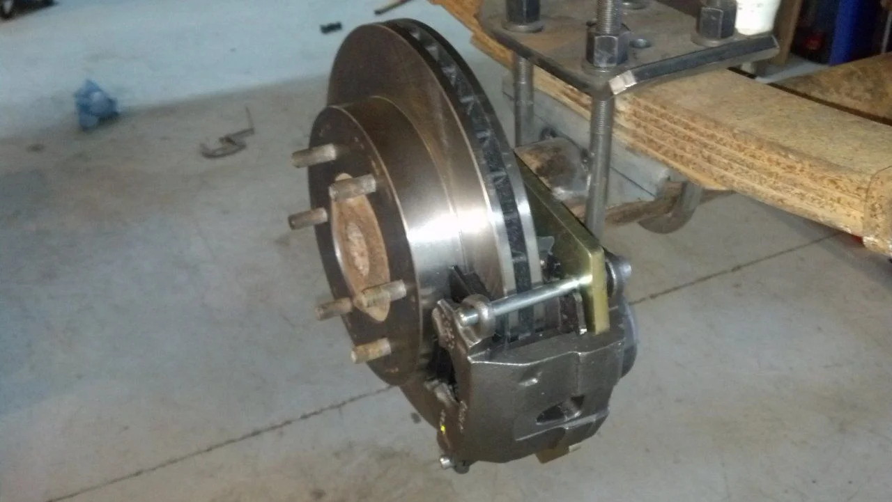

Got the rear disc brake conversion all mocked up. Good news is that a 15" rim will clear every thing.
For anybody out there running a disc brake conversion on your 60, what type of brake booster are you running? Will the stock one work or do you have to go with a twin type of set up or a proportioning valve? I may not have enough room for the stock booster due to the 4BD1t motor taking up some room with the turbo in that area. Any suggestions would be greatly appreciated.

You can always go with a Hydro-boost system. many have used them from Chevy Astro vans.
They are small and have good feel, or so they say? Flcruiser and few other here on mud have them in their 60's with Isuzu's.
I bought one for my swap at pick-a-part for $40, but sold it after I did not need to use it on my swap.

I've got hydroboost and like it a lot. Hydroboost is easy and cheap!
Do the 4BD1Ts have a factory vacuum pump? The 4BT does not, so it was natural for me to go with hydroboost as opposed to using my factory vacuum booster.

Thanks Doug, I will look into this when the time comes to start the finish plumbing on this beast.
Johnny, from what I can remember I think that they do. I haven't done much to the motor in awhile and I think that the factory alt has a connection on the back for vacuum pump. I'll check later on this afternoon.
The Isuzu has a vac pump stock on the the rear of the alt. It works well with the 60 brake booster, as the pump has more vacuum and it is steady, so the brakes work better than stock with the 2f.
But, if you have no room for the booster, hydro-boost is a good way to go.
Doug
