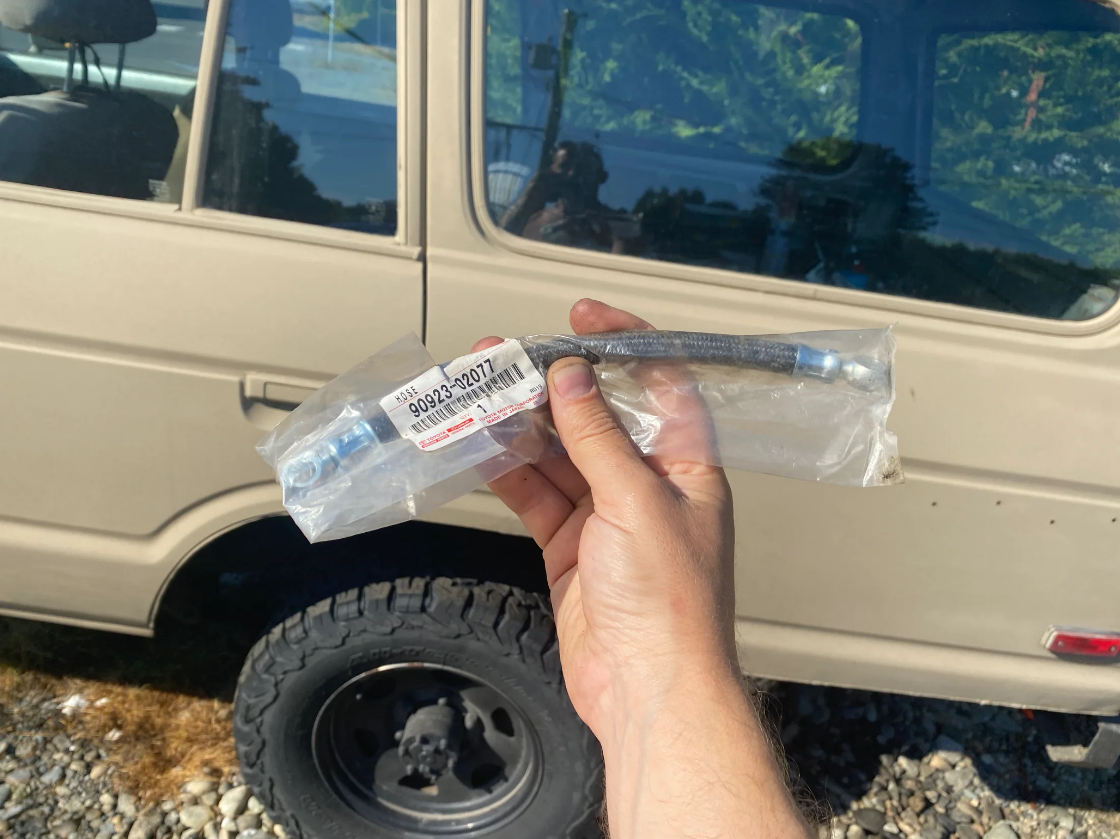

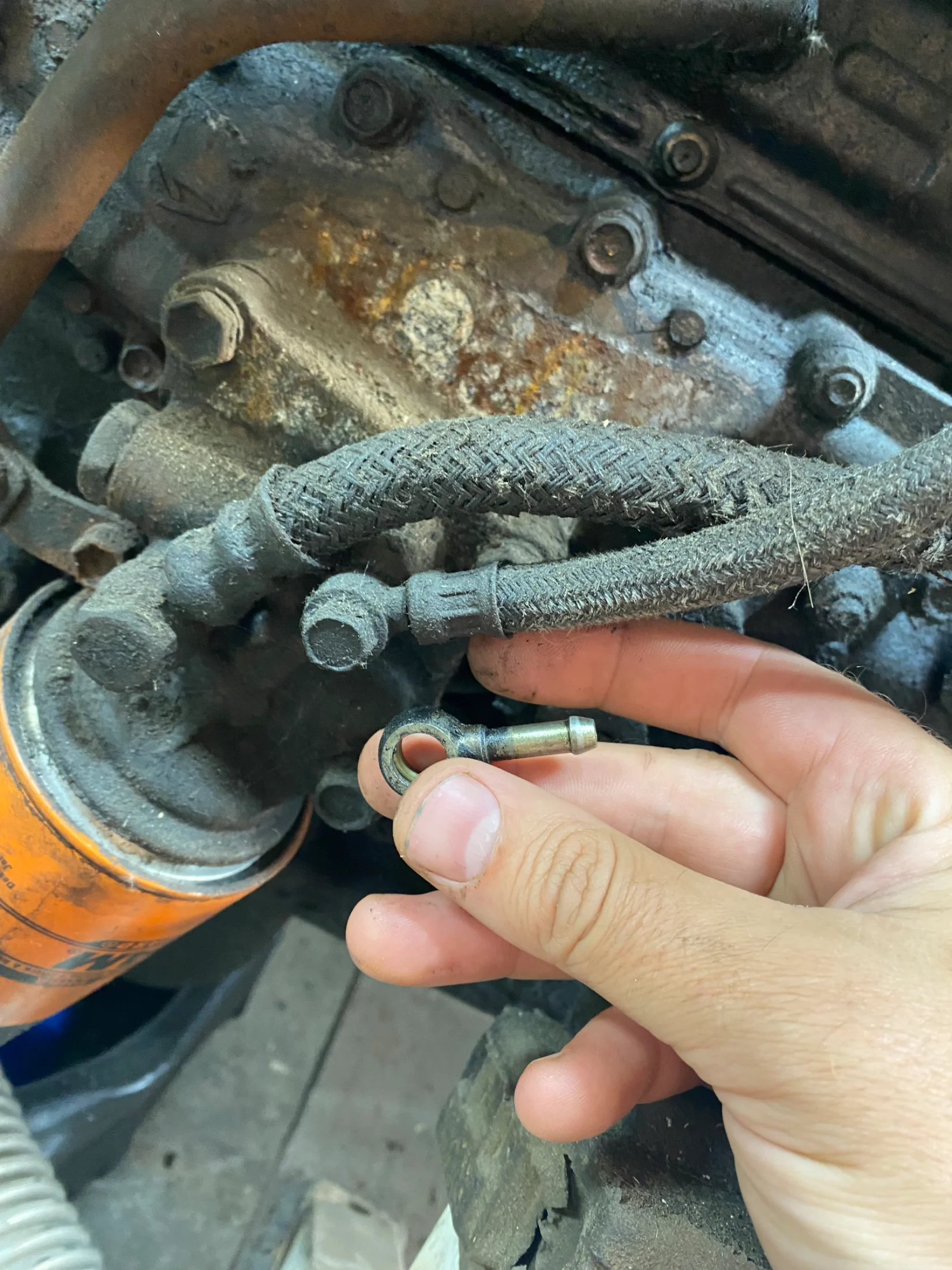

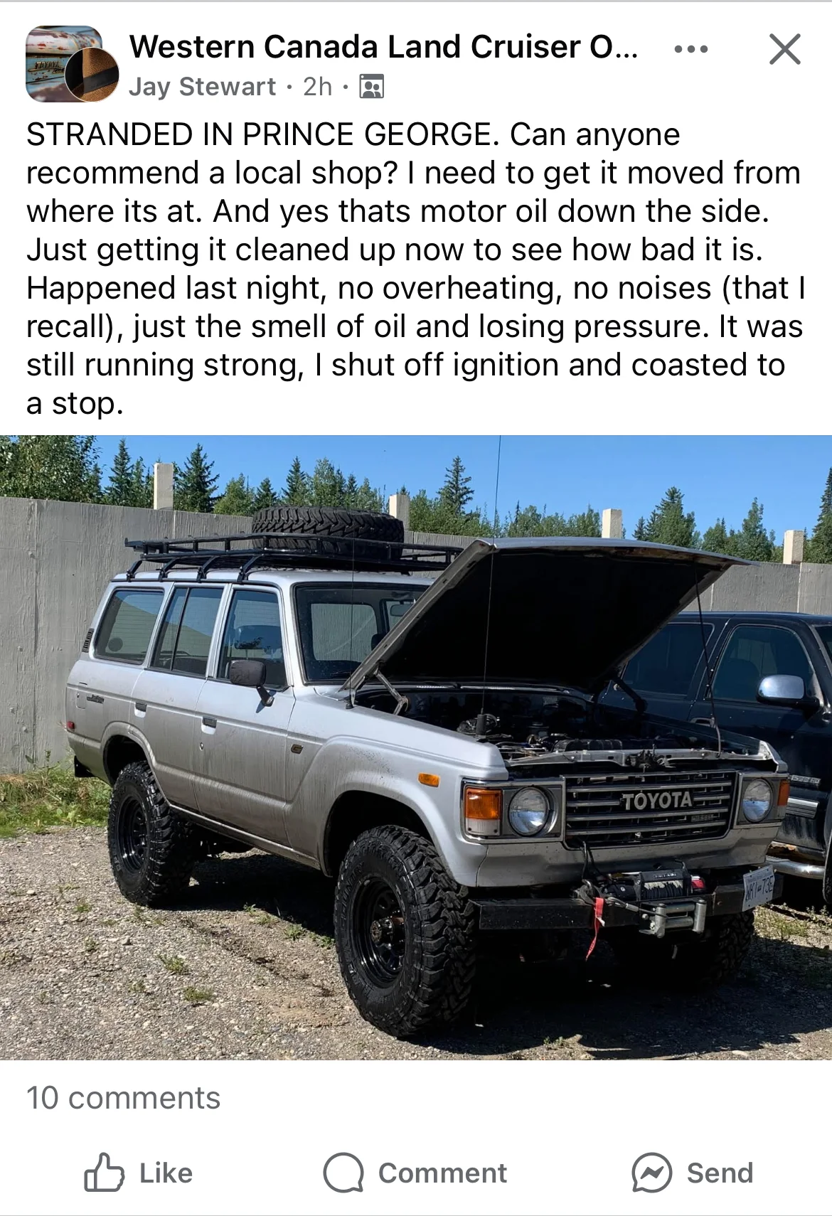

Stranded in Prince George…

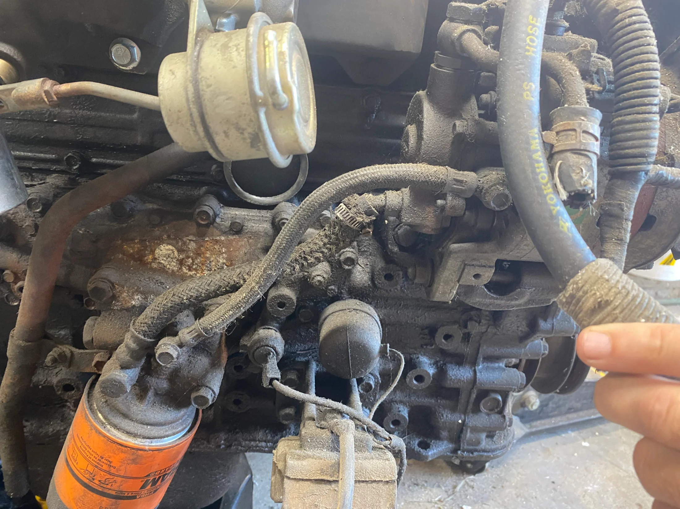

Had the same happen to me 100 years ago. Rupture in the oil pressure line to the vacuum pump on the back of the alternator. oil inlet hose 90923-02072
Only other possibility is an oil feed to a turbo.
Just like this.
Between the two of us we could jimmy rig anything!
Haha dude I once carved brush holders for a Perkins diesel starter out of wood, and glued the bars of the commutator in with epoxy and soft top vinyl,..
Spread the word, after the apocalypse you want a haywire motherfucker like me in your compound 🤣🤣🤣
I would love to help this dude out but I just got home an hour ago and heading out again in the morning. I don't get anything done at shops so not even any help there. The only guy I know that I would trust with my junk likely has at least a 2 week wait but he could try Wayne at Competition Automotive. I don't do FB so somebody will have to pass this info on.
Passed the info along.
