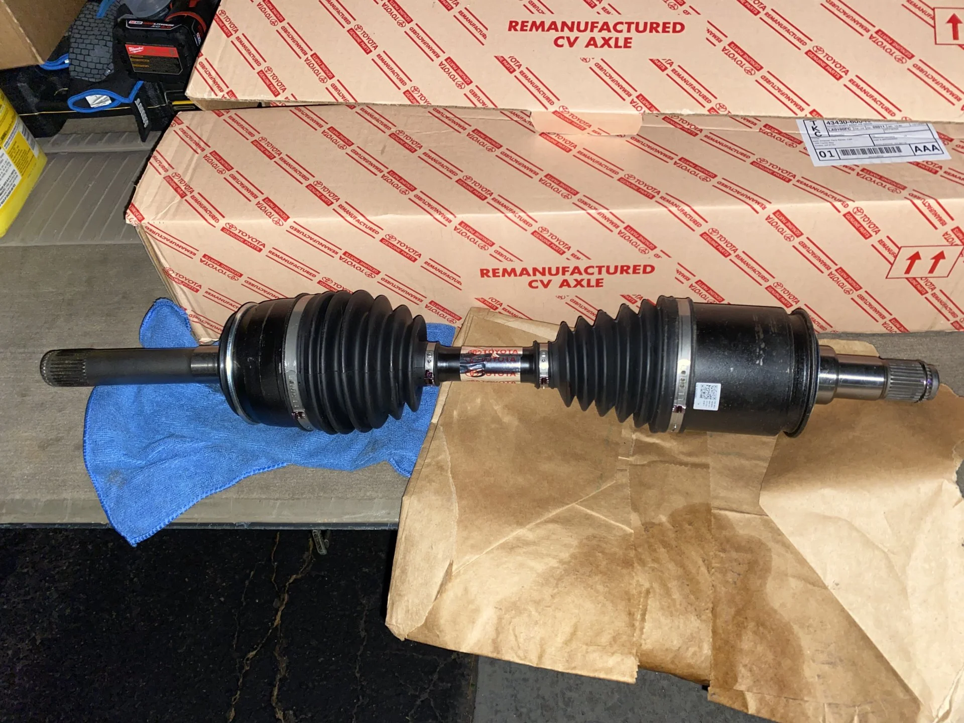

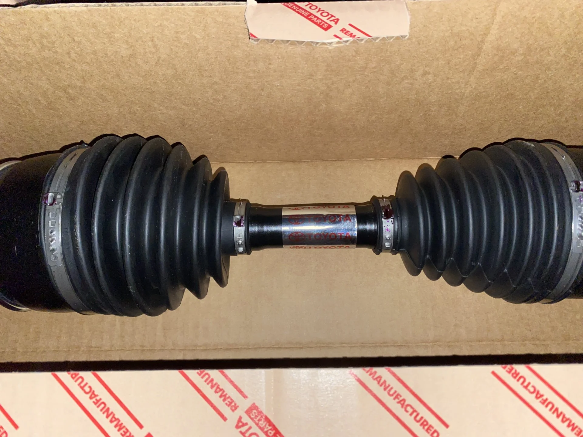

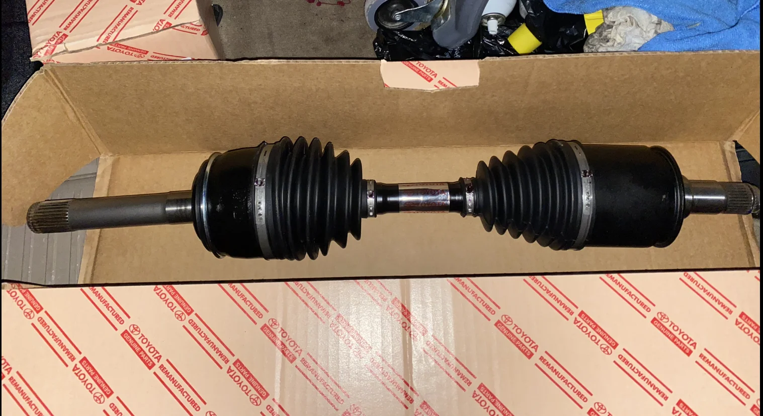

Mine arrived last Sunday after a 30 day wait. Here are pictures…

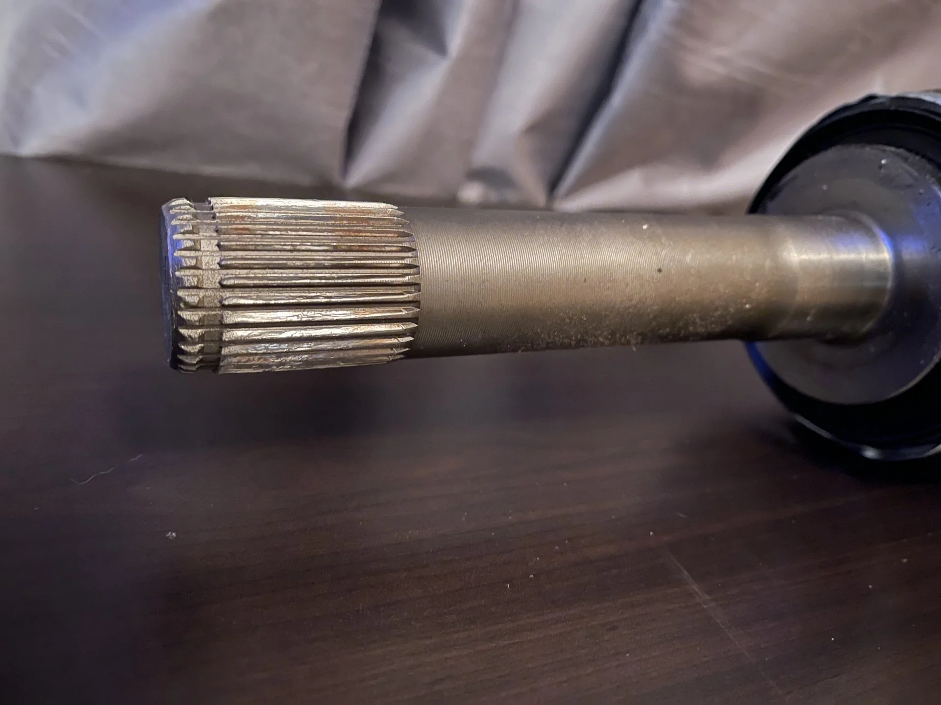

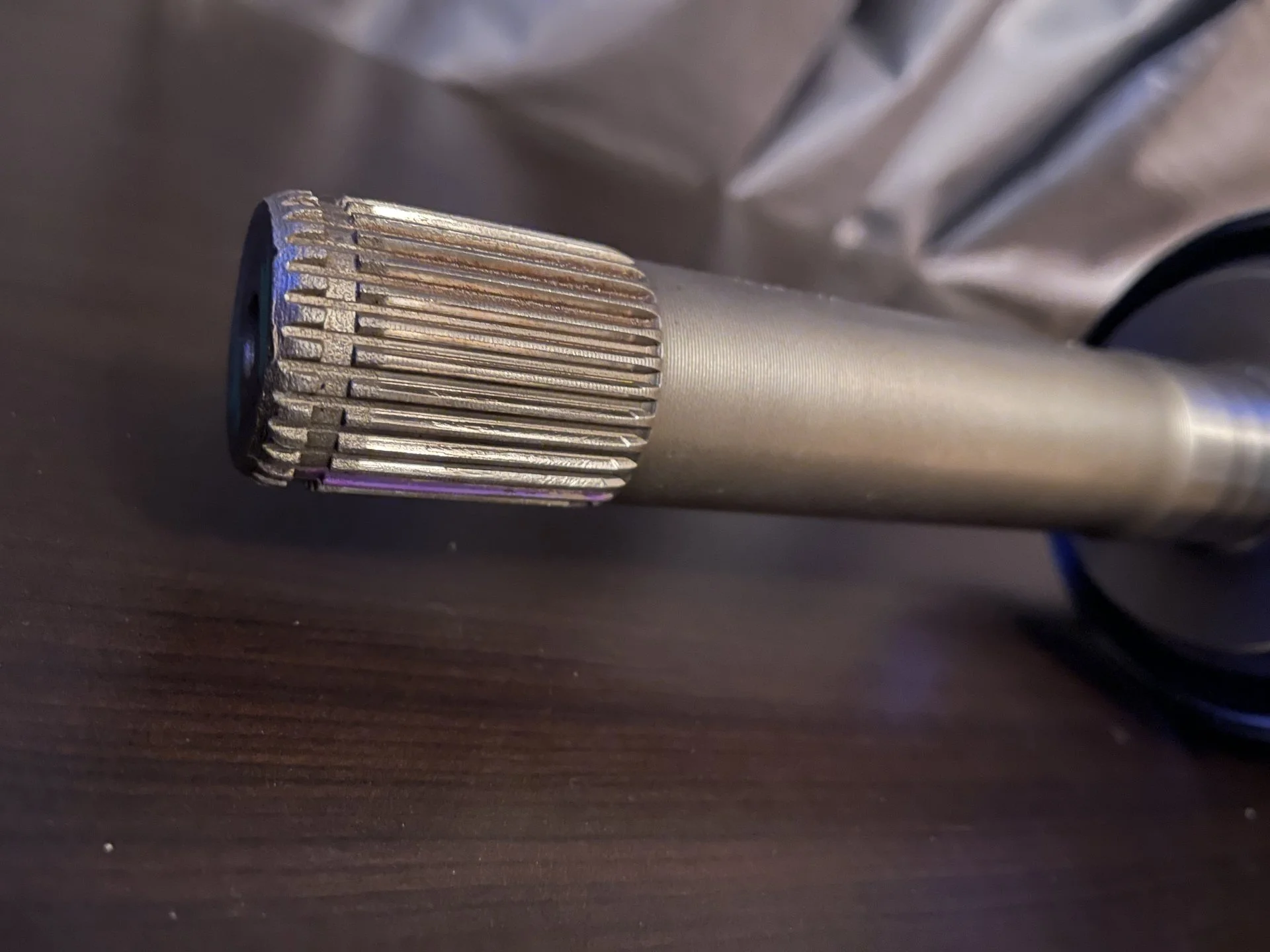

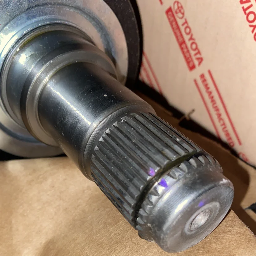

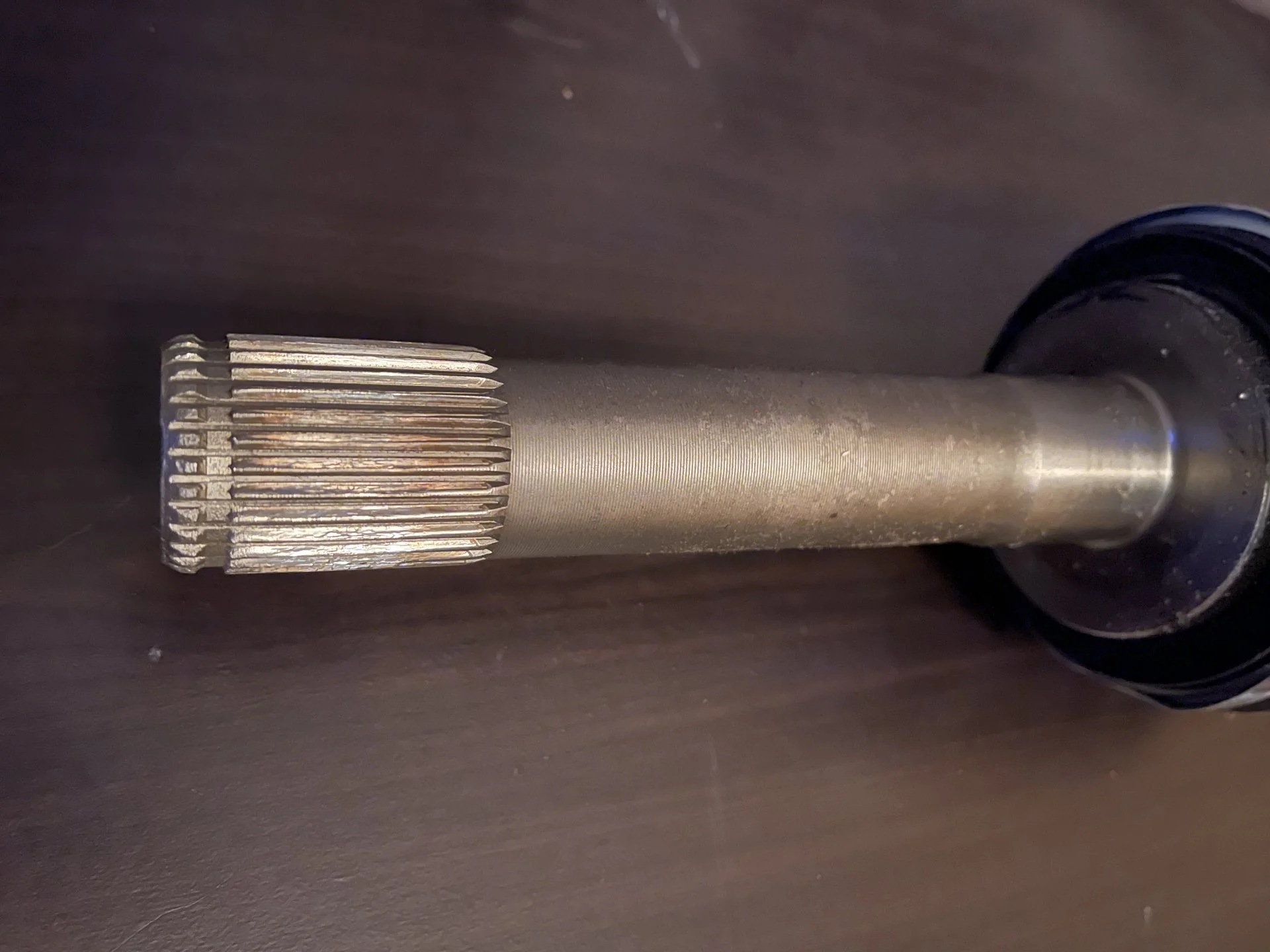

Can you post a photo of the outboard splines, similar to the one you posted of the inboard splines, please?
Here you go…. I noticed the outboard splines on both were digging into the cardboard box when I first opened them. Due to that there is a little cardboard dust still on the splines in the one picture. They are in fine shape IMO.

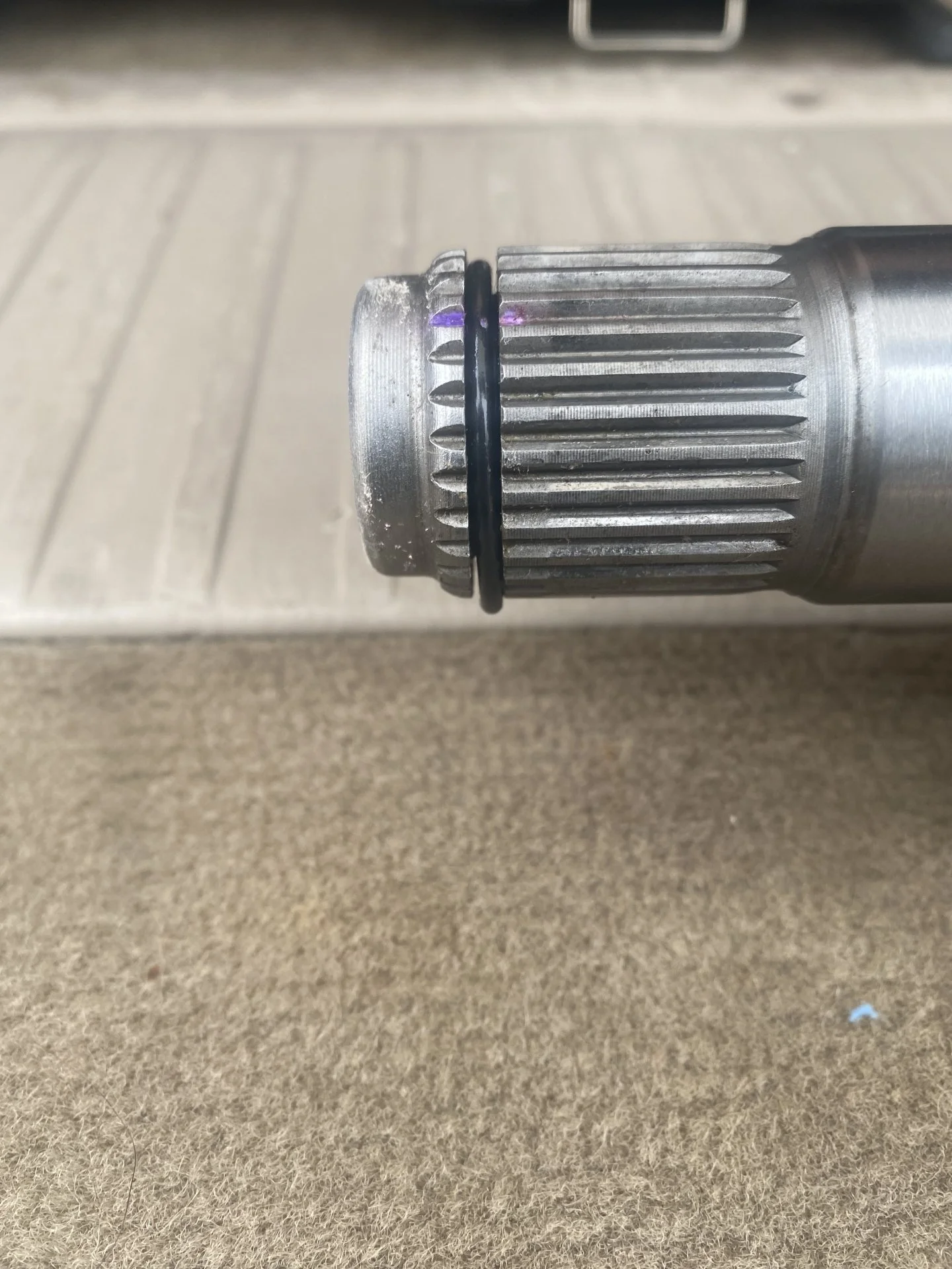

Did they not come with the retaining clip for the inboard spline end?
Thanks but can you get a photo that’s focused on the splines instead of the towel? Tough to tell in that pic, but the splines look worn and peaked to me, suggesting that their definition of reman = reboot + regrease only.

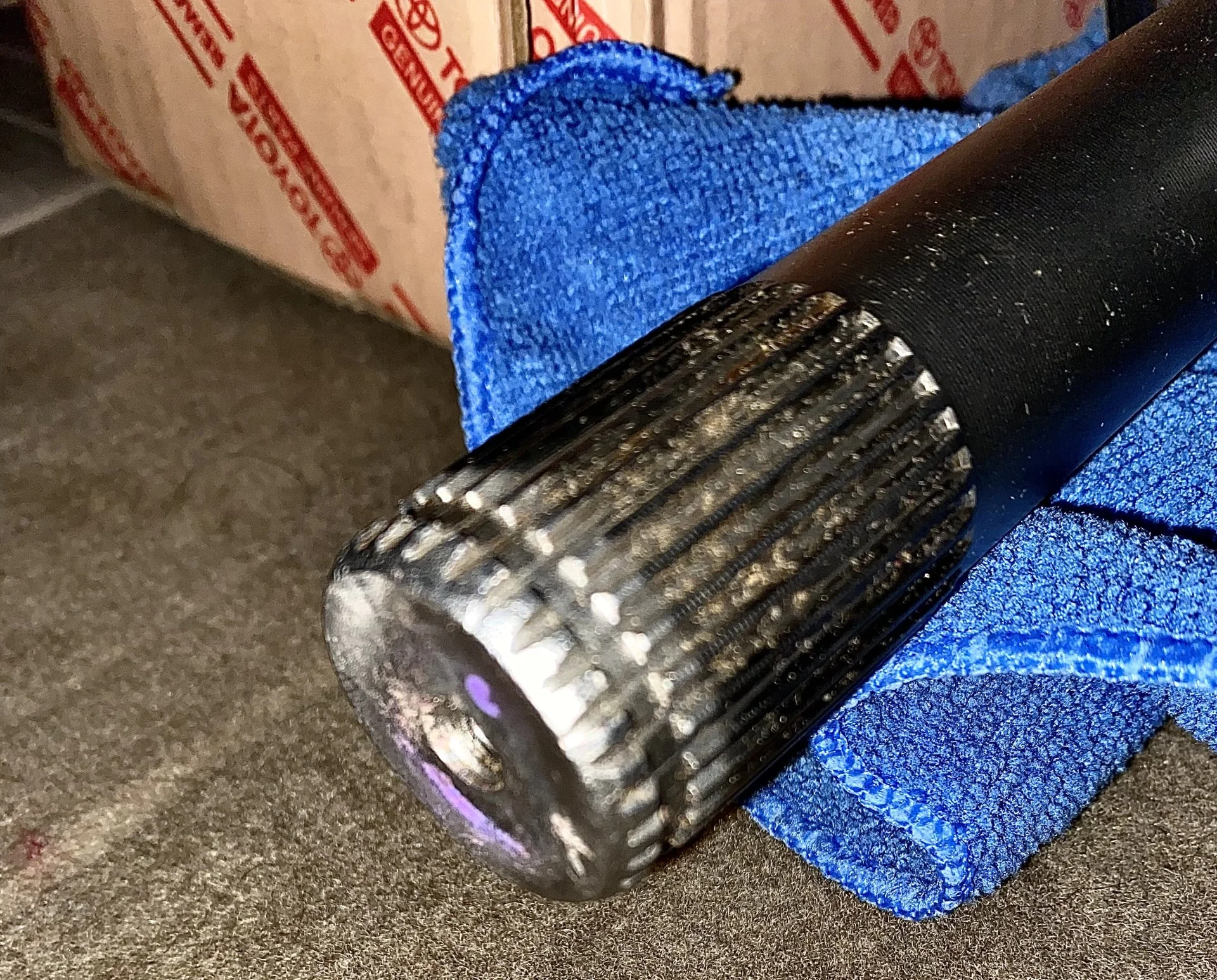

Yes, but they are out in the garage for the night. I noticed the outboard splines on both were digging into the cardboard box when I first opened them. Due to that there is a little cardboard still on the splines in the one picture. They are in fine shape IMO.
its on there

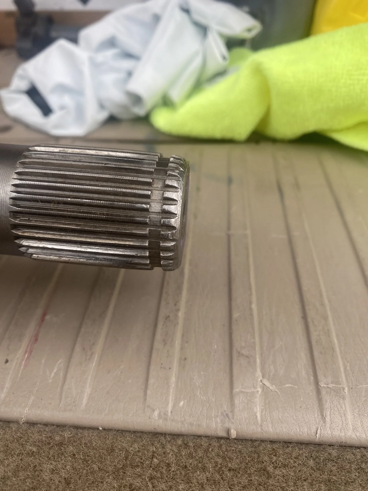

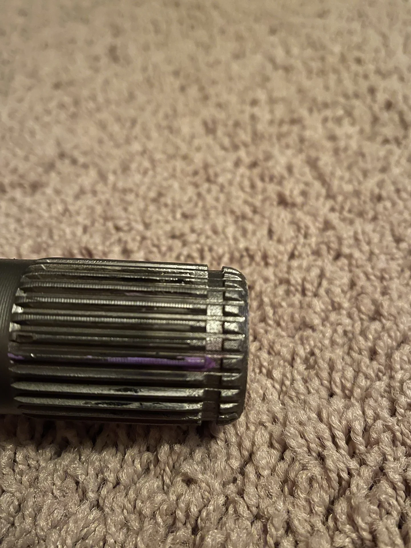

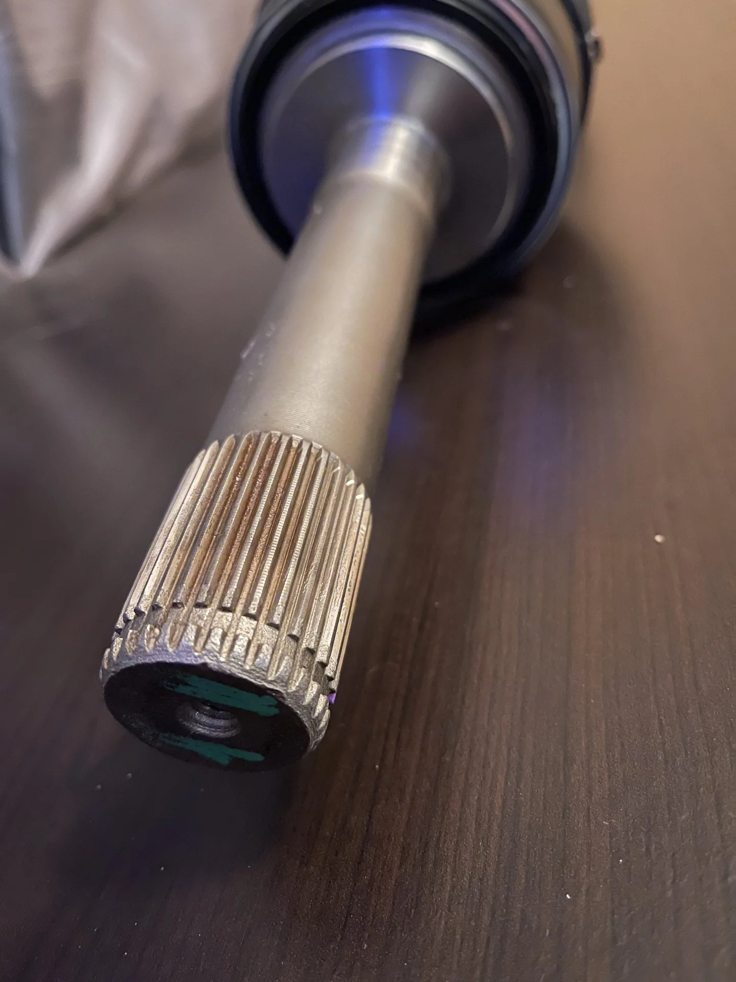

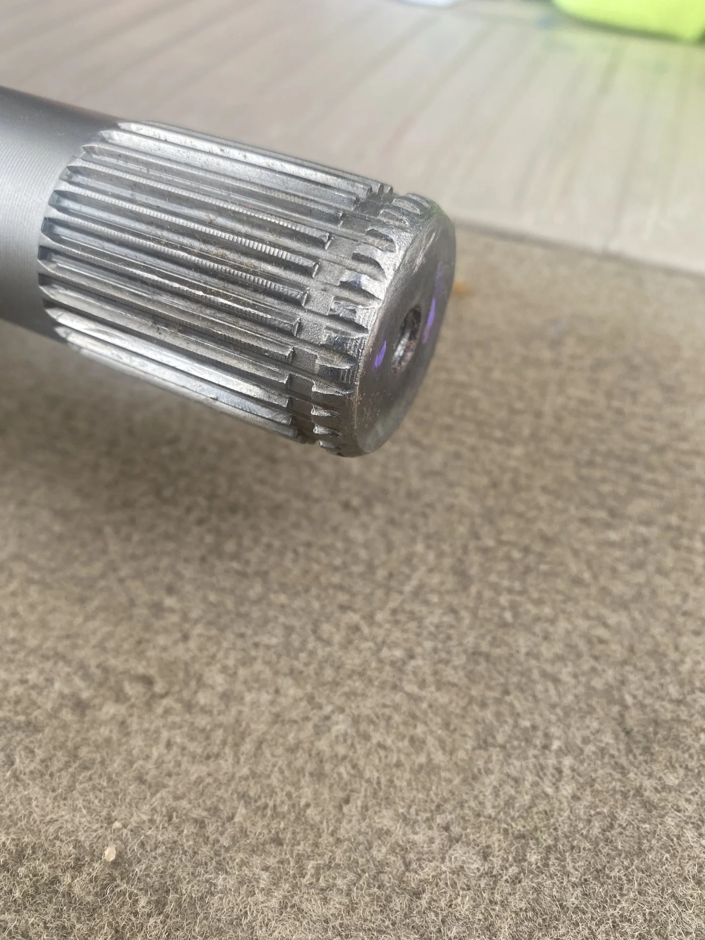

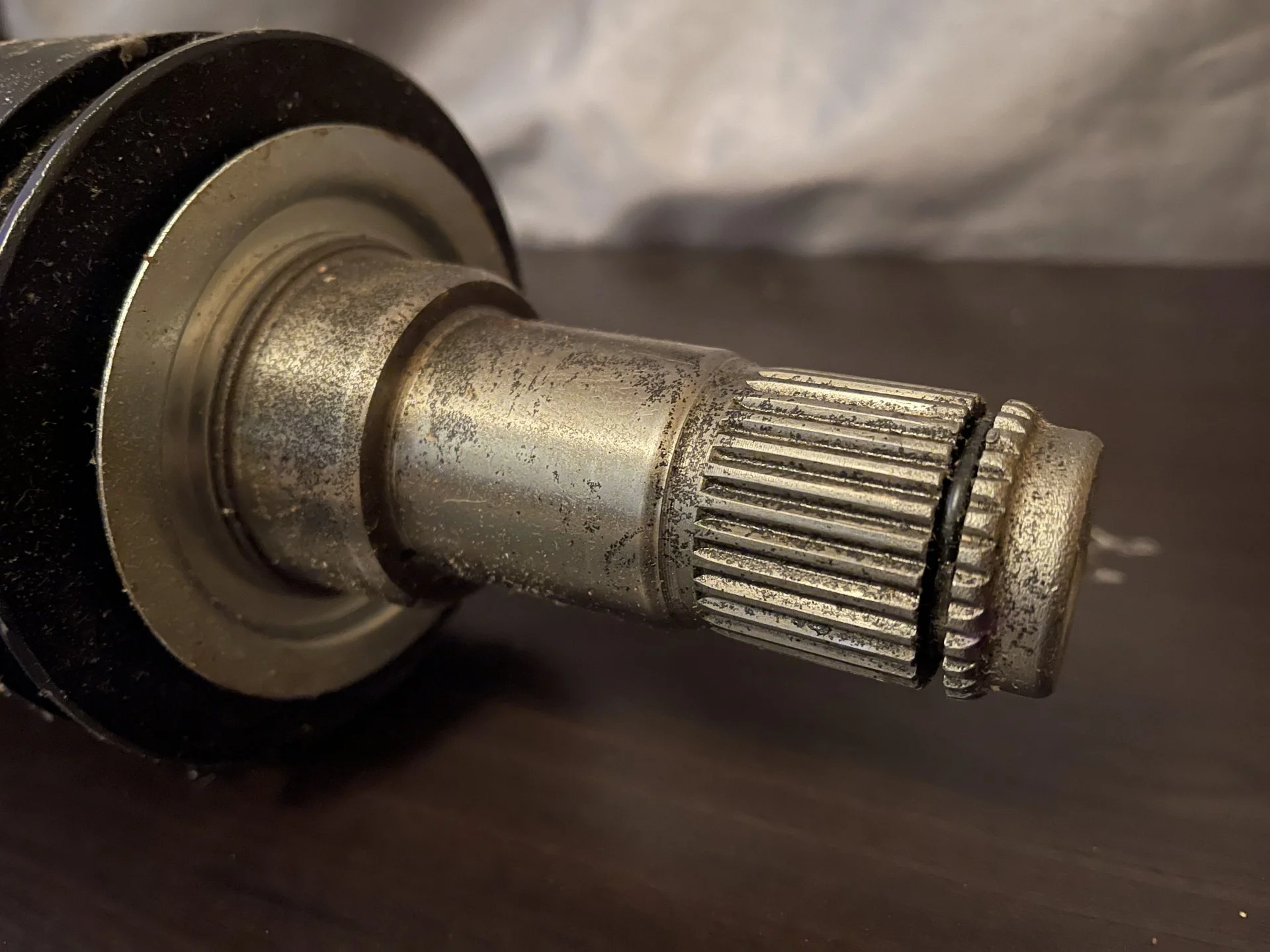

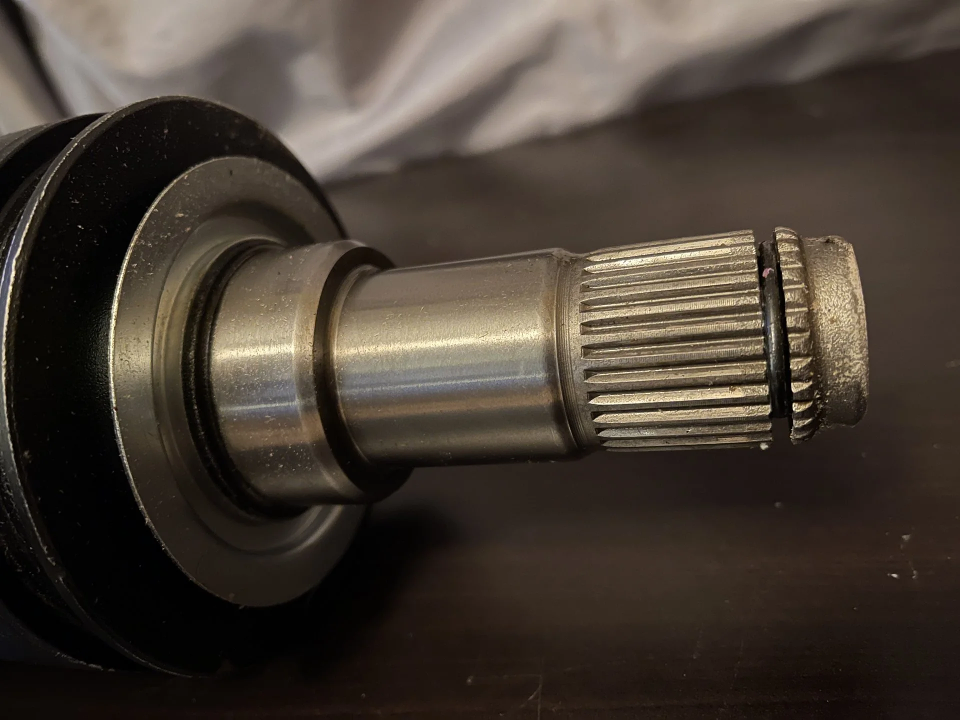

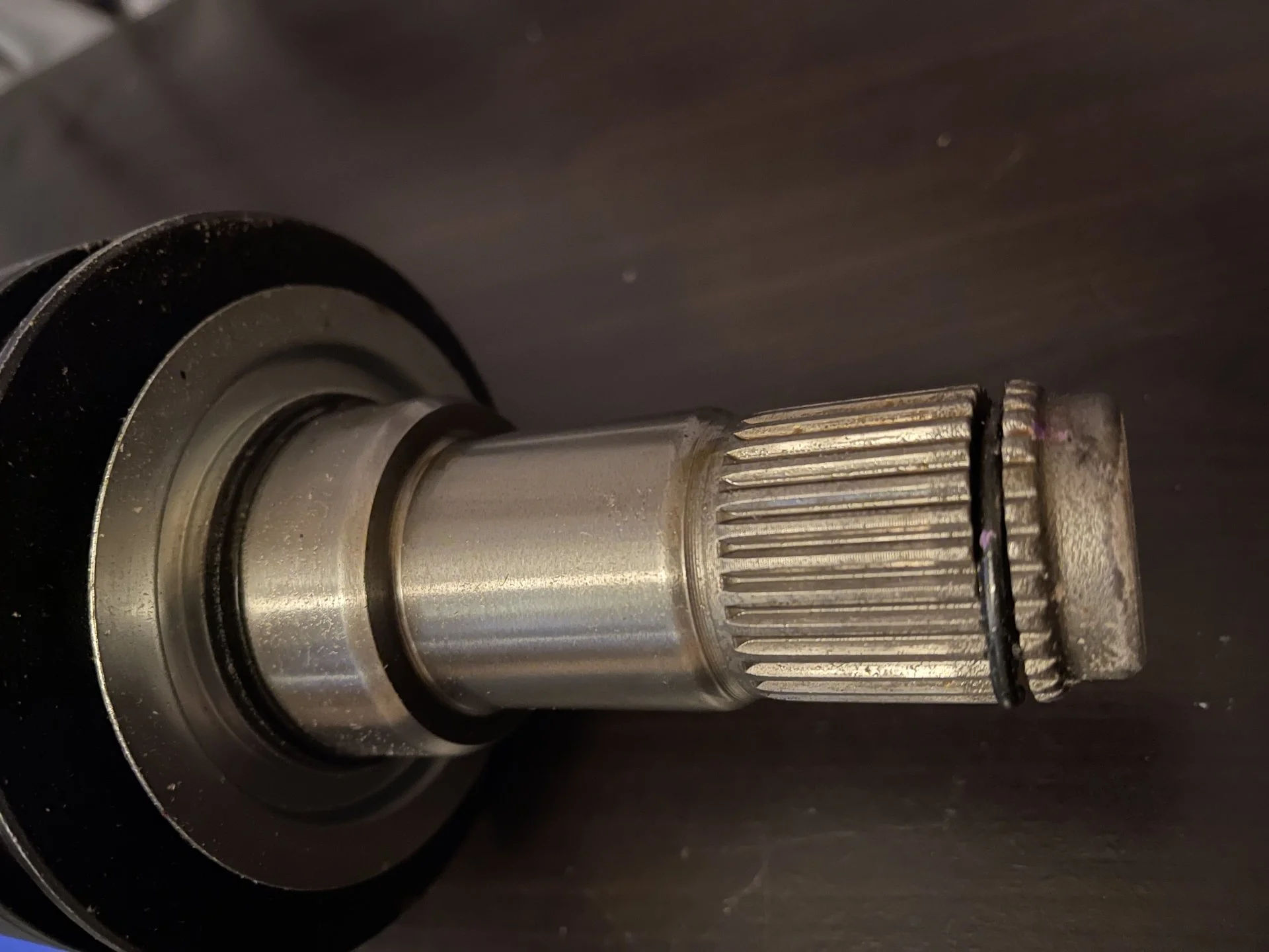

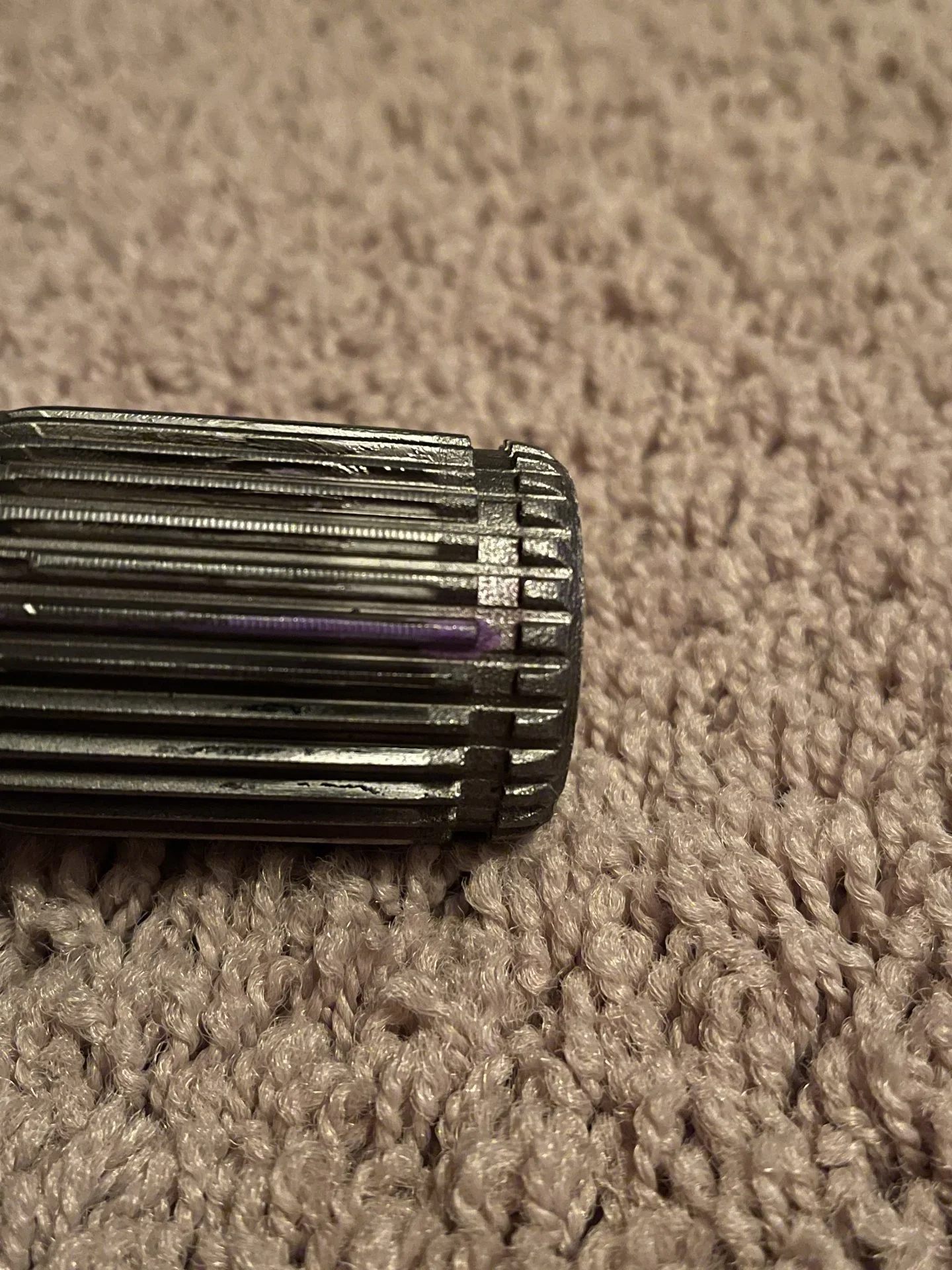

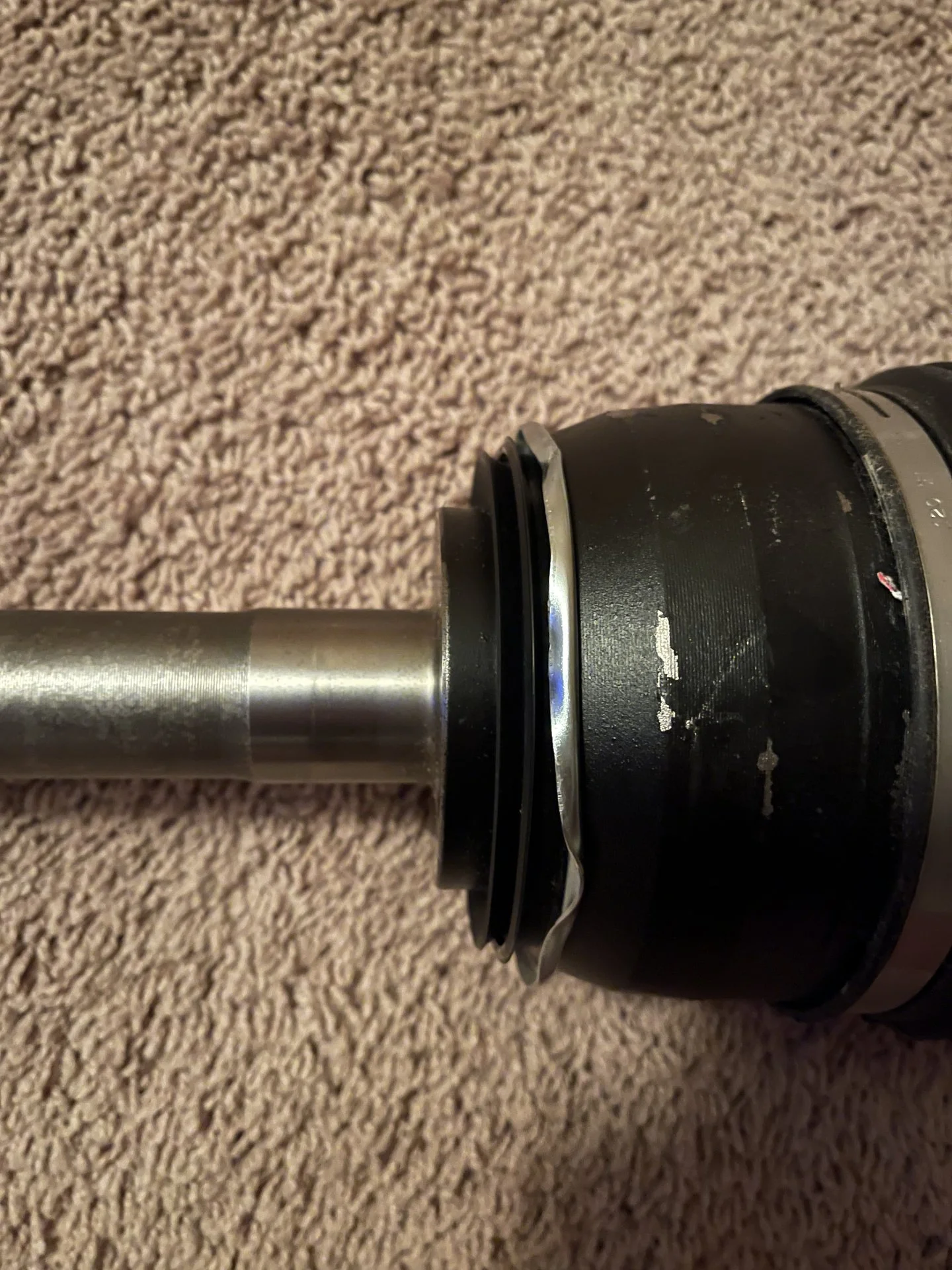

So mine just arrived and here are pictures of each one:
Axle #1
Axle #2
Awesome pics, thanks. Those outboard splines are visibly worn. Inboard looks good to me. Outboard is marginal - terrible in terms of a "new" axle, but for a fraction the price of new OEM, maybe it's acceptable. I wouldn't be afraid to install that, but I wouldn't count on it lasting more than 3-5 years of normal use. Be very cautious with getting a good snap ring and fitting it properly.
Awesome pics. Thank you.

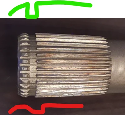

Axle #1: That's not good. significant wear on the snap ring edge (the ONLY thing holding the axle to the hub). Spline wear is awful. I would not install that and I'd return it. That would be a waste of time to install.
Axle #2: That's atrocious. You can't even install that. The snap ring won't hold the axle in. I bet that's an axle from a catastrophic failure. It should have been trashed. That is a disgrace. Do not install that. This is a great example of why accountants shouldn't run parts decisions. I doubt an engineer was involved in the inspection process for these "remans" if that's what they're allowing. One of the core critical features of the assembly is blatantly ruined. The spline wear is also terrible and I expect you'd feel tons of slop with total failure just around the corner.
Graphic below showing what the snap ring edge should be (green) vs what it is (red).

Agreed. I can't use one of them anyways because of the damage sustained during shipping...
However, are you sure we should write of this axle? I believe #1.
My passenger side one is definitely failing and can't be worse off than this one...
The pictures of those outer axle stubs look pretty bad- I would have thought that reman would include a new outer stub, not one that’s been shot peened and rebooted. Fwiw liters wear much faster than inners-
