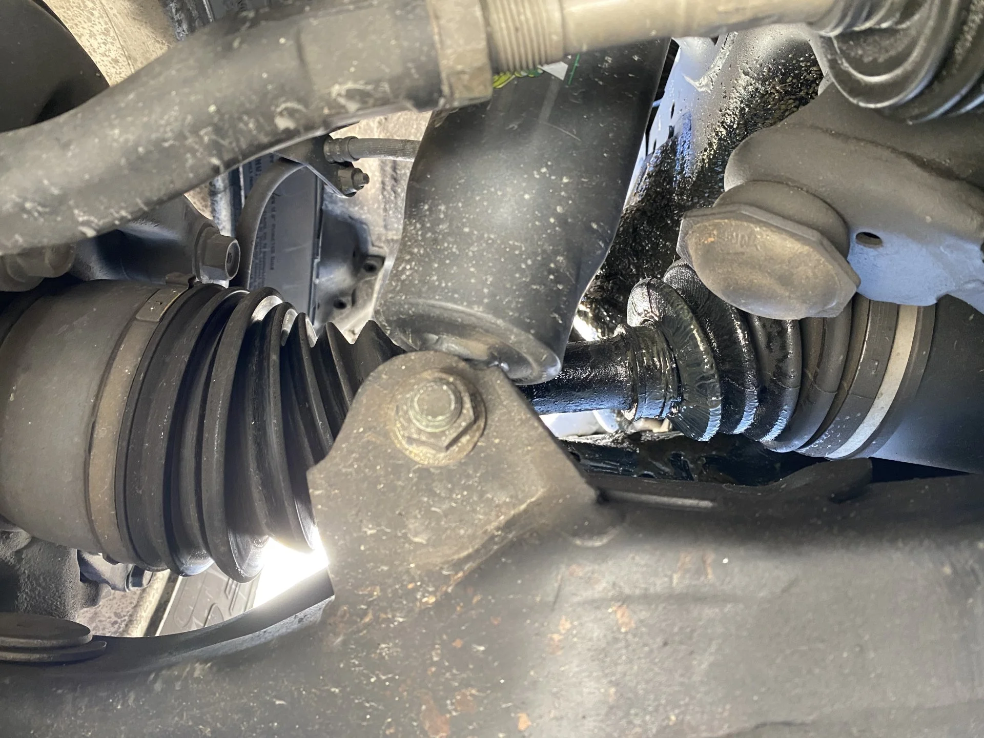

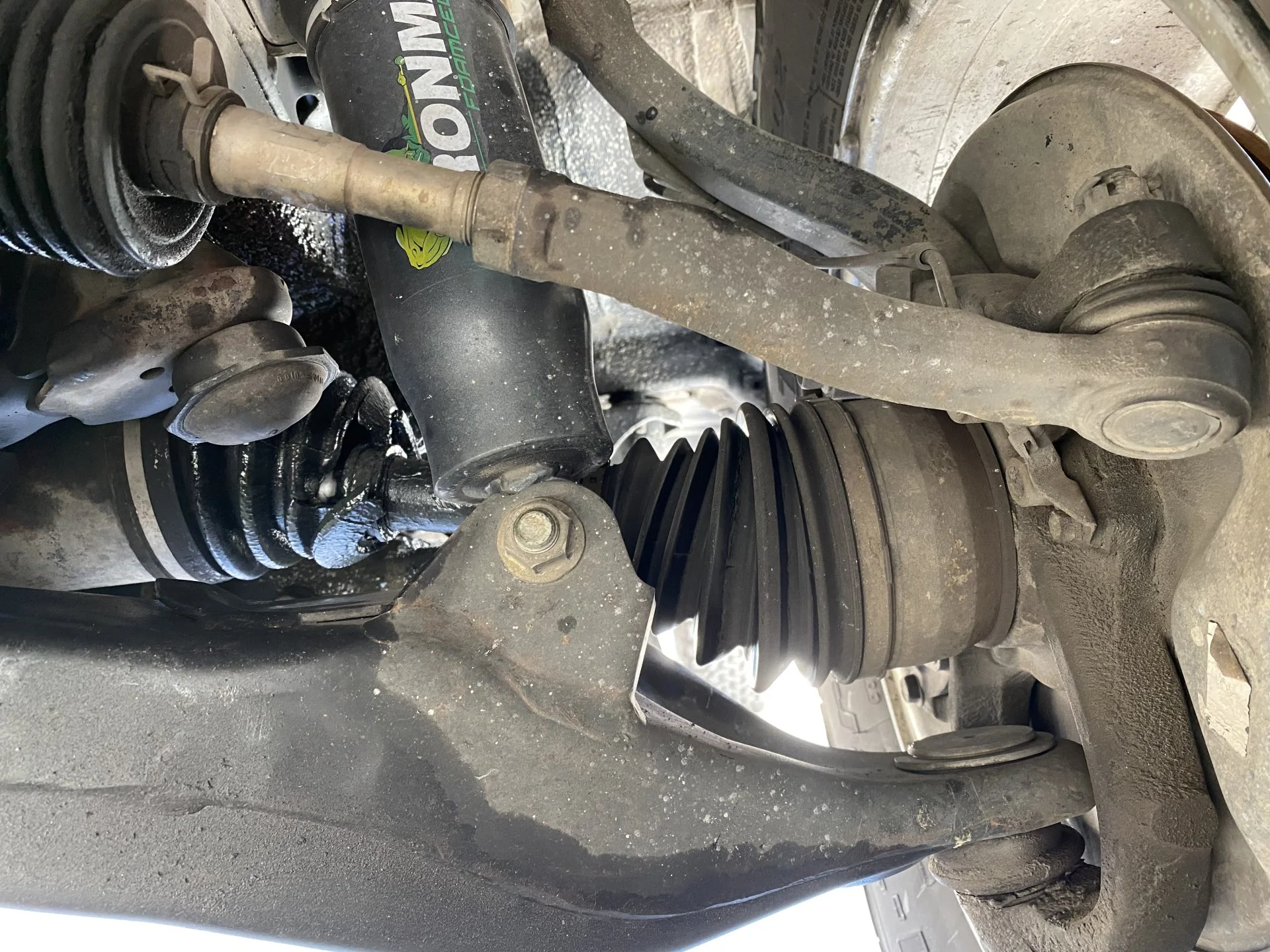

Anyone know the part number for inner boot kit? My outer boots seem to be in good shape but inner ones are torn.

Well this thread was a welcomed gut punch🫤. Tomorrow I will make arrangements to return my remanned CVs and order new. The only thing I can think of that could be a positive, is if Toyota is reusing parts from 100s that are part time 4wd. Those would have less wear on the outer splines, however there’s no way to know what you have. This is disappointing that Toyota would do something like this. Thanks for the heads up.
If your remanufactured CV's show low spline wear and the internal joints feel tight (at all angles), I'd just run them. The Toyota CV's are really robust. Most people don't want to spend $1200 on two axles for a vehicle that is worth $10k. So remanufactured is a good option to have. I trust it more than most aftermarket.
