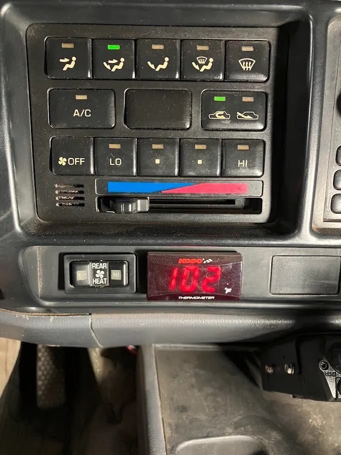

I now use a koso temp gauge to monitor real time engine temperatures.
Hey Broski thanks for the insight. Can you elaborate (ie, model, wiring, etc) on the Koso you are using? Temp is something that would be a minimum for me to look at real-time.
Our OBD1 forces us to cut the upper radiator hose and connect the temp sensor in between the cut hoses to get a temp reading. I used Trail Tech sensor because no wirings invoked but downside is it runs on CR232 battery that you can't get into. It last up to 4-5 yrs. Just buy another and plug it when its dead.
The Koso is available on ebay and 12 volt powered, I have it wired to power up when the the key is on.
I drilled and taped into the outlet pipe coming off the head for true temperature reading, One could try to get that pipe already drilled and taped from Wets' End 🤷‍♂️
Or do what @efjayatee did and cut the hose but that introduces two more places for a possible coolant leak.
The round flat spot on the out let pipe looks like it was made to put a sender there ;)I have been really happy with this set up !! and it looks like it belongs there.

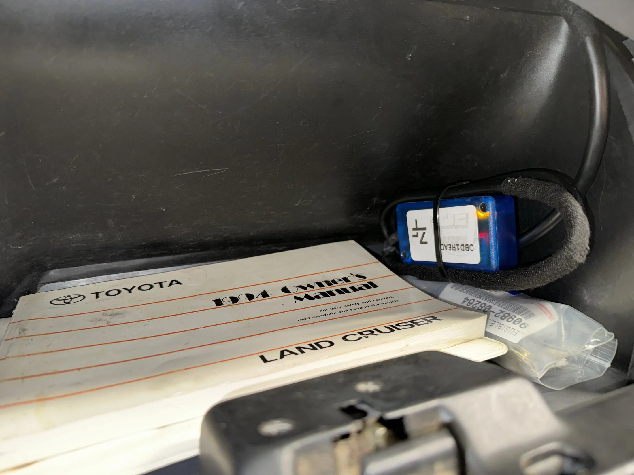

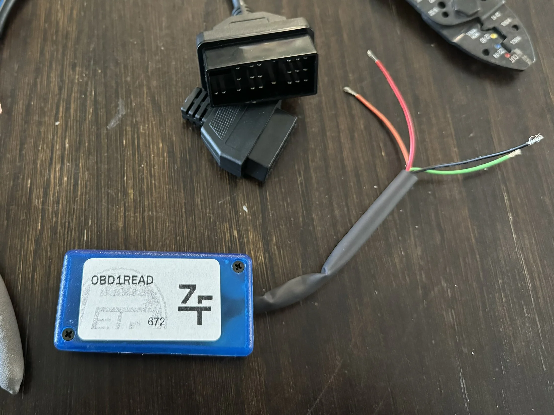

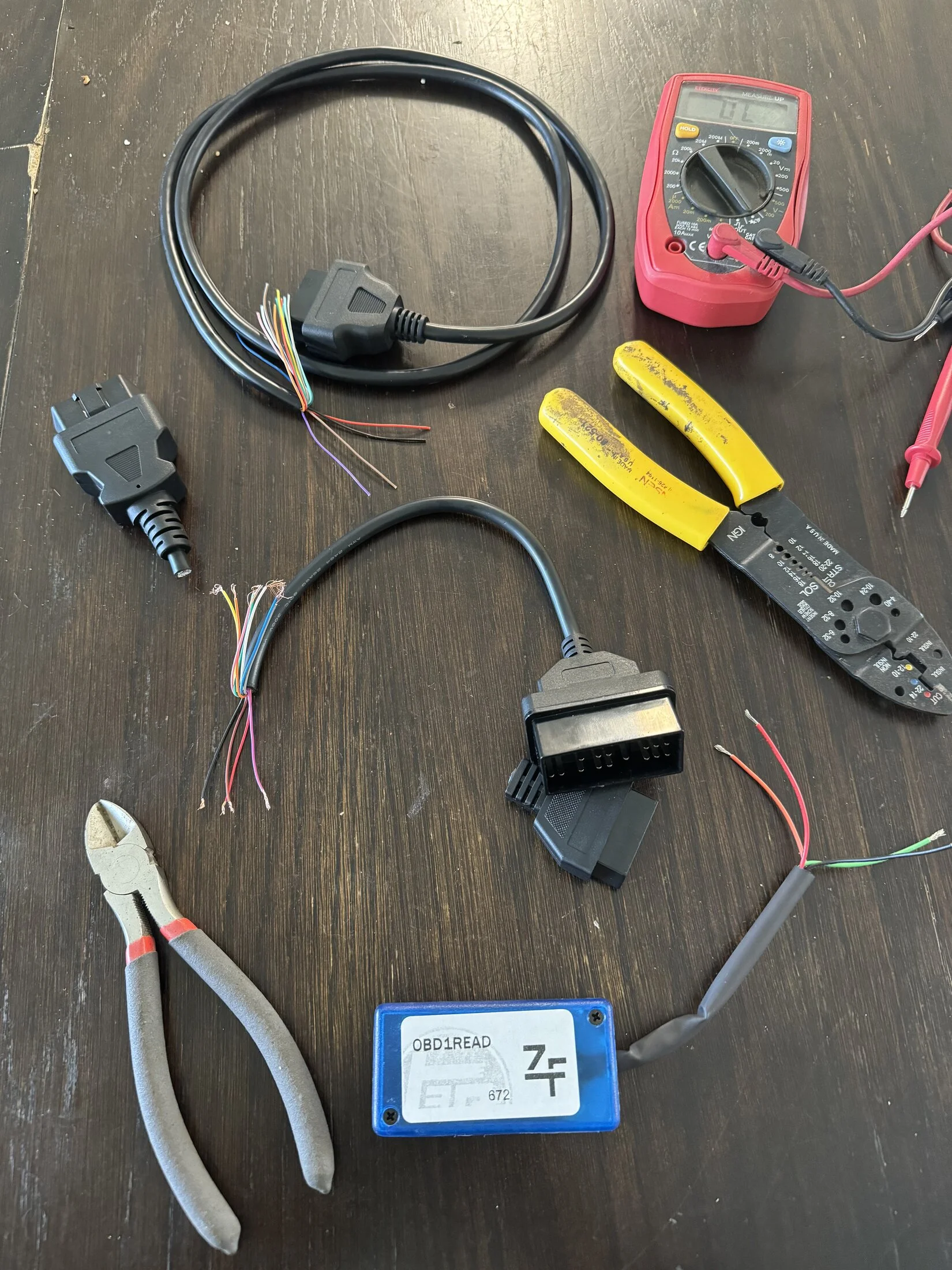

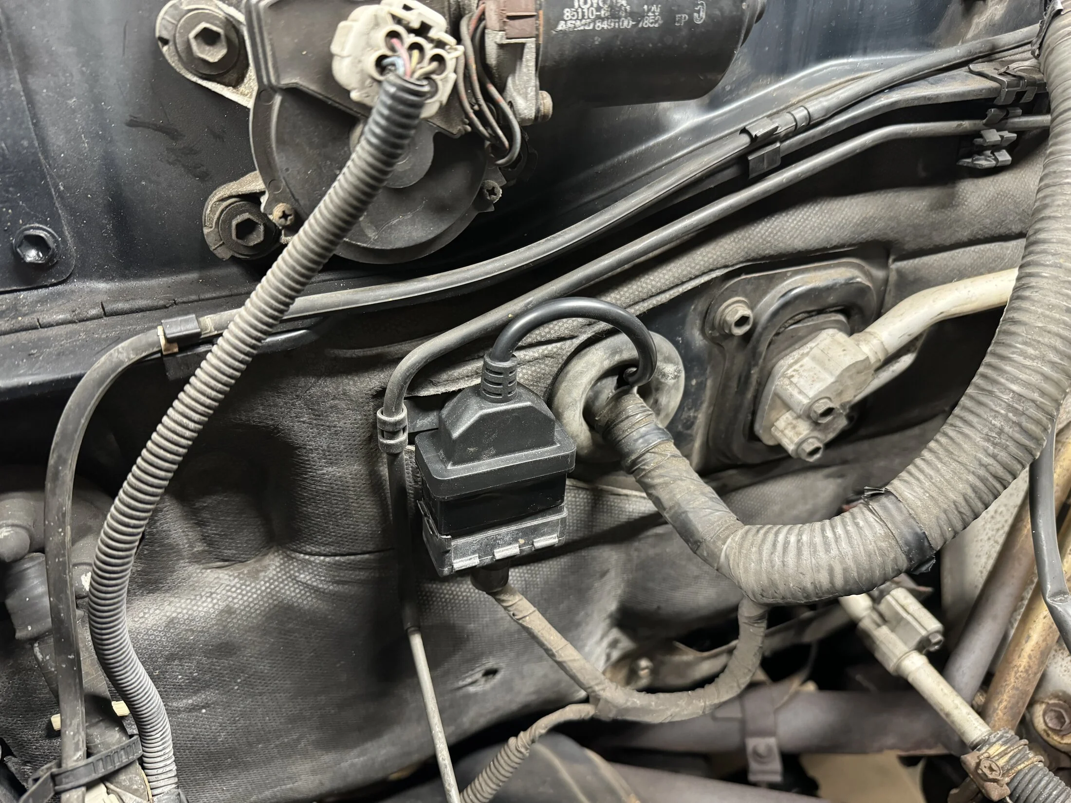

I read the posts about it not being made to use full time while driving so was curious if there was a solution to that. I had read somewhere that you could extend the cable so the unit could be inside. An $8 OBD2 extension cable and a $4 OBD1 to OBD2 adapter cable fixed that.
All the wire connections were soldered and vinyl shrink wrapped. Plugged the cable to the diagnostic port and ran the extended cable through the fire wall grommet of the main wire harness. Looks pretty clean.
I just wound up the excess wire and put in the glove box.
It could be ran to other areas inside, but I don’t think it gets too hot in there and I have good signal to the app on my mobile device. Not really sure what all the other readings are, as I mostly just wanted it to monitor engine temps and get check engine codes.
So we will see if this fixes the issue of it not being able to run full time while driving. I’m hoping it works out, but will report back if there are any meltdown issues with it inside the glovebox.
I got one from the maker from his last batch he made in June/July for my ‘94 Fzj80.
This is the only reason I’ve been holding off on getting this unit. Fear that the engine heat will melt it. Please post updates how this works out for you. Looks like a great job.
Very Pro.

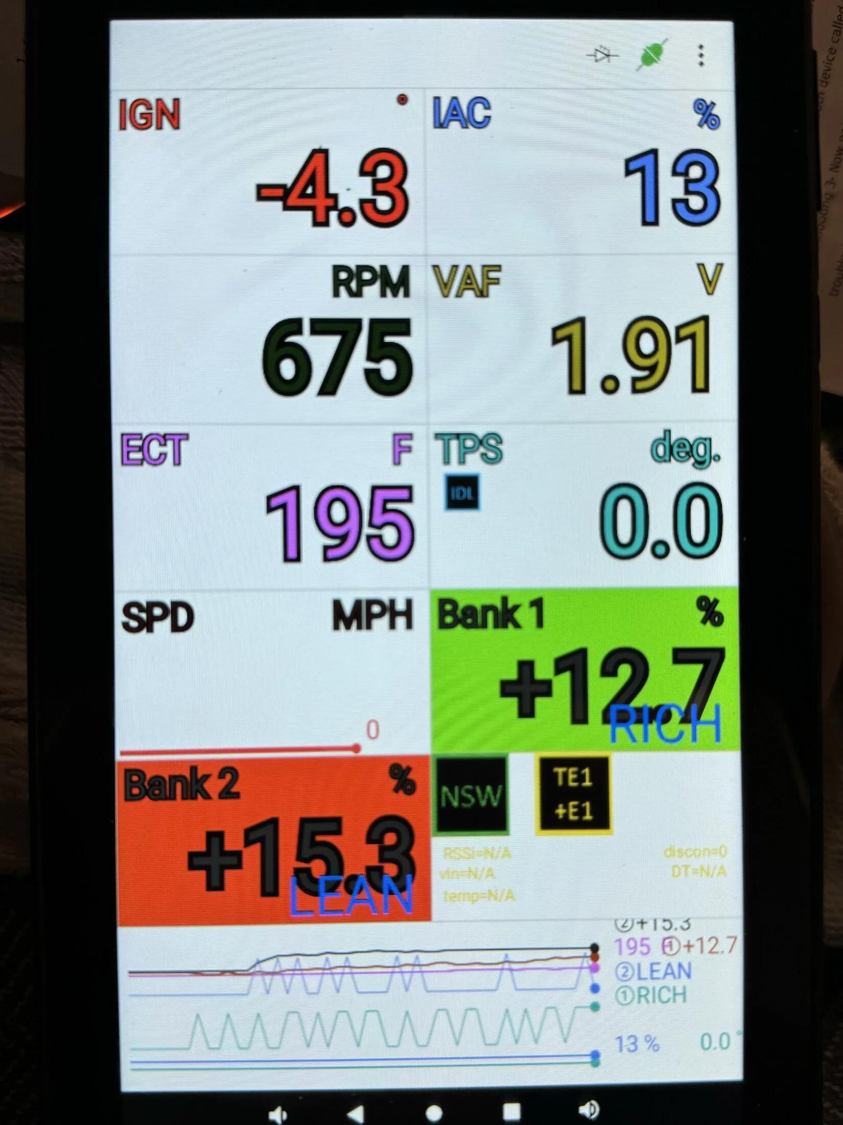

I've been running mine now with the same extension mod for several months...no issues so far. The only real reading that I care about is the ECT, so that is in giant numbers, even when I run split screen on my 7" tablet with OnX, Waze, Etc. Nice that it does have the overheat alarm that you can set too.
