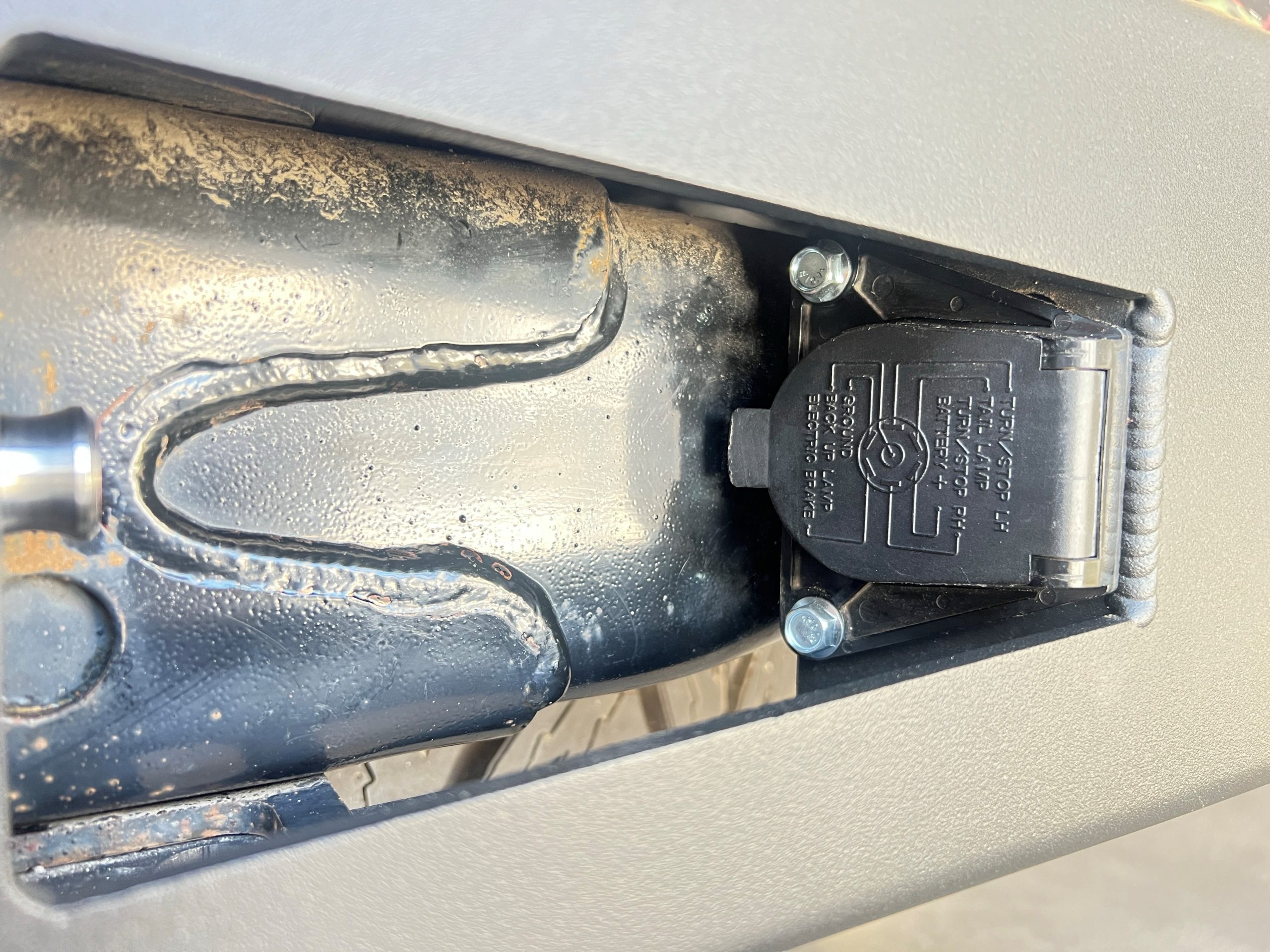

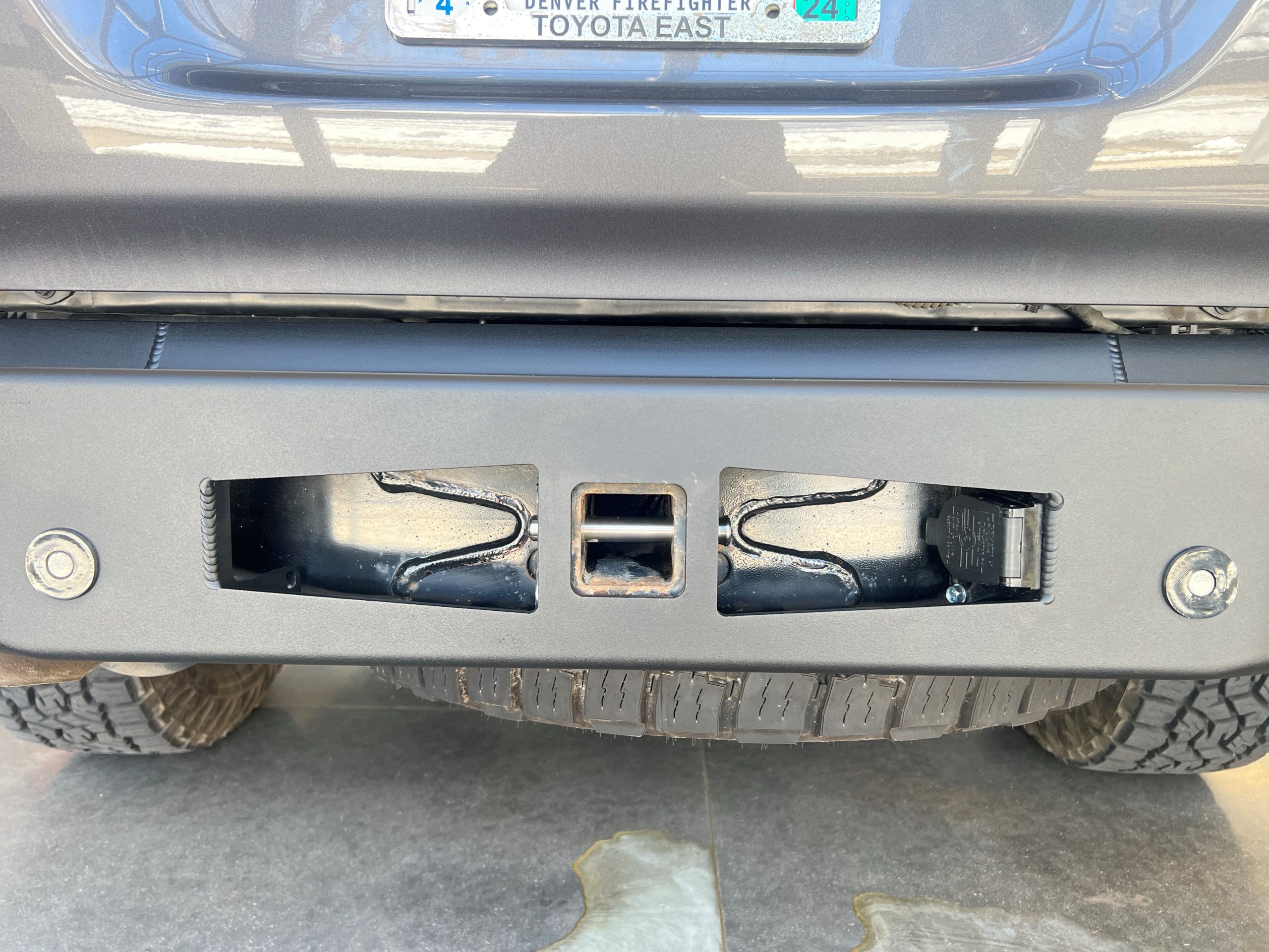

FWIW, the Aluminum non swingout design has been updated with more clearance for the pin and also the 7 pin mount.
That looks like a beauty!
Light, no rust, retains backup sensors, improved access to hitch and wiring connector. Literally everything I would personally want in a rear bumper. If I ever swap out my stock setup, I'll be making a trip to your shop!
The only wish-list item I could add would be a pre-drilled location near the wiring connector to pass-through wiring for more trailer-related connections, such as a DC/DC charger. But I suppose with an aluminium bumper that's an easy mod to make at home.
Great improvements! I also learned that this bumper is compatible with all LRA tank mounts. I have a 12.5 gallon which is a prefect pairing for the non swing out bumper.
On the side opposite the 7 pin we have a similar mounting flange that DIY'er can use for air brackets / Anderson plug connectors or anything else.
