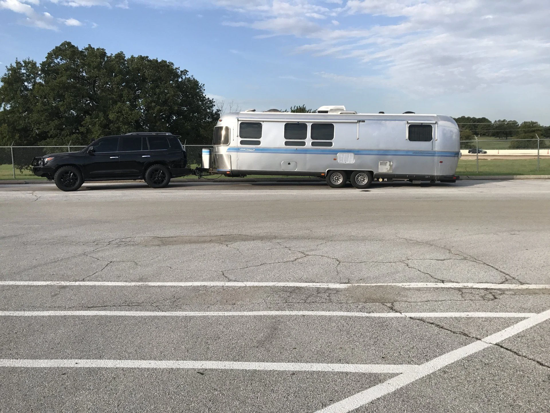

Hey, just stumbled on the towing convo. I'm pulling a 30' tt and have been pleased with towing performance. I just increased tire size to a 35" (34.5" actual). I tow in firm suspension setting which eliminates most bouncing/bucking from a short wheel base tv.
We're looking at getting a 34' triple axle soon. Thank science for forced induction.

Most awesome. Full armor and 35s, AND a 30' trailer.

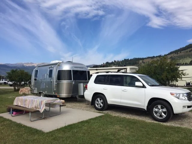

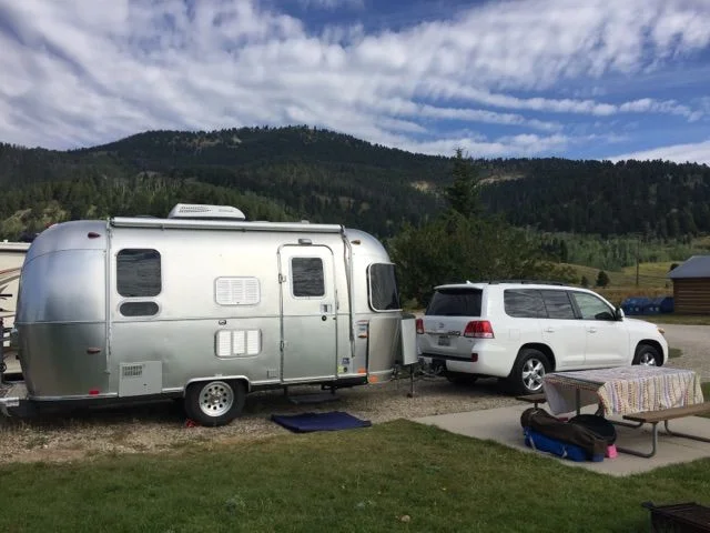

I resolved my leveling issue of the hitch height/trailer by lifting my Airstream 3". They sit rather low to begin with so even with the lift, it's not any higher than majority of travel trailers out there. Stability seems unaffected. Lifted with 2.875" Dexter #11 axle lifting blocks. And 3/16" by upsizing tires from 225/75/15 to 235/75/15s. Perfectly level now with the standard Equilizer drop shank at the lowest position.

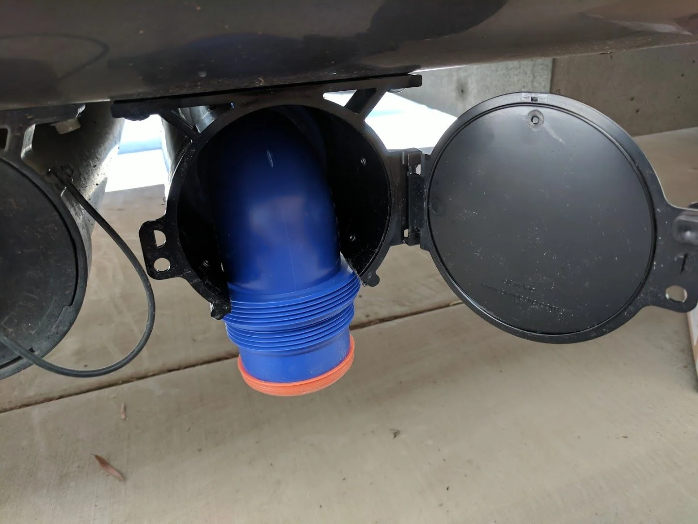

There were just too many good reasons to lift the trailer. Stock, it would all too easily drag the bumper just going into gas stations. The sewer outlet hight was the other big win. Other items I noticed is better access to the outside cargo holds, without need to stoop to get at them.

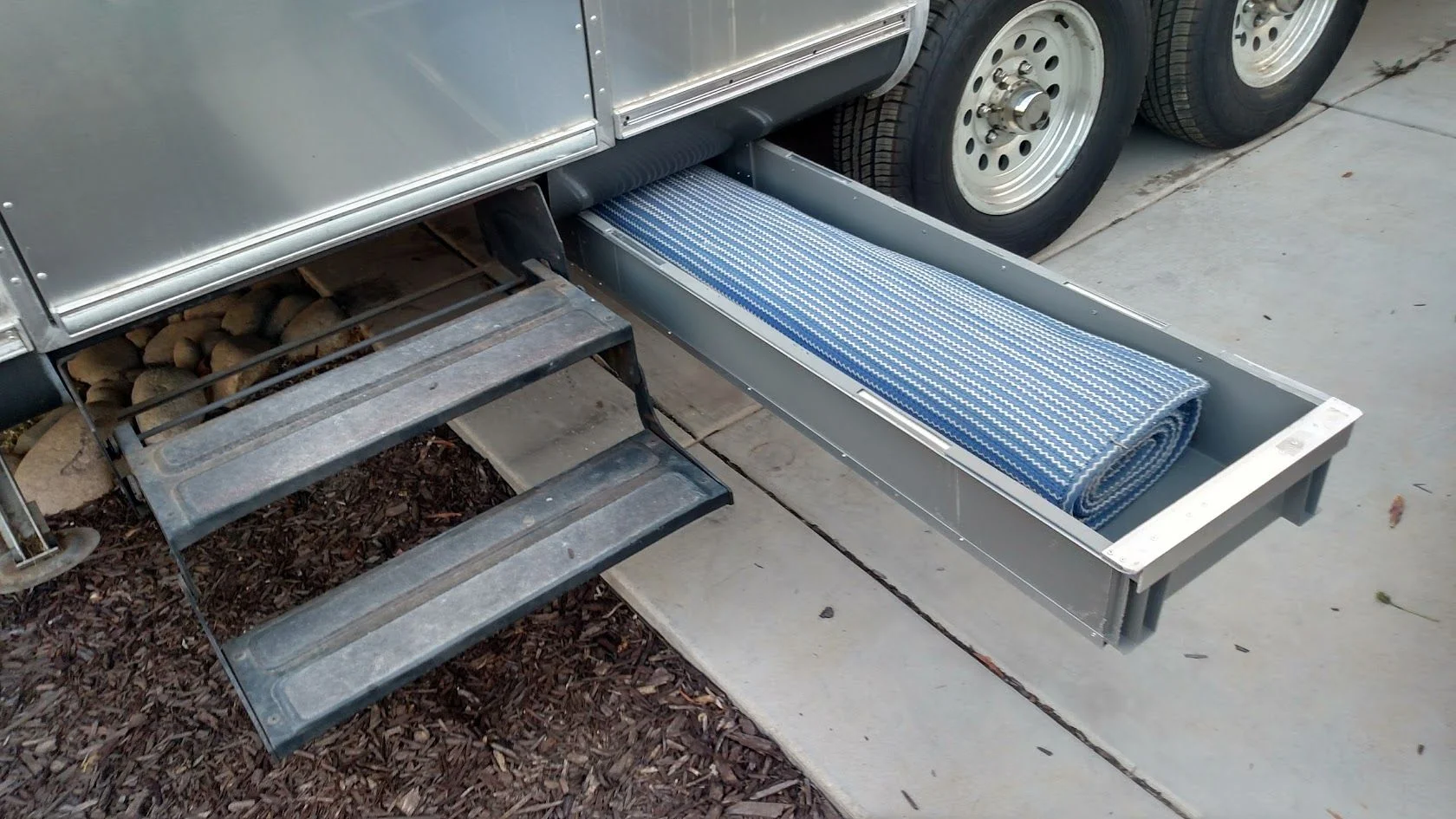

In lifting, I also took advantage of clearance space under the trailer to add a couple things. Airstreams are not known for great storage. I added additional sewer tube storage that also allows me to keep the sewer elbow on, all while still having more clearance than stock. Added a full width drawer for outdoor rug.

That's not my normal hitch, I had the tongue stripped and put on a new jack. My propride sits level, but I've been looking at going up 3" with our next tt.

I like that drawer. I may have to look into one of those.
I fabbed this one, joining 2 long commercial plastic bins, aluminum extrusions, and lots of rivets. They sell similar understorage units but nothing long enough for a carpet.

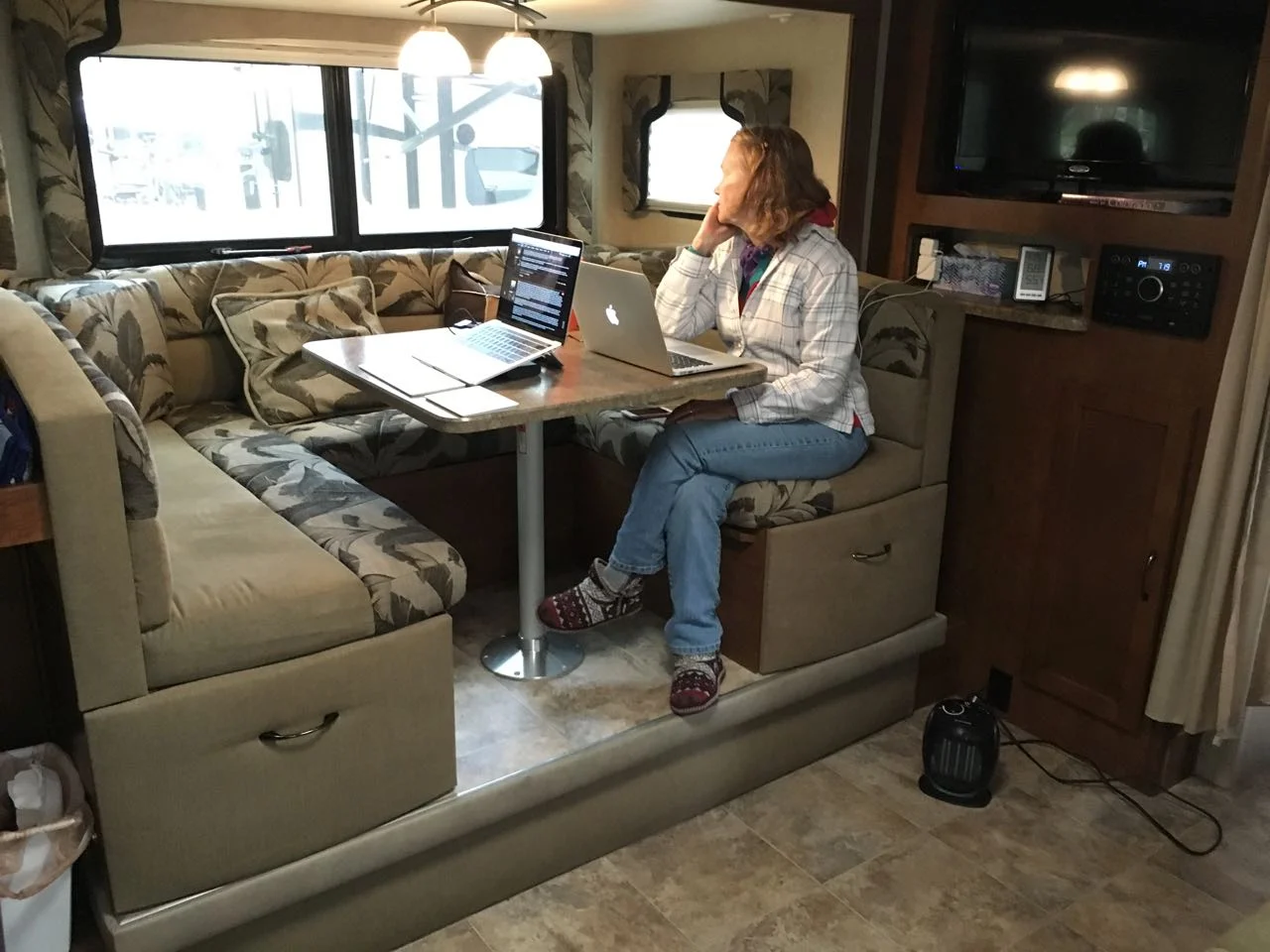

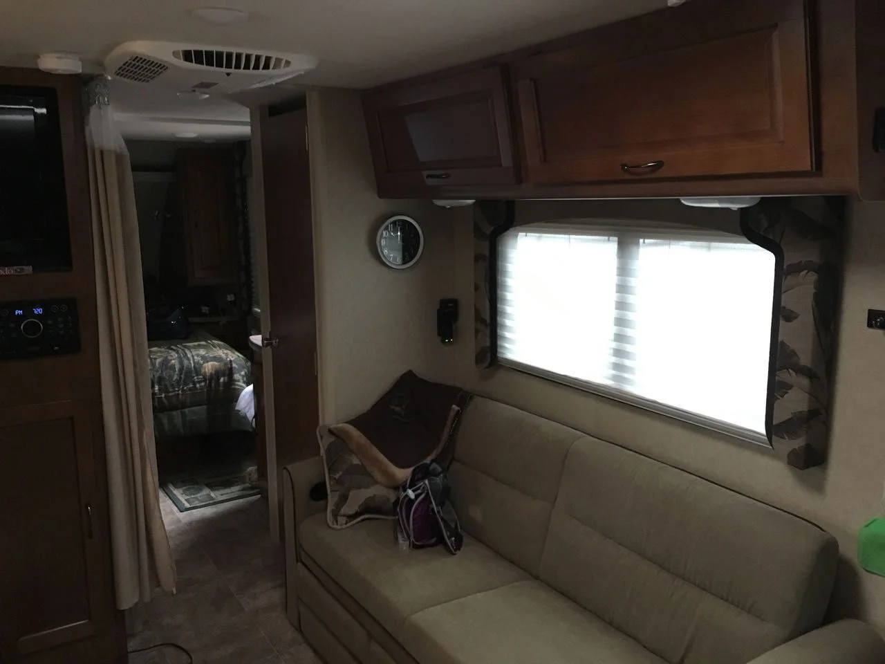

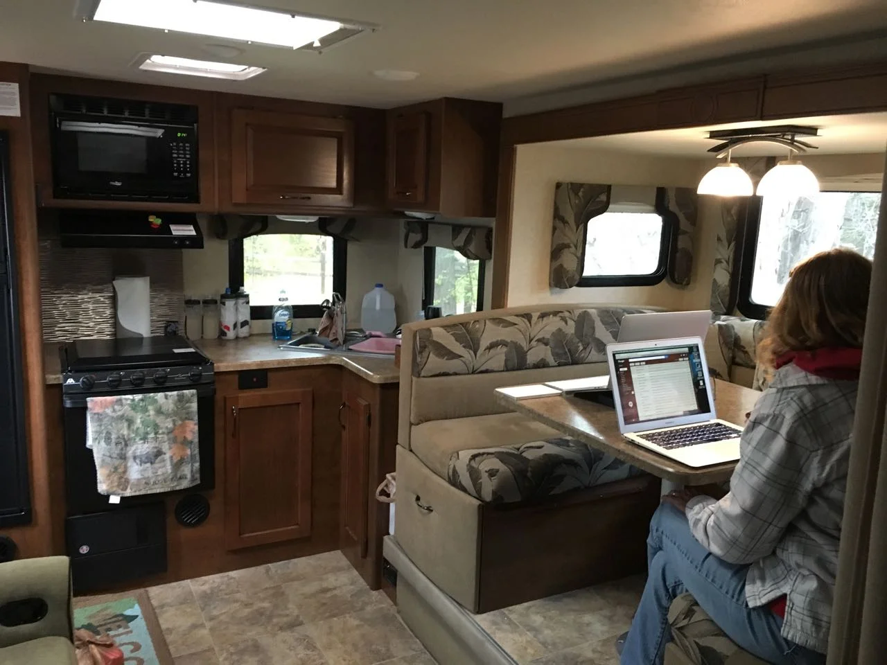

So given the comment on a slide out, here is where I am sitting this morning as I write these response. ;-) My wife gave me permission to take these pics. ;-)
As for cold weather, you may have noticed the small ceramic heater in the lower left corner of the first picture. It can be in the 30's outside and that heater keeps the bedroom area around 60 without breaking a sweat. I only use the propane furnace when the outside temp is going to drop below 30. The ducting for the propane heater runs through and around the water tank area and keeps them from freezing. We were in Gunnison, CO last weekend and the overnight temp got down to 20. We were toasty warm inside and our water was fine. But the "city water" spigot froze so we lost water pressure to the trailer. Good reason to keep some water in the fresh water tank - just in case.
There are people who live year round in the Lance trailers. And some even park them at ski areas and live out of them there. You just need to be aware of what to do to keep water from freezing and have a good power source for the furnace (generator/inverter, solar).
