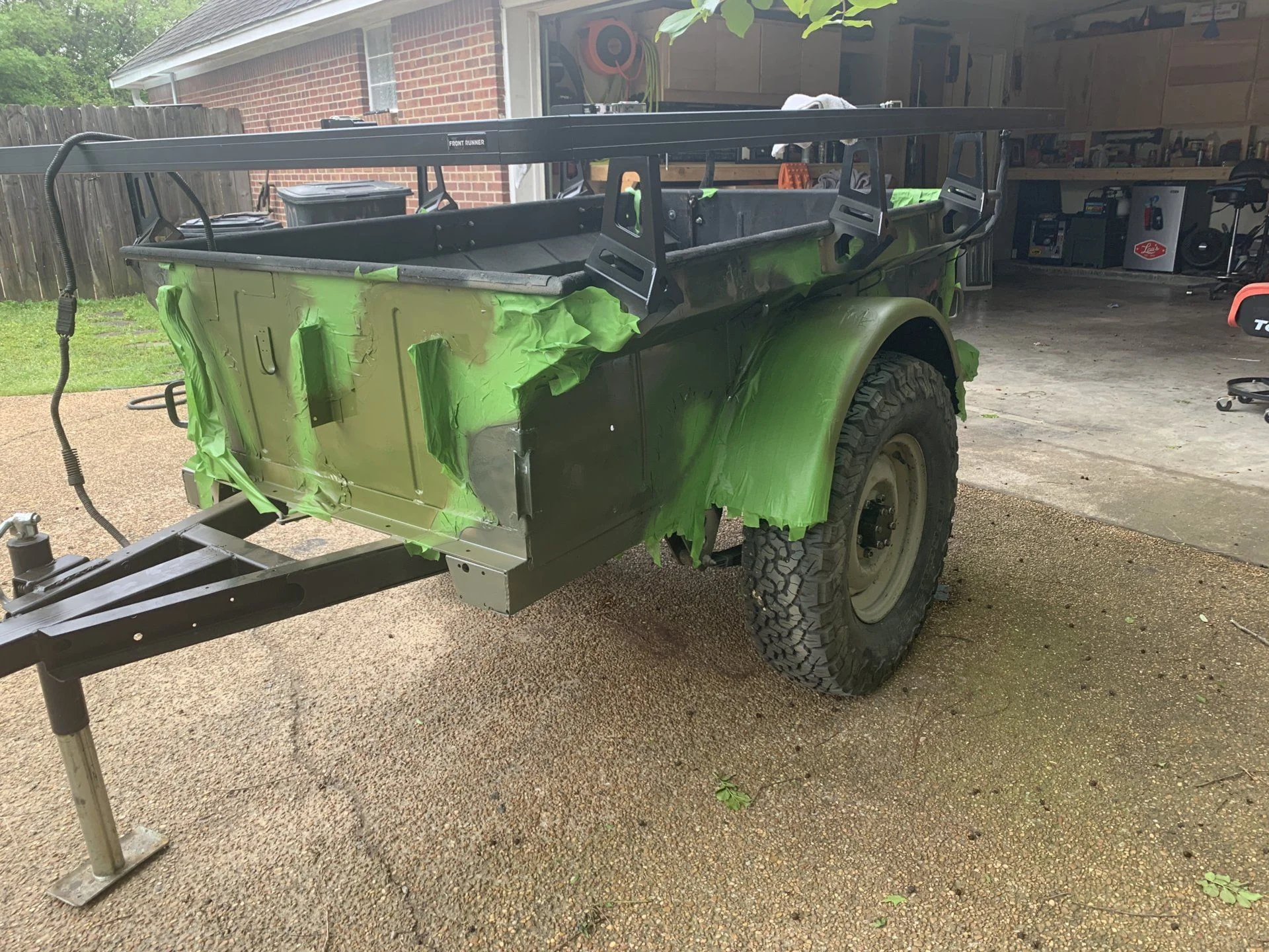

finished up a redux on my m100 this weekend.......
freshened up the paint.......
added rear stabilizer jacks.......
fabricated spare mount.......(finally)

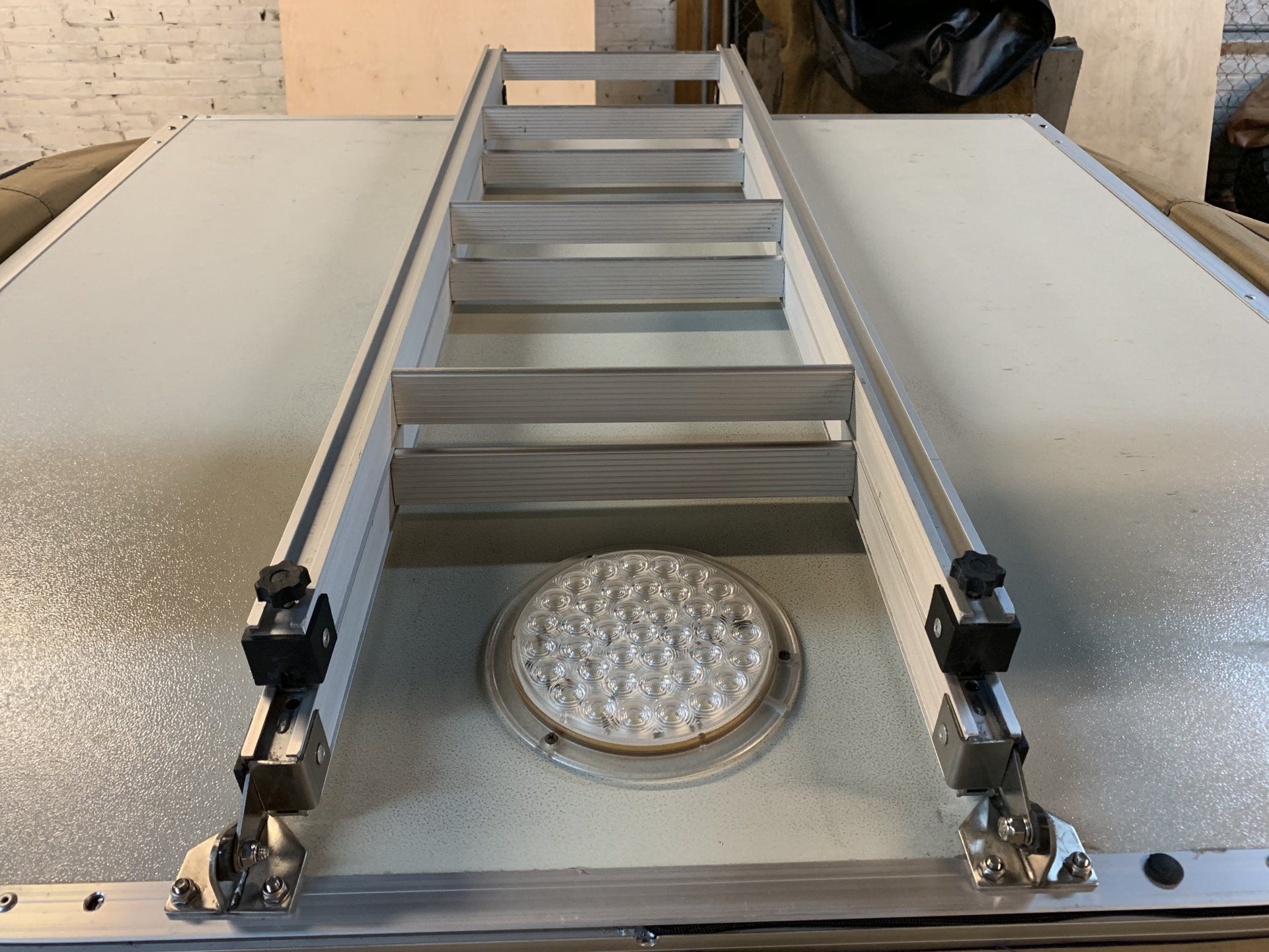

rebuild a rack for tent (since I robbed for the Gob).......
lined the underside.......
new handbrake.......

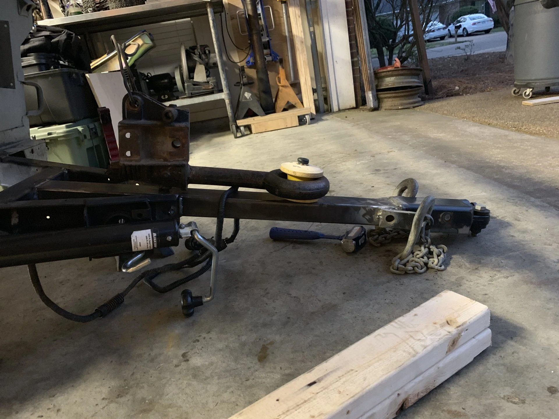

extended the tongue and added lock n roll hitch.......
@under_psi that looks great!
Those rack mounts are pimp. Did you fab those up?
no. @metalshaper did them for me...
I actually text him today to try and get a few more. the tent sits on slats that aren't on the mounts. it'd be easier to add a couple more mounts than to take all the old ones off and re drill and mount.....
I think......the tent bounces more than I like. I even ran an extra slat I had from front runner and bolted it to the underside of the rack from front to back.....didnt help...
Very nice work @under_psi. Really like the new paint especially the P40/A10 treatment on the box.
I have your mounts ready. I'll bring them home this week and drop them at your garage.

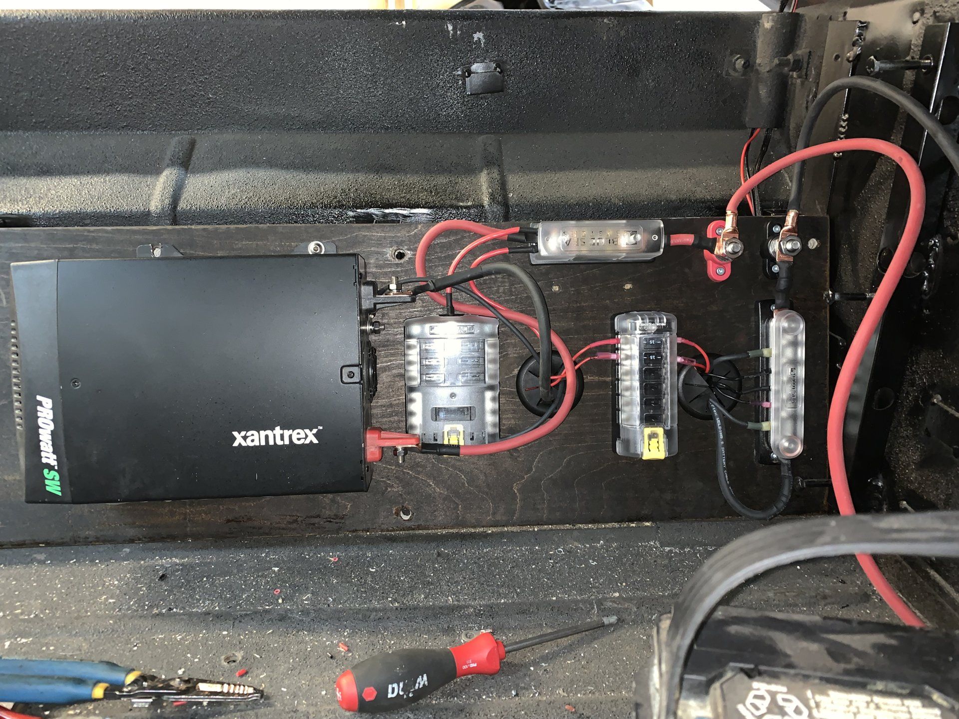

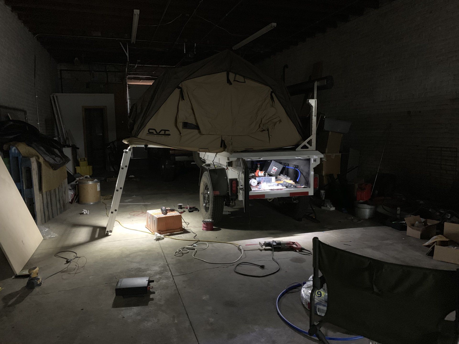

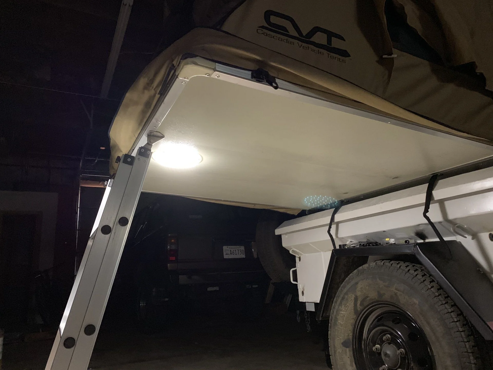

Started adding some interior and exterior lights to the trailer.
First up, light pod mounted under the tent. It is hardwired to the trailer battery with the wires running through the tent floor. Right now it’s only switchable from the main panel but I’m searching for a online switch that I can put inside the tent so I can turn it on in the middle of the night for piss breaks.

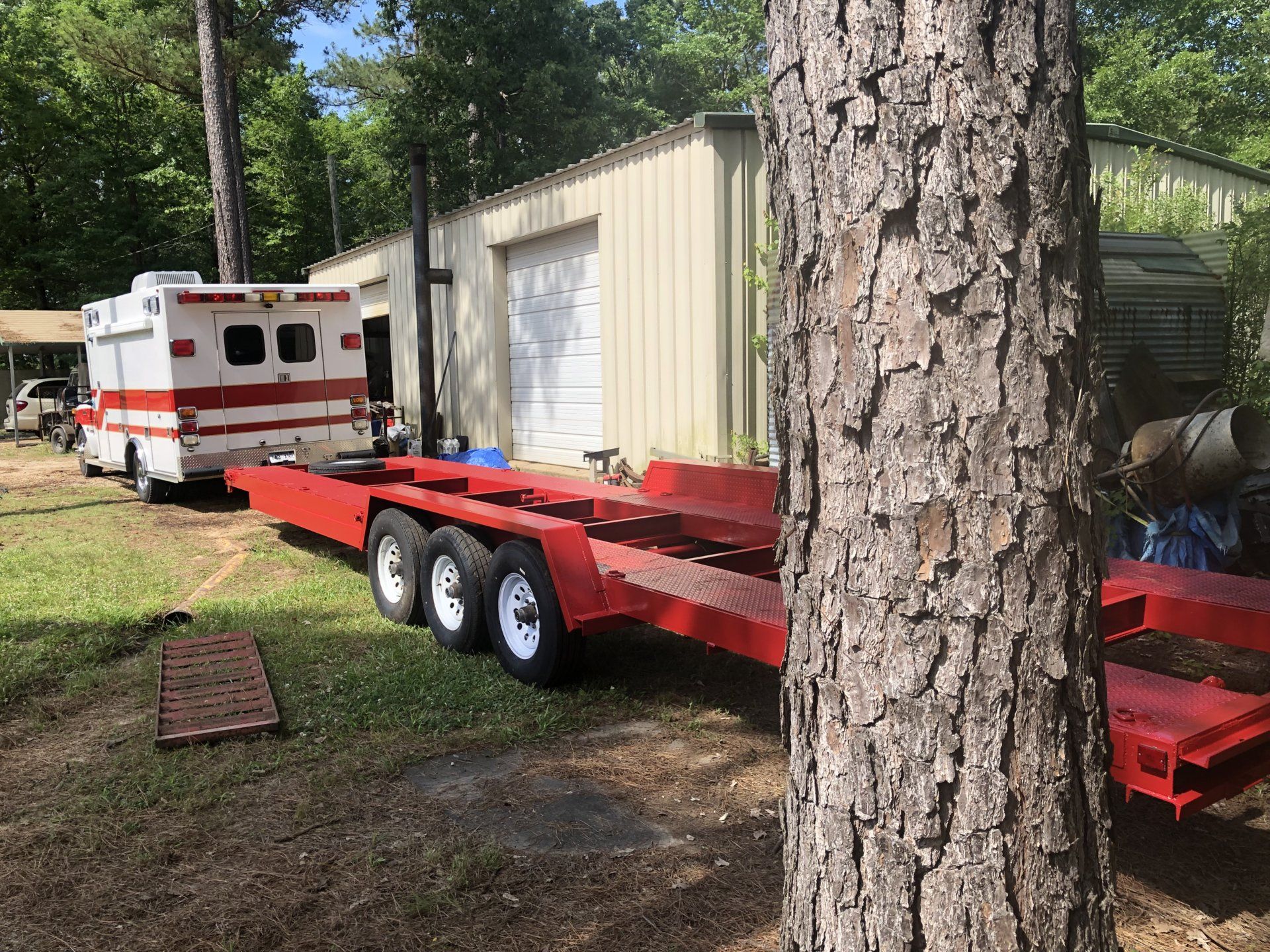

I was looking at these tow dollies that can fit up to an 80 inch wide tread. They weigh about 550-700 lbs and can be had with electric brakes. Here is an example of one I found.
I figured With the Tow dolly, I could still be within range with the tacoma, as the FJ40 probably weighs around 4,000 lbs. It would be pretty slow. I actually have room to store the dolly at my house, and dont have room to store a full on trailer. I could lock the hubs, put the t case in low, transmission in first gear and then remove the rear driveshaft to keep the front wheels still on the dolly and just have the rear wheels spin free. I am unsure if the fj40 rear axle is full float or not, so I will probably need to bring spare rear axles with me just in case.
