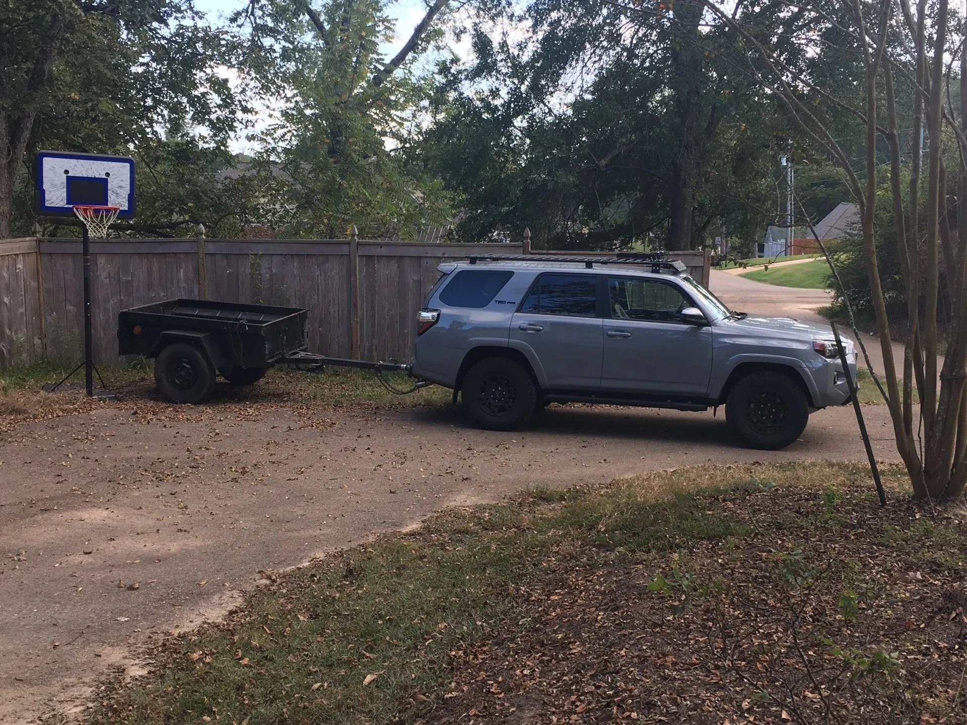

I made a 6' tongue extension, pulled the lunette and ran it back to the first crossmember under the trailer. Wound up being ~55 from hitch to front wall of trailer. Made the trailer very easy to pull.

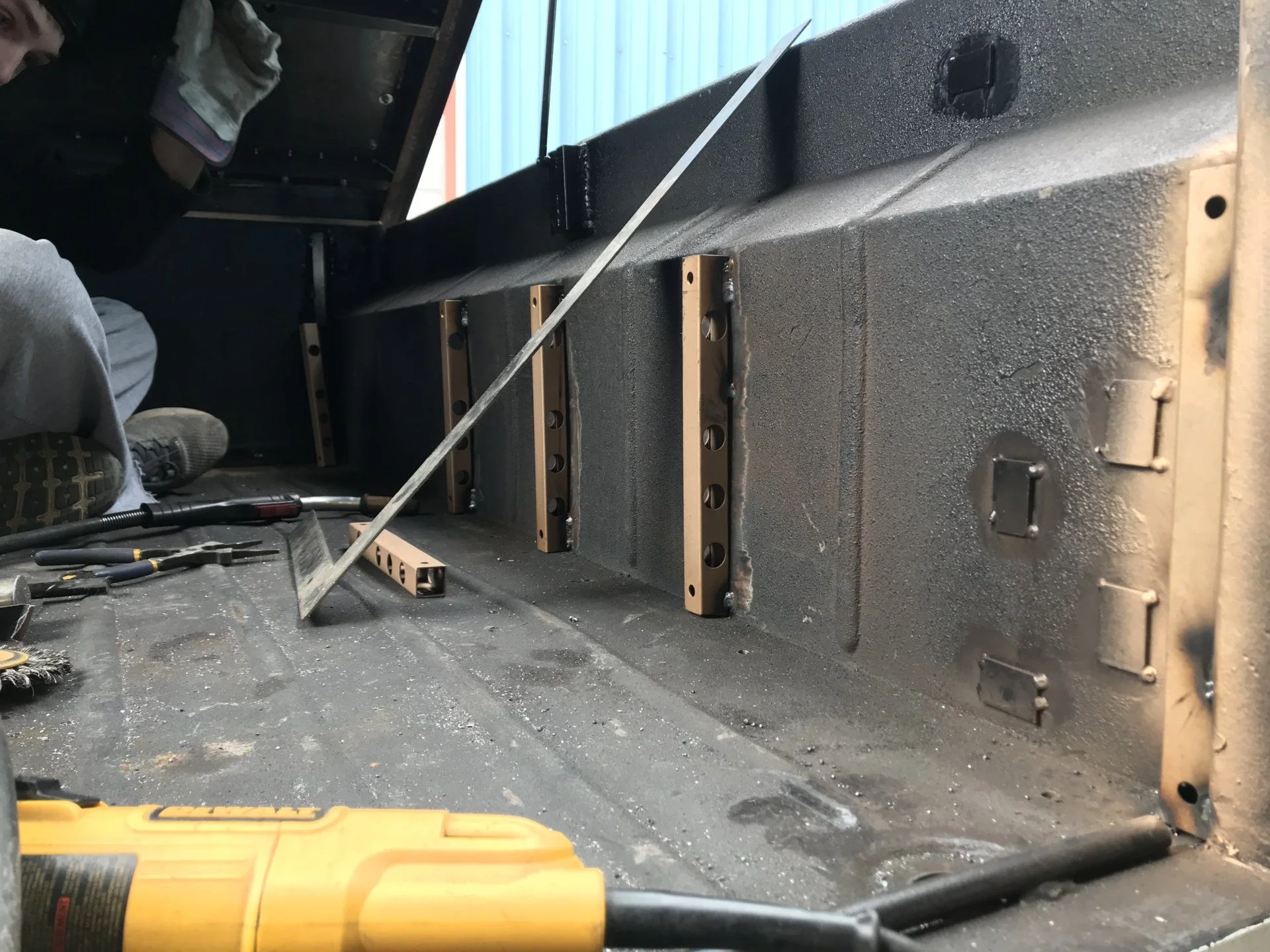

Next weekend I’ll put the side panels on. My plan for the side panels is to weld vertical 1” square tubing studs up the side and install rivnuts in them to them bolt the wood side panels into. the reason for this is to be able to route wires behind the walls and also so there is not bolts going through the side of the tub.

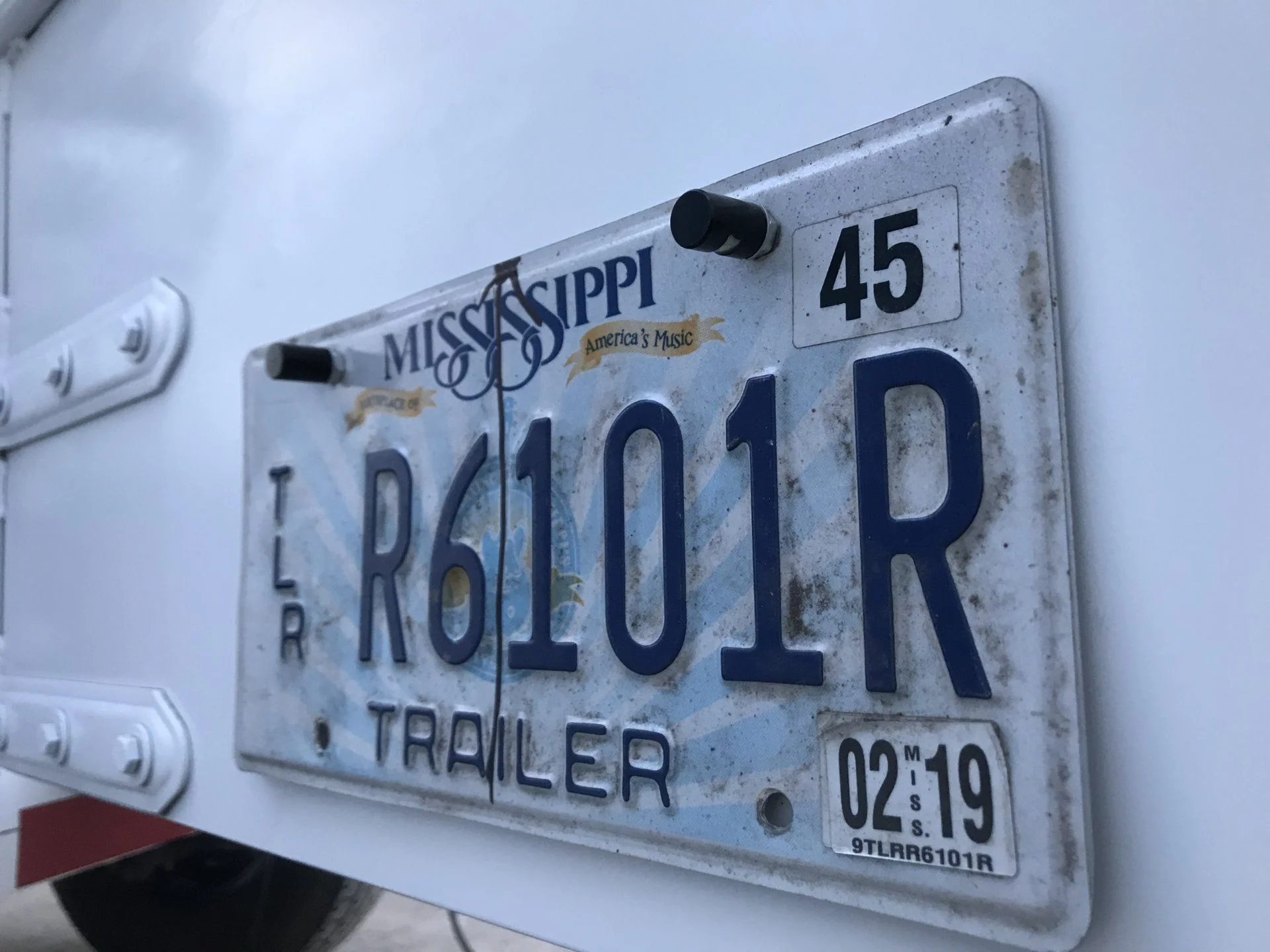

I still had not installed a tag yet so I shot some m6 rivnuts into the tailgate to hold the LED tail light bolts I found on a motorcycle website.
Interior side panels got cut and started to install today. Each panel will be bolted to the steel tubing studs using rivnuts and bolts. 12 bolts to undo and you can then take the panels off.
@JTU post a link to those led bolts please.
