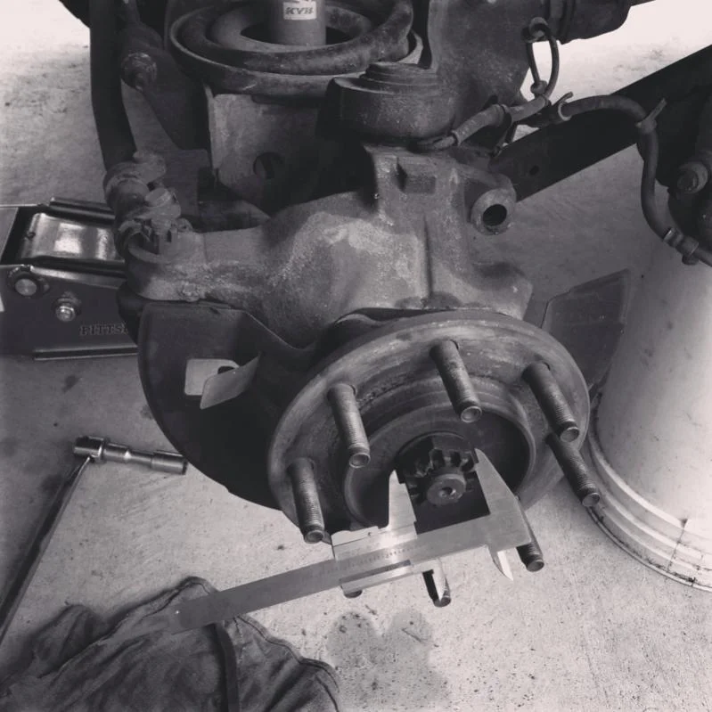

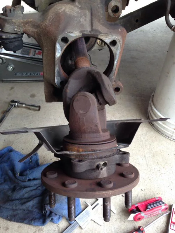

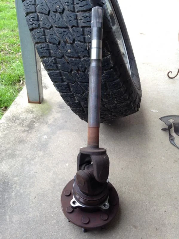

PK would you happen to have the torque specs for the 4 hub bolts? I picked up my front axle shaft from Rene at USA Driveline today and he couldn't put a joint with a grease zert they don't offer one for the new Dana's he said he could grind it down to run the older versions but it would be more work and he wasn't in favor of it. Said I should get another 100k on this one so I'll go with it :) He just bought himself a 2013 3/4 4x4 Mega-Cab for his towing needs.
Put it tight and turn it ¼ :)
from my info 149 ftlb
Thank you Sir just came in to look doing some night wrenching ;)
On non-drivetrain related I'd go with that bud but there is a lot riding on the hub bearing and I don't want any slack in those bolt or it'll cause more problems than I care to deal with. To the bat cave I go :)

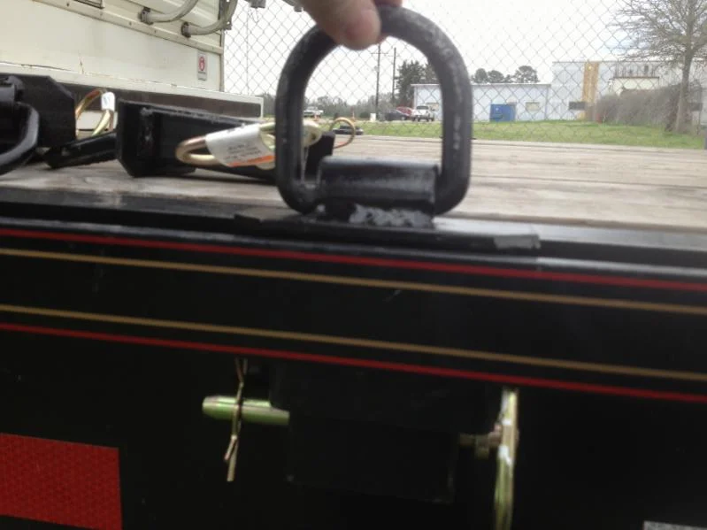

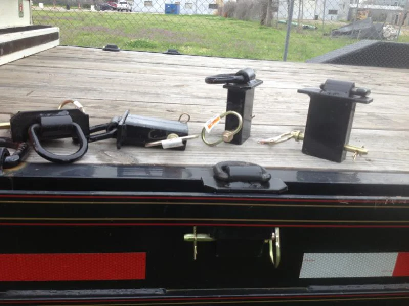

Albert and I got our stake pocket D-rings in, going to test them out for the RoundUp.
Those are very nice thats a great idea :)

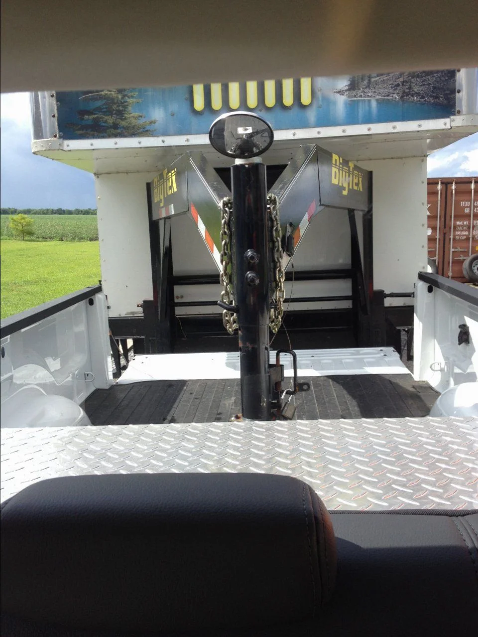

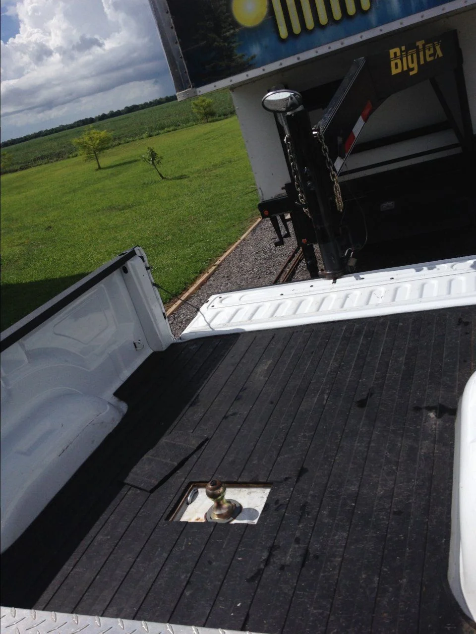

Rigged me up a "Redneck" back up camera for hooking up the gooseneck by myself.
Picked up the round mirror at a truck stop and the magnet at Harborfreight.
All I do is look at the mirror on the neck of the gooseneck till I see I'm on top of the ball. Works like a charm. image.webp
