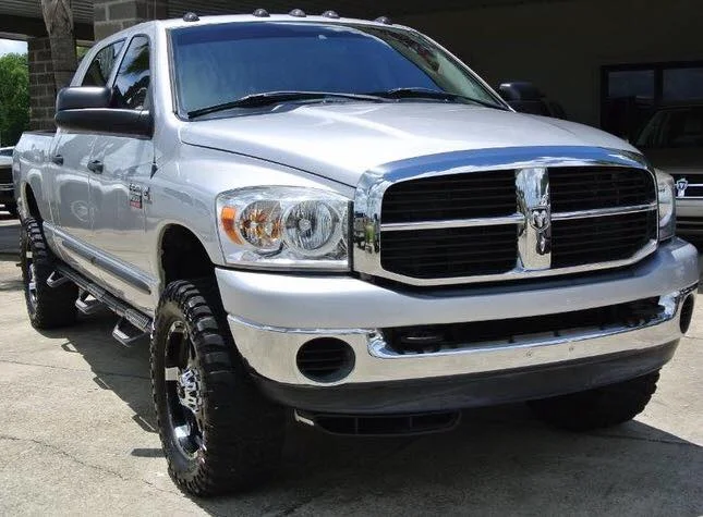

I think I found my problem. When I left, my load looked like this...
...and a few hours later, it looked like this...
Couldn't help myself!
I will eventually strip most of that off.

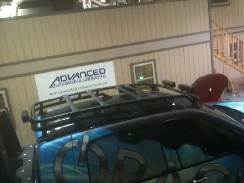

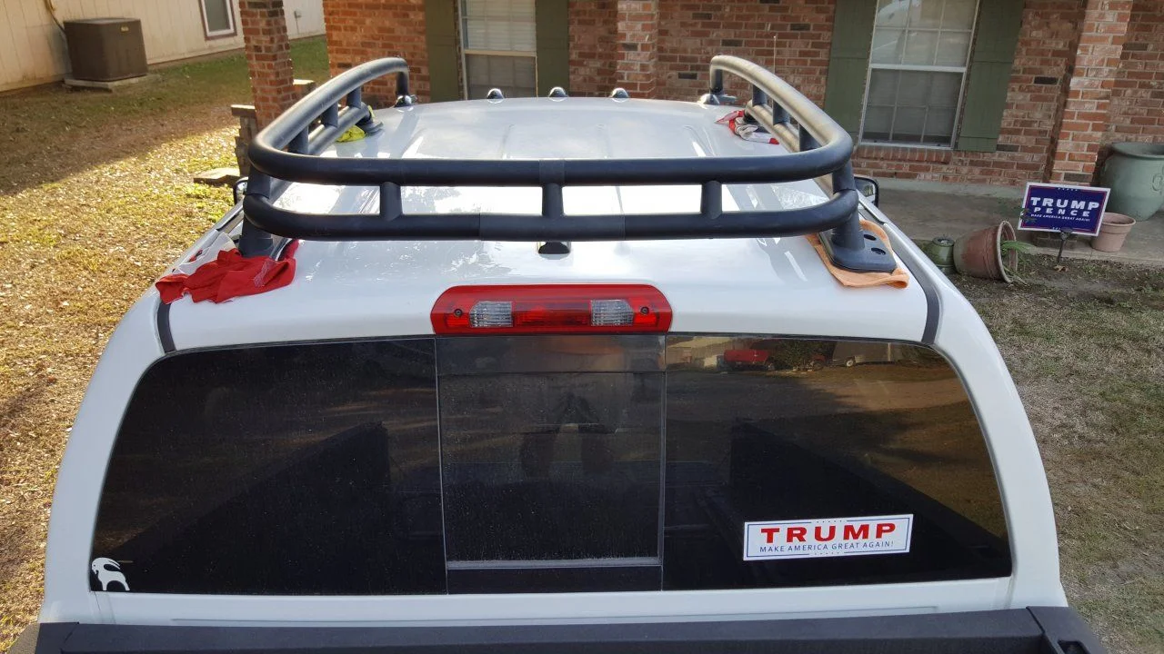

Also looking for a stock FJ Roofrack that was taken off for an upgraded one to mount on the roof of the MegaCab. Need something the mount the cargo carrier and have extra storage space. If anyone runs into one please shoot me the info I'd appreciate it.

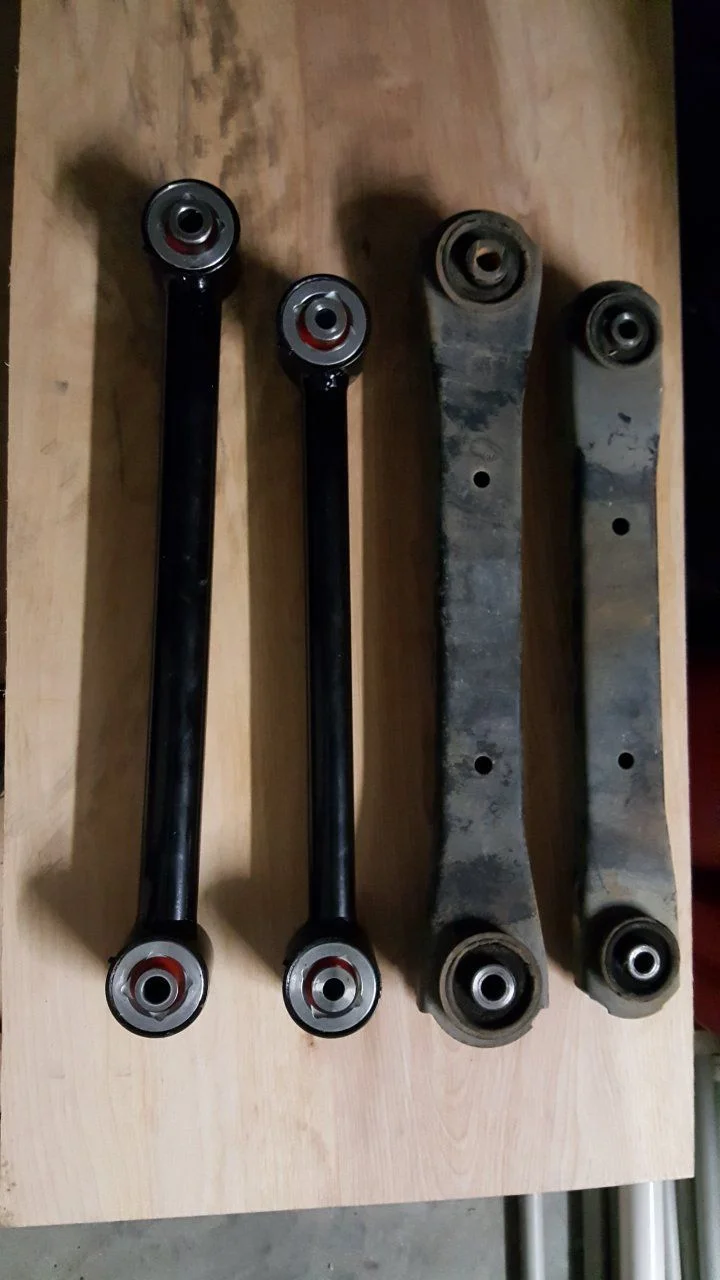

Also ordered a set of replacement control arms upper and lower the bushings in the factory arms are shot and I have one of the lowers slightly bent.
Made some progress following the meeting yesterday mocked up the rack, and got the drivers side controls arms in :cheers:
Control arm info?
Went with the Pure Perfomance from 8 Lug Gear I also have their front adjustable panhard bar. The control arms with new tires made a big difference on my ride. One of my lower control arms were bent those factor arms were thin. If you do yours let me know I'll give you some tips to save you time and aggravation :) 8LUG/Pure Performance 03-UP Dodge Comfort Ride Control Arms
