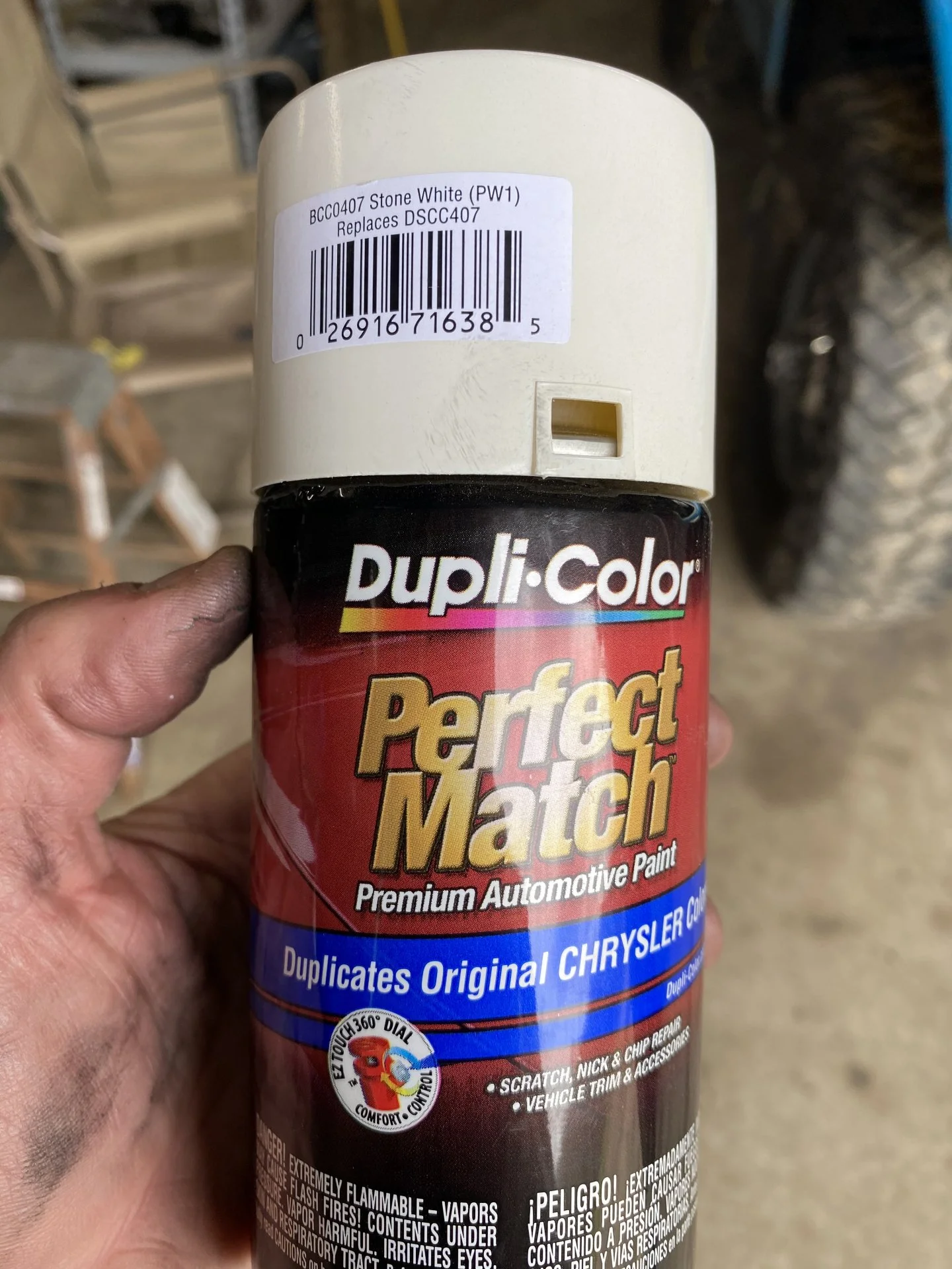

Has anyone found any off-the-shelf touchup paint close to 031white in a spray can? I cannot locate a so-called “paint shop”near me to put some in a can as some suggest. Dupli-color maybe? Thanks
I thought NG once mentioned Rustoleum Ivory or Almond. @wngrog ?
Important to remember there are two versions of Cygnus White. One is “warmer” with a bit of yellow or tan in it. If memory serves that’s Toyota code 031. The other a more pure white. Believe that’s 012.
Not an expert by any means but everything I have read shows Cygnus White as 012 and 031 as no name. When I sprayed some from Cruiser Corps on my 031 you can tell quickly that 012 is "warmer" than 031. In fact 012 looks sort of ivory beside 031.
Keep in mind this is only one data point so caveat emptor.
