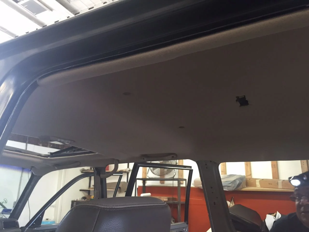

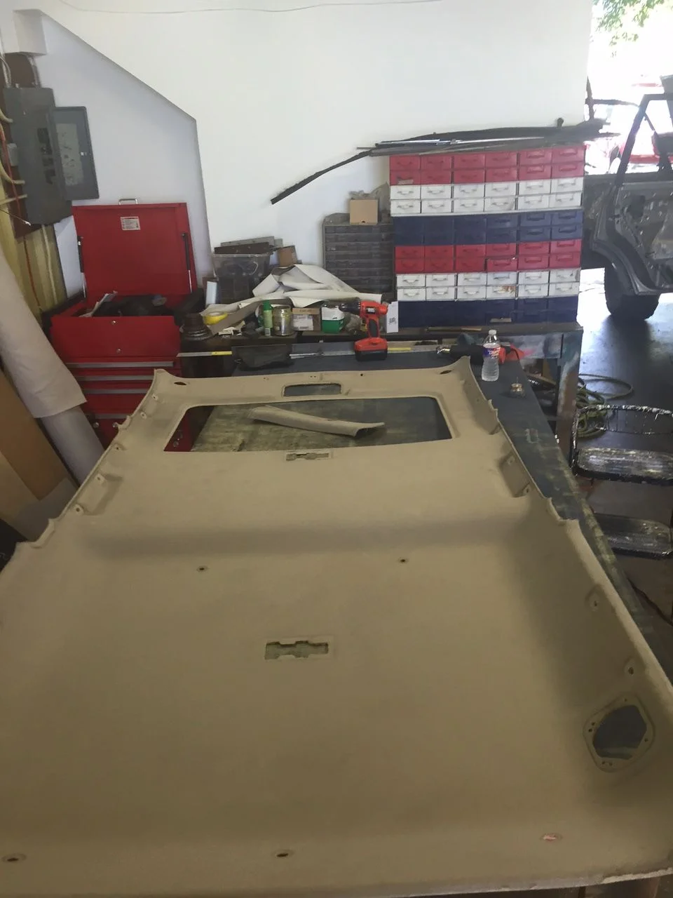

Work started at ASM Auto Upholstery.
Headliner removed
CLD Tiles installed
Hydrophobic Melamine Foam installed
Headliner recovered and reinstalled

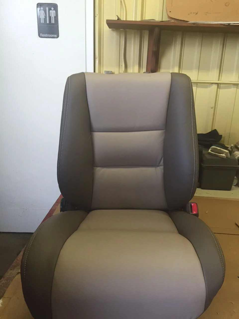

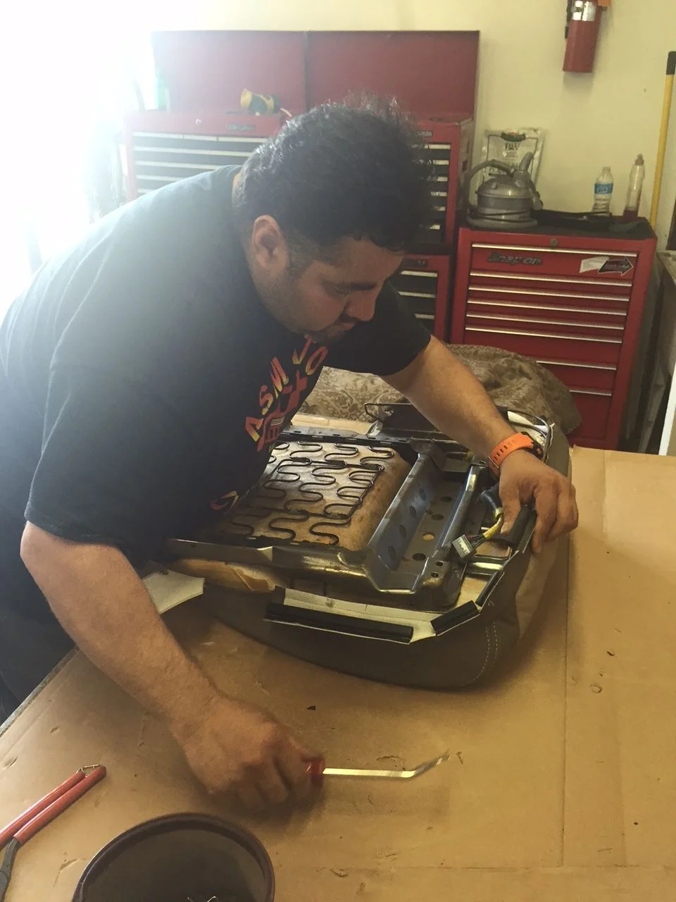

Seats are getting some attention too.

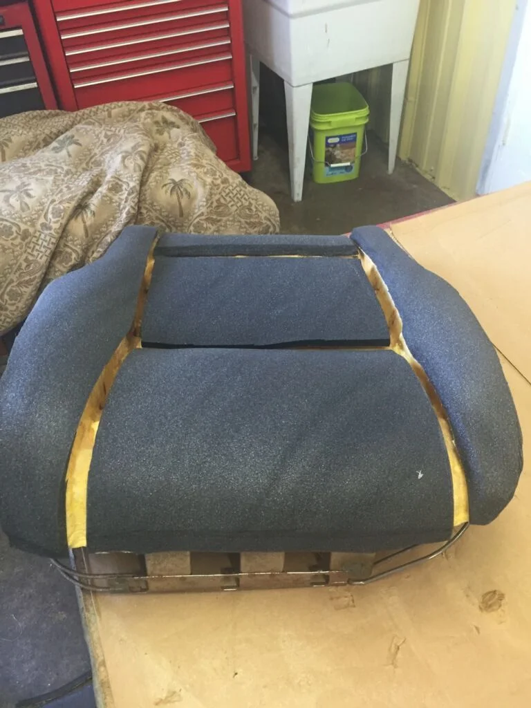

Old leather removed. ASM recommended we add more foam to the seat as the foam is pretty old.
Front seat recovered and a few more to go...

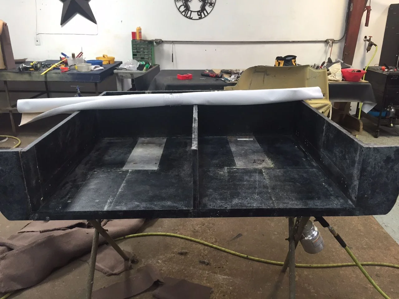

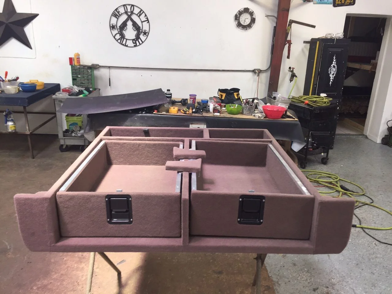

They also started stripping my old carpet from my drawers and will install all new carpet.
-1st seat almost completed
-One drawer stripped
Any pics of the Hydrophobic Melamine Foam install?
No we didnt take pics of the foam being installed.
Check out SoundDeadenerShootout for detail on the install process. They have images.
Starting on re-carpeting my drawers....

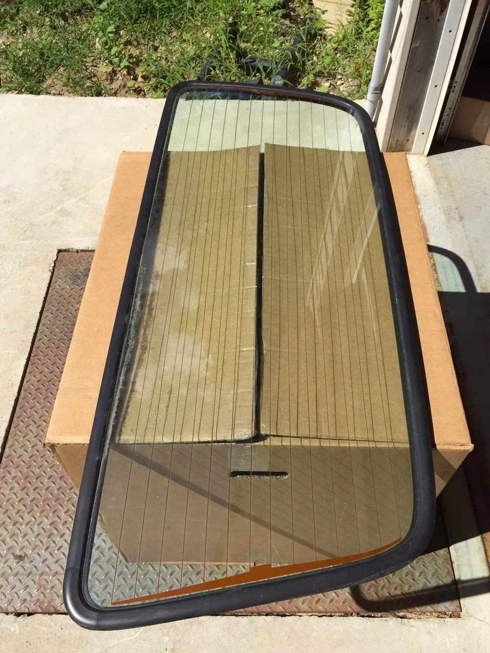

Here is the clear rear hatch glass from CruiserParts... from a 91-92 80 series...

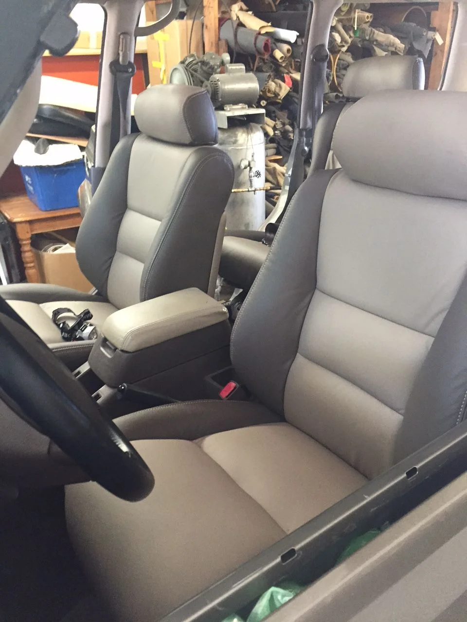

Getting closer on the drawers....
Also getting closer on the seats... need to recover the center console
