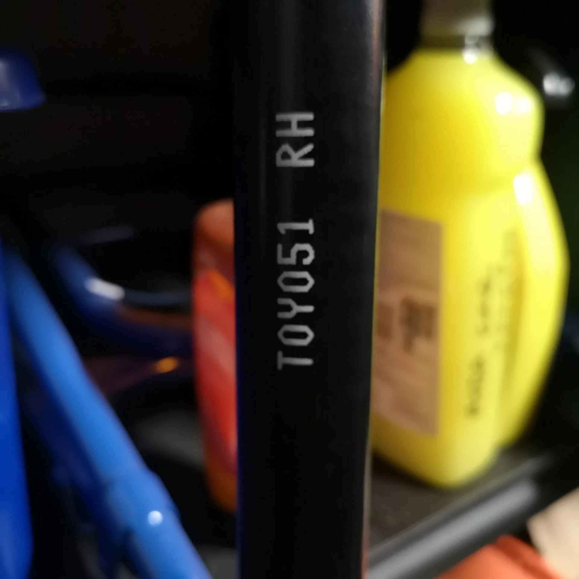

Thanks for the responses - the codes on the bars are 20110A left and right. I ordered for the right car (4.2TD) so I assume they are correct
Can anyone confirm that the cups are the right way round? 10 for RH and 20 for LH?

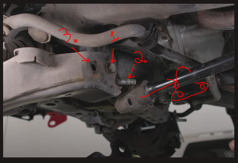

If you slide the cup "up" the bar (toward the back of the truck) are you saying you still can't put the torsion bar in place without hitting... 1? 2? or 3?
1. is the main bolt for the lower control arm, since you're on the bolt head side, you can't really make it shorter.
If it's 1, the torsion bar is too long or you didn't slide it far enough into the rear mounting cup situation. If it's 2 or 3, you really shouldn't have a problem because the cup can slide as far up the bar as you need, then you just slide it back toward the front of the truck and the bolts will slide through the holes.

It's fouling bolt 2 - I have pushed the cup up as far so that the splines disappear into the cup - further than the old bar was.
The old bar was 120.6 cm and the IronMan one is 121cm. It's that 4mm that's the problem. I'll try again whaling on the cup pushing it up the bar with a hammer and see if that is the fix. I think the Iron Man video is confusing me maybe - they say put the control arm end in first when the way to do it may be the other way round

You should be able to push the cup passed the splines, in other words the splined end of the torsion bar should go all the way through the cup and come out the back of the cup, and the cup will just be dangling on the smooth part of the part. I've tried to draw that in my picture, I've tried to draw the cup in red where is should be: passed the splined part of the bar. Don't think about moving it an inch up the bar, think about moving it 2 feet up the bar. Get it out of your way. Does that make sense ??
Look at this again, push/knock the cup up the bar, passed the splines and your problems should go away.

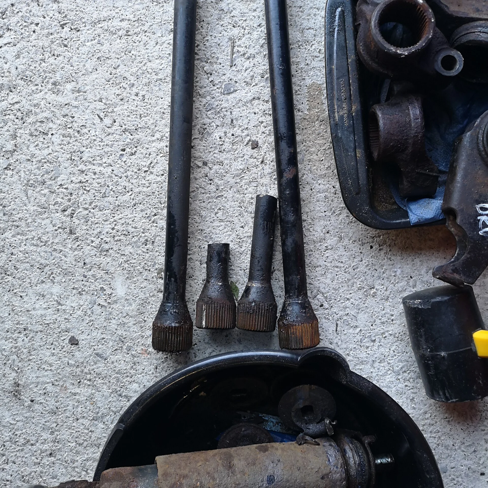

I had to cut out the torsion bars - they were rusted to the cups and no amount of work could get them out whilst under the car. They had been repeatedly doused with Deep Creep and WD 40 penetrating fluid.
It took 20 mins of blowtorch and hammer to get the old bars out of the cups. I broke 2 sockets slid down the torsion bar trying to hit the socket not the cup, but gave up and thought the £40 for a new cup was the better option if it came to that.
The splines are not folded in as a torsion bar was inside when it was hit. I have managed now to get a bar to push all the way through both L& R cups. My mistake was thinking that they were not designed to do that and that they would be concave to limit the bar movement. Made sense as that is how the rear ones work (albeit with a cap). Lots of copper grease, small wire bush did the trick. Initially a band of rust prevented the bar passing all the way through - and what I thought was the limit to push a bar in to the cup was actually just corrosion where the old bar had been.
