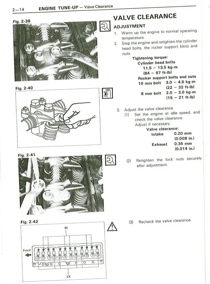

Here's my write up on the adjustment: How to adjust your 2f valve clearance
Also interestingly the 80 2f engine fsm shows the rocker support nuts (top picture) to be 8 and 10mm but mine (a later 2f) was 12 and 13mm as I recall.
