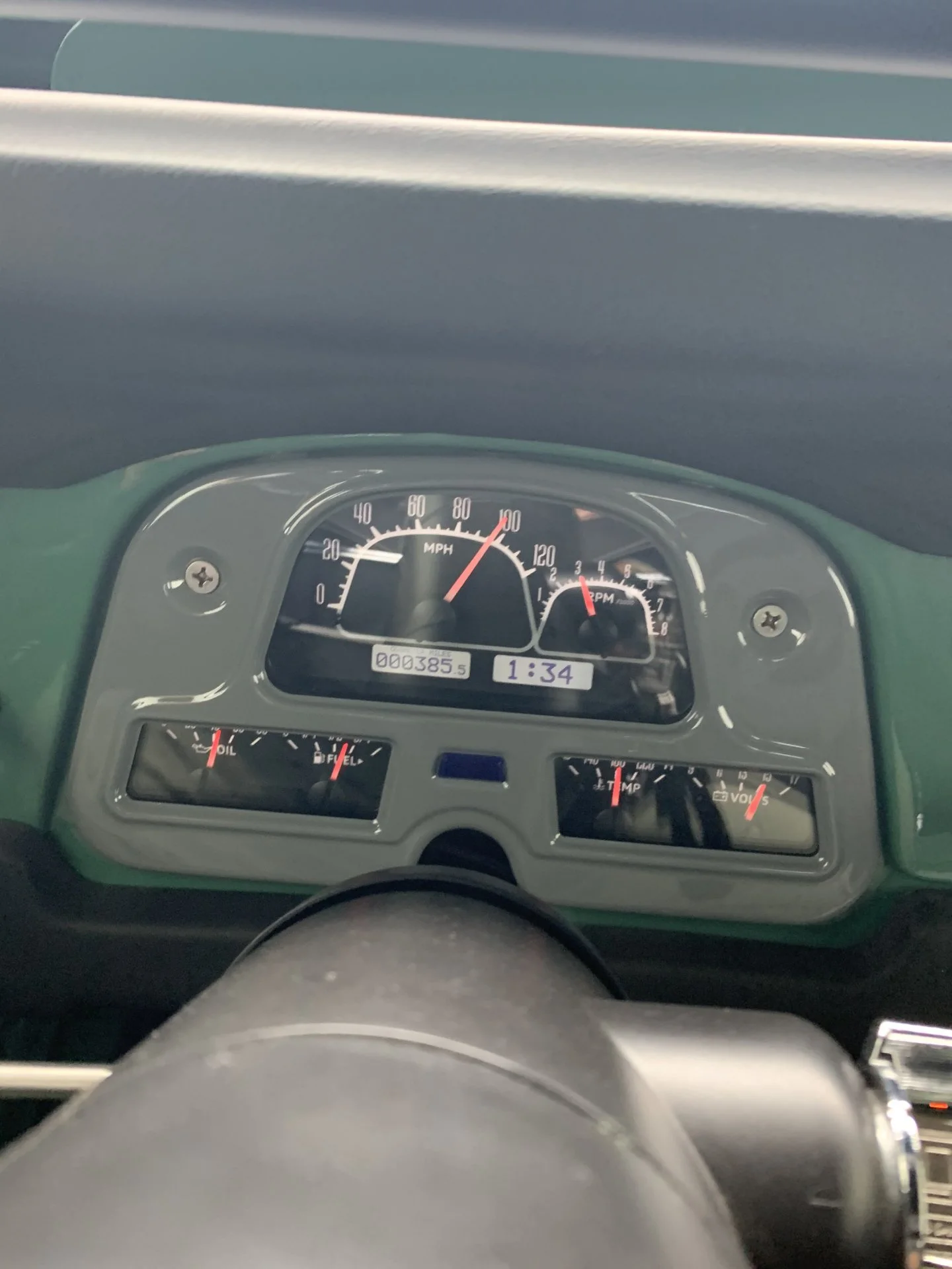

This is what mine looks like with true 33s and 4.11s with H55
Something is off on that because it would be over 3000 RPM
Depends on his diff ratios and tire diameters. Lots of ways to cruise at 100mph with an H55 at or under 3k rpm from a mathematical standpoint.
3.7 diffs and 37's measuring at 36" diameter would put you at 2935 rpm at 100 mph.
3.7 diffs and 35's measuring at 34" diameter would put you at 2953 rpm at 95 mph
On edit: I respect physics and value my life far too much to go near 100mph in a short wheelbase FJ40. But one could do so quite easily with the right combination of power, gearing and large tires.
I’m going with the Dakota is a bit off. I’m pretty sure that’s the LS/auto truck he did last year.

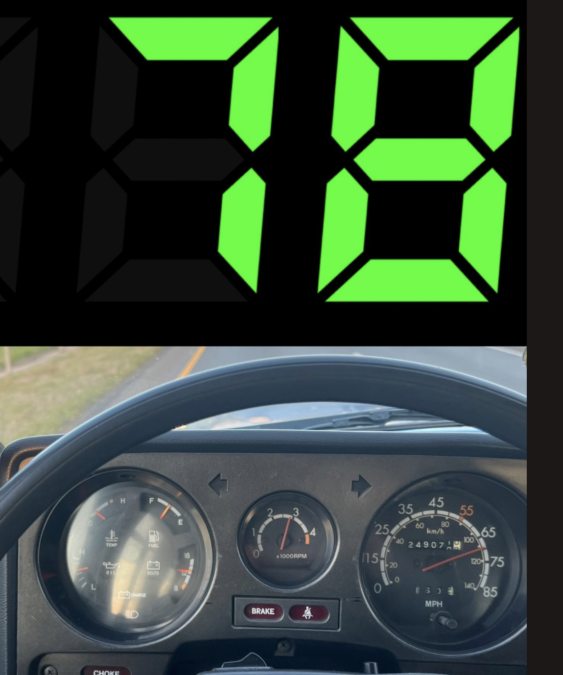

That's about all mine could muster. Tired 2F, H55, 3.70 gears, ~31" tires
Speedometer is reasonably accurate

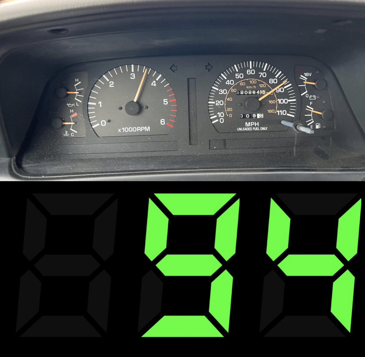

Mine run out to the low 90s with my built Mosley motors. 40, 55, 60. Does not seem to matter drag or weight. They just stop there.
The top speed winner around here is my
3FE, H150, 4.11 truck with 34” tires.
Warthog was about 92 or so tops
2F, H55, 4.11, 33s
