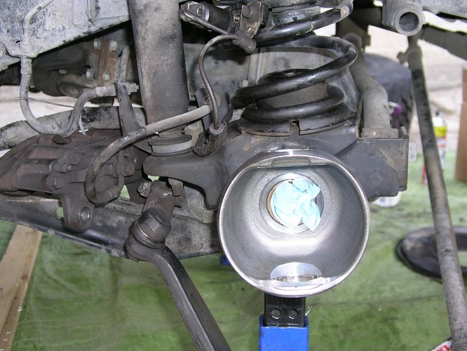

So here is the passenger side all cleaned up
Here is a close-up of the knuckle with the old seal still in it. I will be replacing it with the Marlin inner seal tomorrow.

Knuckle housing all cleaned up. Is it safe to assume that the housing stamped R2 is for the passenger side and the one stamped L2 is for the Driver side?

Well, I was struggling to hold the knuckle housing up while the top and bottom caps were seated. By the way that is a pain in the A$$ to do! Anyway while holding it in the prime position I grabbed the caliper bolts instead of the upper knuckle housing bolts. Anyway I start cranking away and they started getting tougher and tougher. By the time I realized I had the wrong bolts it was too late. I stripped the first two threads off of the caliper bolts so I will need to replace them, and it appears I have messed up the housing threads as well because I tried to put the correct bolts in with no luck.
So what are my options?
You can try to re-tap the threads on both the caliper bolts and the housing. But I'd get new caliper bolts as that's an easy fix. In regards to the housing, there appears to be plenty of thread depth left and the fastening ability may not be jeopardized. The other resort would be to get a new/used housing.

Big thanks to John and the boys at SD Trux.... They fixed my threads and I tested the bolt in them last night and it was like butter.
