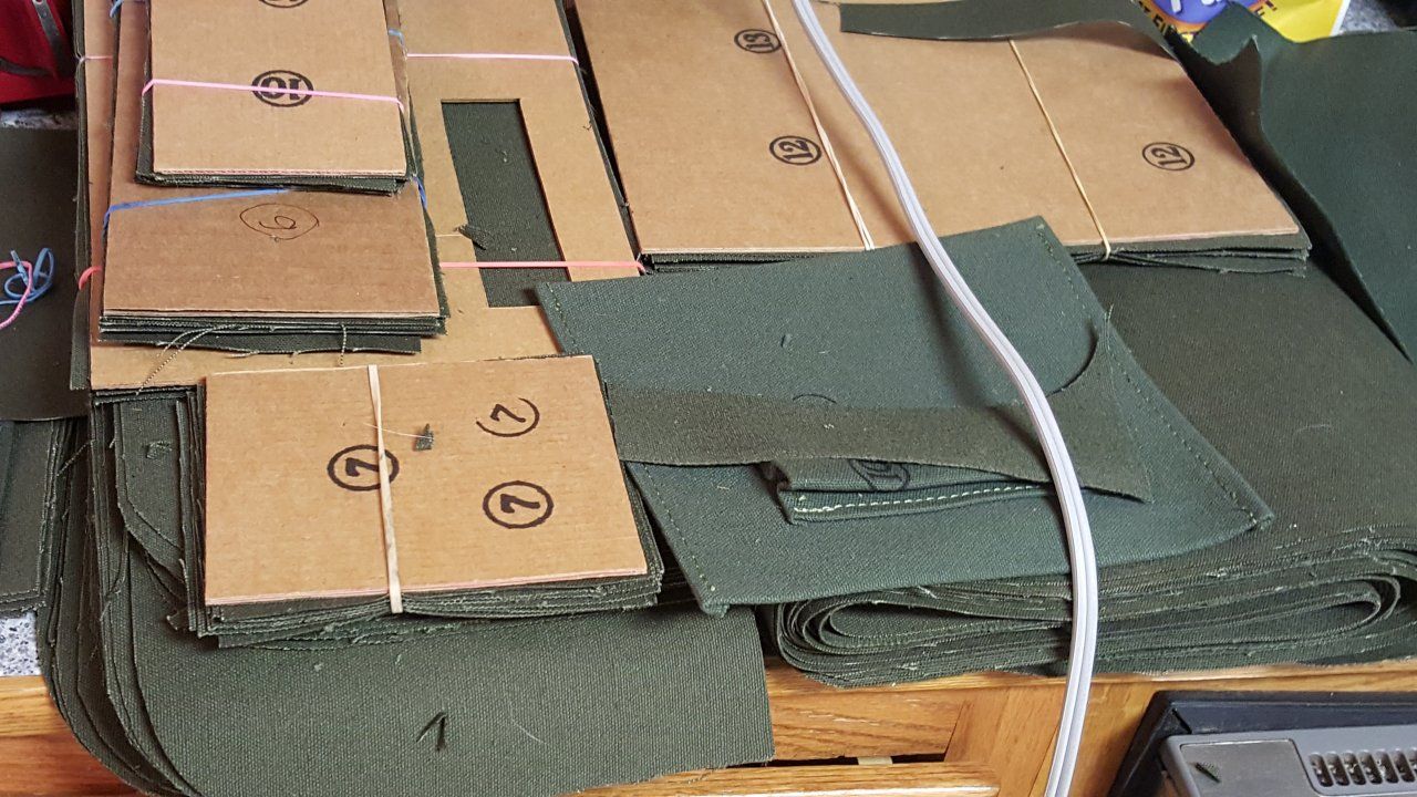

When I cut these out I made the template about almost 1" larger then the finished product (only to one side or it would be too much material) to allow for the folding, first ones I did I only did with 1/2" and found that was not enough and took longer to get the fold, it is easier to cut off any extra material, but most of the time not needed.
I also fold the sides in first (part that will get sewed to the roll, then the top and bottom if it is a strap this keeps the side nicely tucked in while I attach to the roll, hopefully pic will show you what I mean, I also cut the excess corners off which may stick out while attaching to the roll.

Here is another lesson learned, too keep a finish sample product with the template, makes it much easier later, if you do this again.
all the cutouts are done, and still working on sewing them up, then I will start attaching them to the roll
