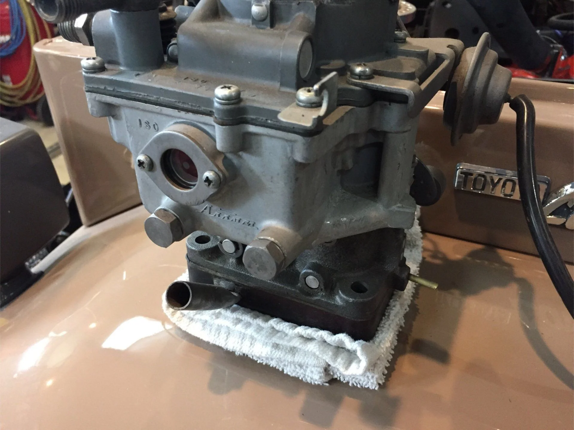

Pictured below is a 1974 factory Aisan carb that came on USA FJ40’s. If you have the same carb you should rebuild it. Also, you might try slightly larger jets.

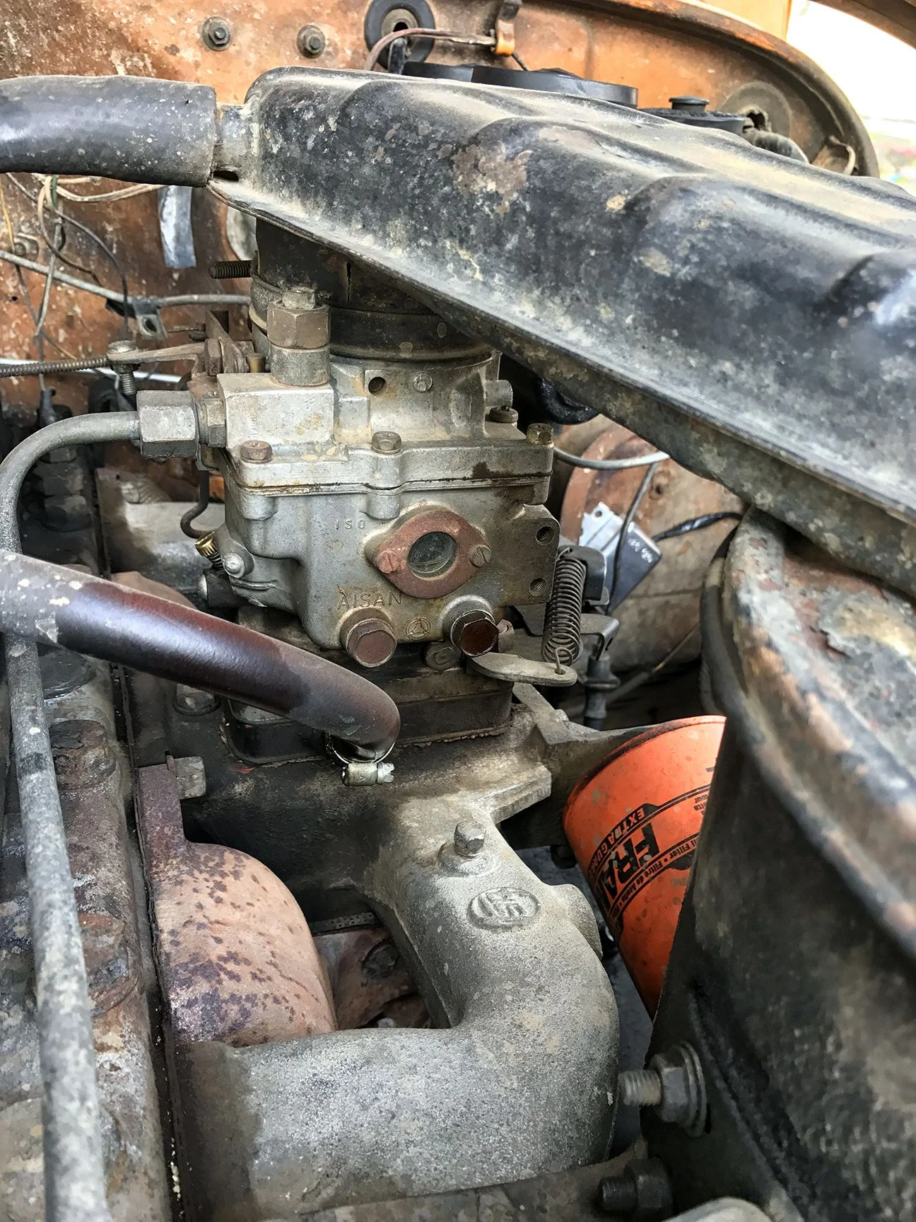

here is my carb which was rebuilt already in May 2015!

5,000 feet elevation should not be an issue. looks like the gas level in the carb bowl is low.

just looking at the 1 engine picture, the bypass hose is capped off. it goes from the water pump to the neck above the thermostat.
This may be the key, here--no bypass hose--may explain why the thing heats fast, then cools down--did it do this before??
