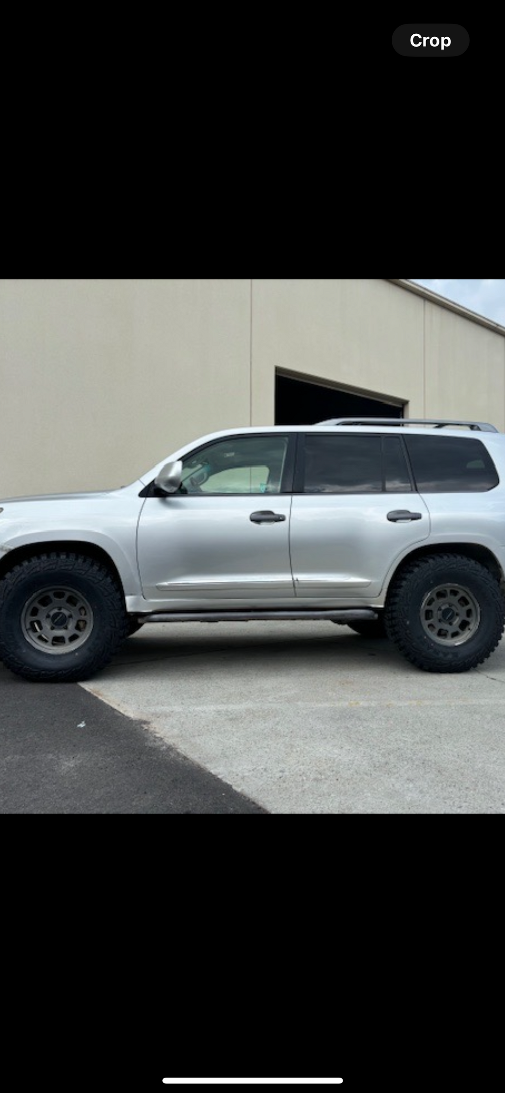

1” Body lift from NST Spec @MTKID on and 37s on in Normal height. These are unmodified TKOs. I think angle cuts down the gap and it still looks good.
What offset on the wheels? And how well do they tuck?
+25mm. I don’t know but have been told it only rubs a little when transitioning with pace from downhill to uphill over a bump. I do have Perry Parts bumpstops that have not been installed yet that should fix that. Also going to be adjusting the fender liners which is where I was told it rubs.

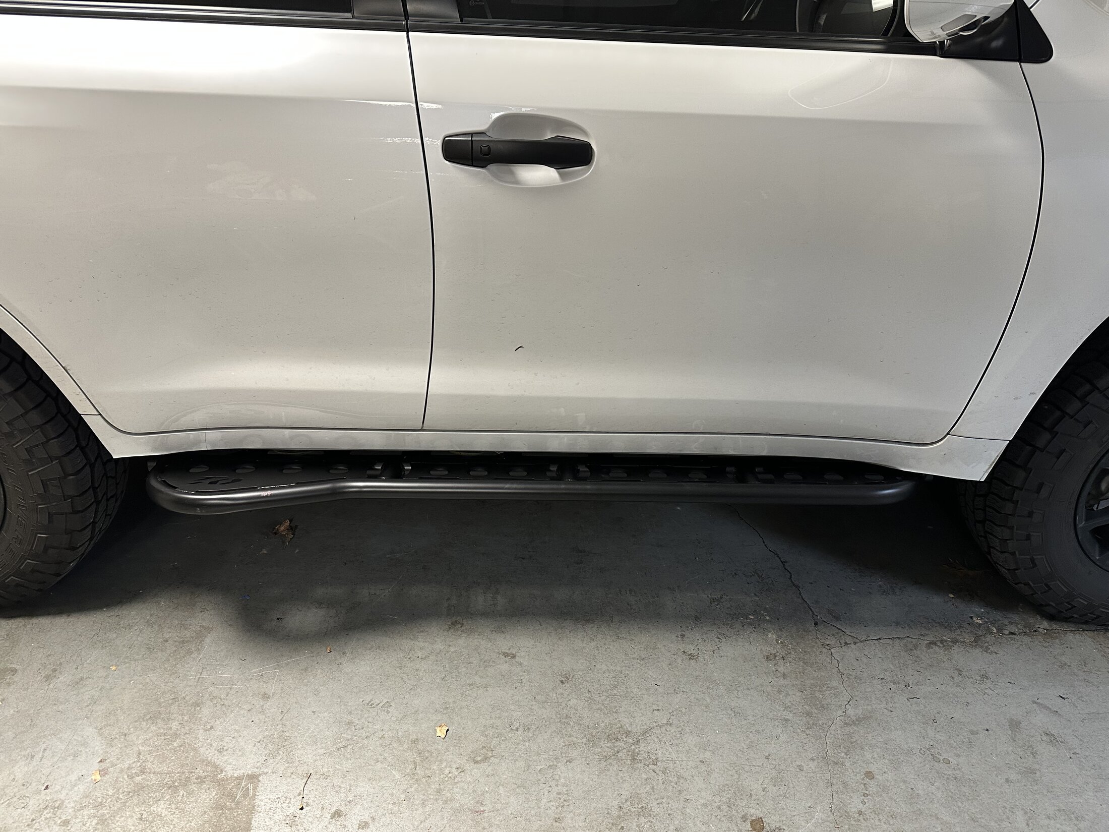

How much clearance is there between the slider mounting arms (and the bottom AHC protection plate) and the actual AHC hardware? I'm wondering if you could adjust these sliders for a 1" body lift just by chopping the frame mounting plates off the arms and then welding them back on an inch lower. If anyone wants to crawl under their truck to investigate, I'd appreciate it :D

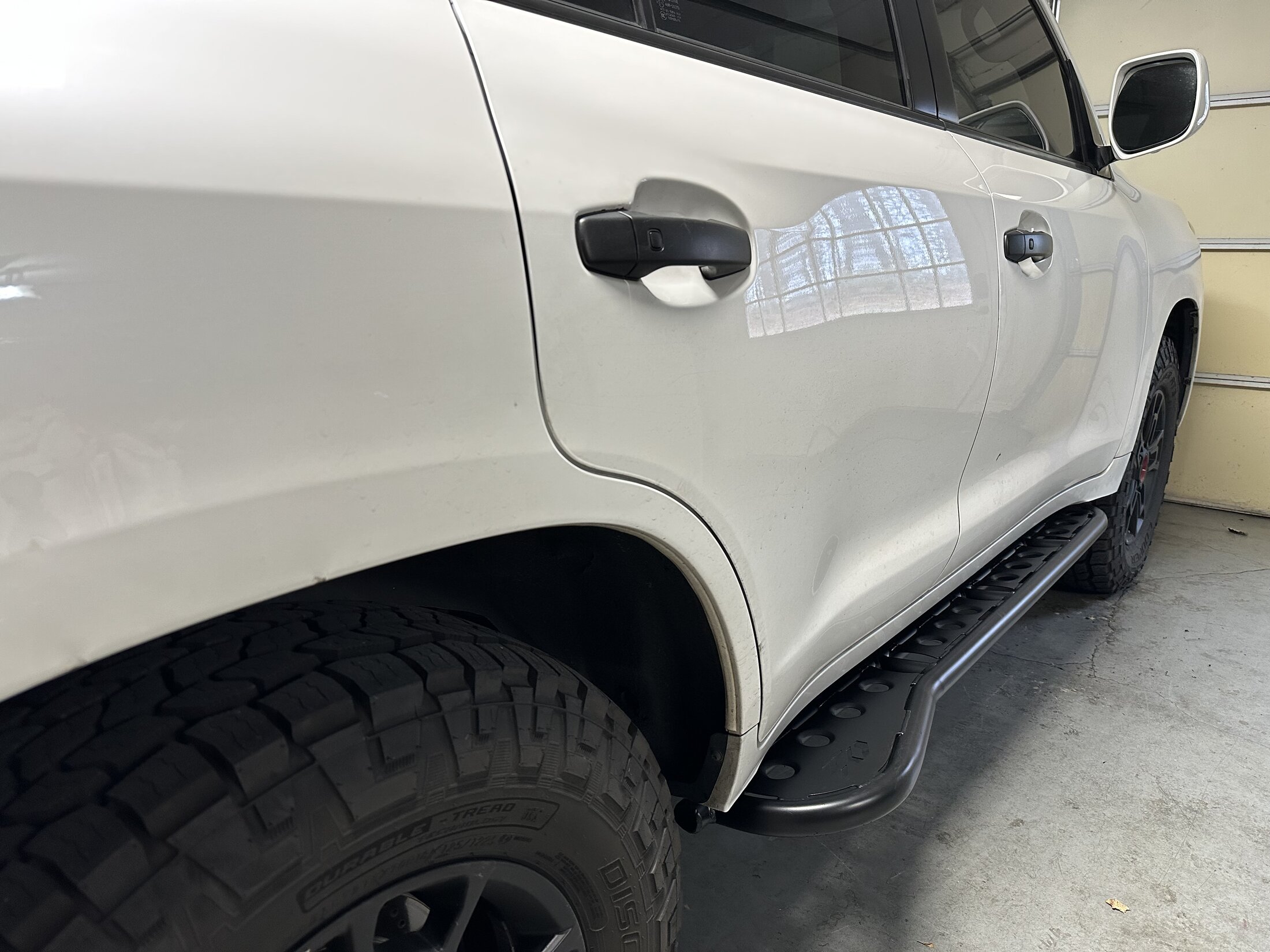

Hey. I just installed the flat w kickout on my 570 and i have a NST Spec 1.5" body lift. There is definitely room to move the supports up but it will be some trickery to weld the support legs as the support bolt holes are spaced so that getting the support leg in there and welding it properly will be tricky. And then you also still have to support the AHC protection if you want it installed so would need additional bracket mods for that. Happy to take whatever pics you'd like to see!
No supports on the ends-just where your ahc cages bolt in.
I used a Jack to lift the vehicle from the rear of the slider and it didn’t flex enough to hit the body. Not sure if a hard drop would cause enough flex to put the slider into the body.
Came here looking for this. Great news. Some flex is tolerable as long as it doesn't contact the body it's intended to, um, protect.
Did you jack test in the middle or front of the slider?
For what it's worth, OEM's that offer rock sliders from the factory jack test theirs. Depending on the OEM, the test can range from empty curb weight to GVWR. Jack test at front, middle, and rear of the slider. They figure trail repairs (or driveway) would involve jacking the truck by the rock slider rather than the frame rail.
