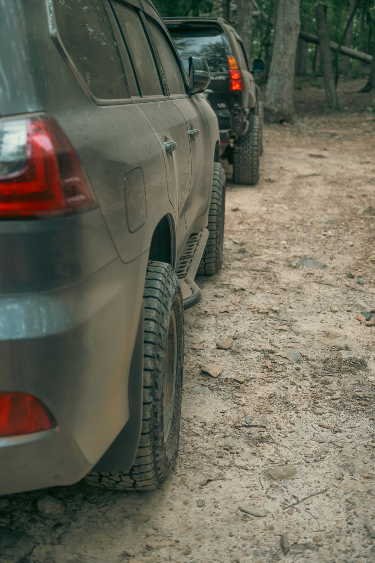

Kickout helps me climb on to get stuff off the roof rack, it doesn't stick out that far and it prevents other drivers from opening their doors into ours :)
You had me at "prevents other drivers door dinging me" . Very solid rig. thank you for the pic! Kick out it is....

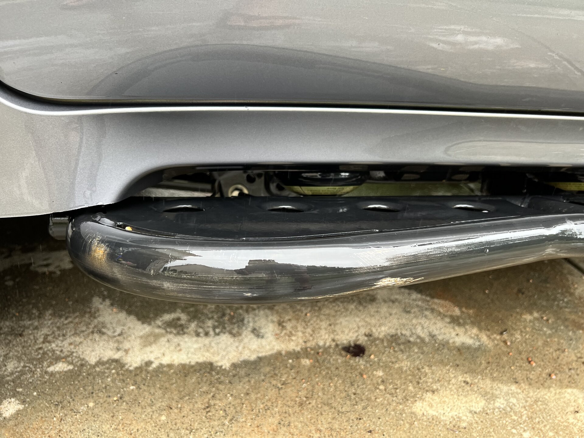

Kick out gives a bit more protection and an improvement over the stock side steps without, I think, much if added width…when you remove the stock side steps and add the slider, your toes can slide under the cab more…so even though these sliders don’t stick out further than stock (except right in front of the rear tire and even there only by a couple inches), they offer markedly more purchase for your feet when climbing into or o to the vehicle.
Pretty set on these. Do these give you a little more of a ‘step’ than the side steps on a LC200? Necessary for the littles. I’d be getting the kickout and the dimples down. They will weld them on.
They give a bit more step on the lx570 not because they stick out particularly further…but because there’s a deeper foot pocket…so your feet can kind of go under the vehicle a bit more.
With the oem steps (lx570), I would always turn my foot a little sideways when using the step because otherwise it was just a “ball of the foot/toe” perch…with these you can step on them in a normal manner-you don’t have to cock your foot sideways to make sure you have a safe purchase.

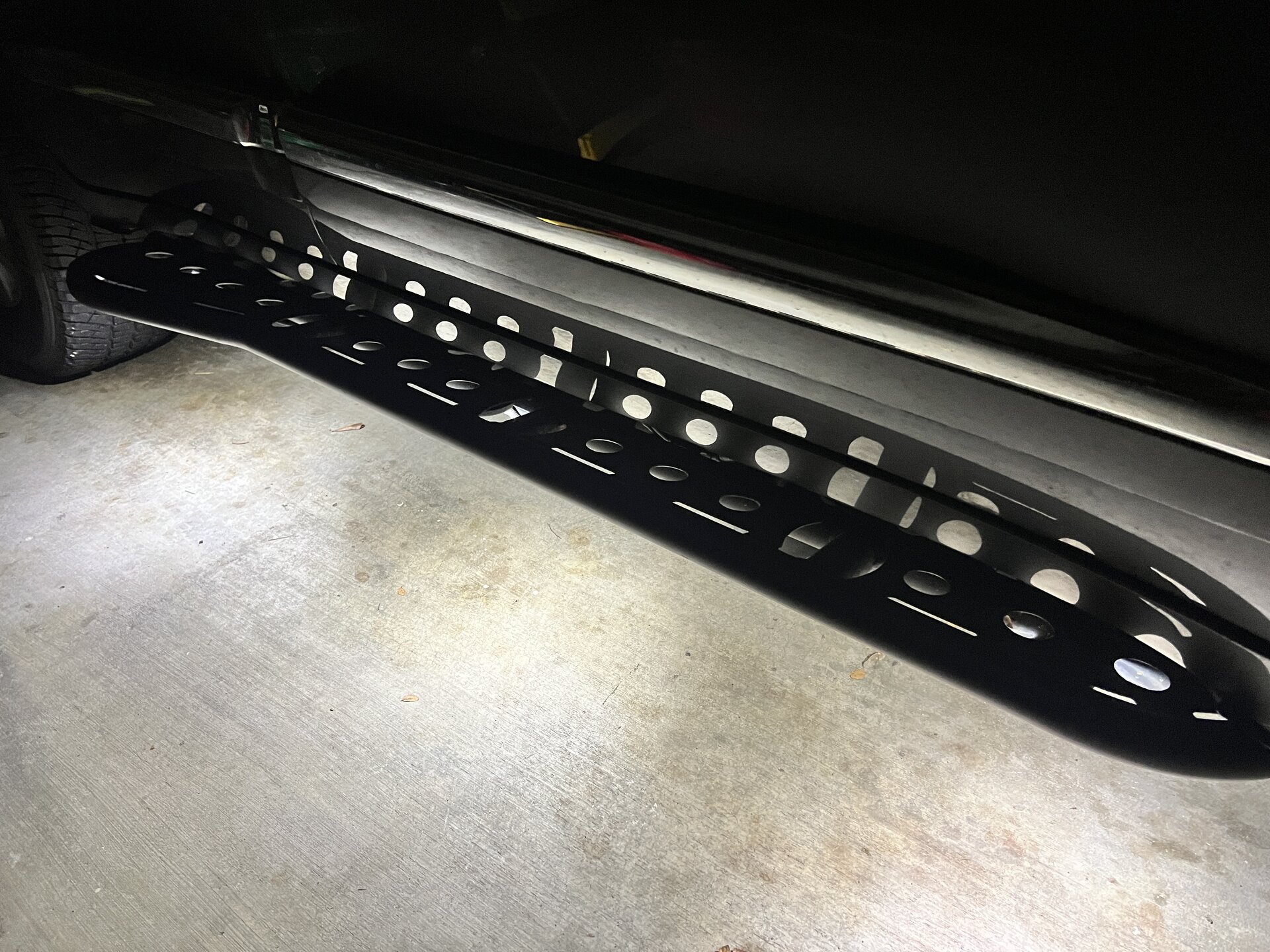

Then when you get them, you can spend hours getting your custom made wiring harness and magnetic lights adjusted just right, since you saved the wiring harness from the original step light. The better (said easier) option is to use an LED light strip rather than my PITA triple light wiring harness. I did dimple up, thinking it would help with slipping. 🤷🏻‍♂️
Looks good, so cut oem harness and install your own lights is your recommendation
Yes, I kept the original plug on the step side and made an overly complicated three rock light harness where each rock light has a strong earth magnet attached so that I could move them around. Instead, the single led strip (on AMZN) attached to the plug cut from the original wiring harness would have saved me hours.
