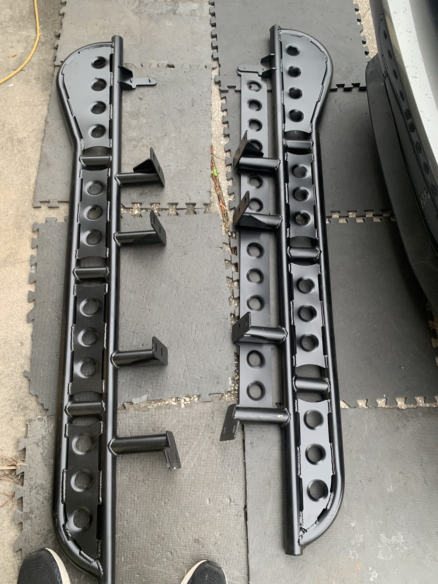

Tko makes sliders for an lx570.

The seller says these ship at 85 lbs. Considering how much plastic and metal I removed from the stock running boards, I doubt I’ve added a significant amount of weight to the vehicle.
Also, even with only a few fasteners affixed, I was still able to Jack the whole vehicle up using these sliders.

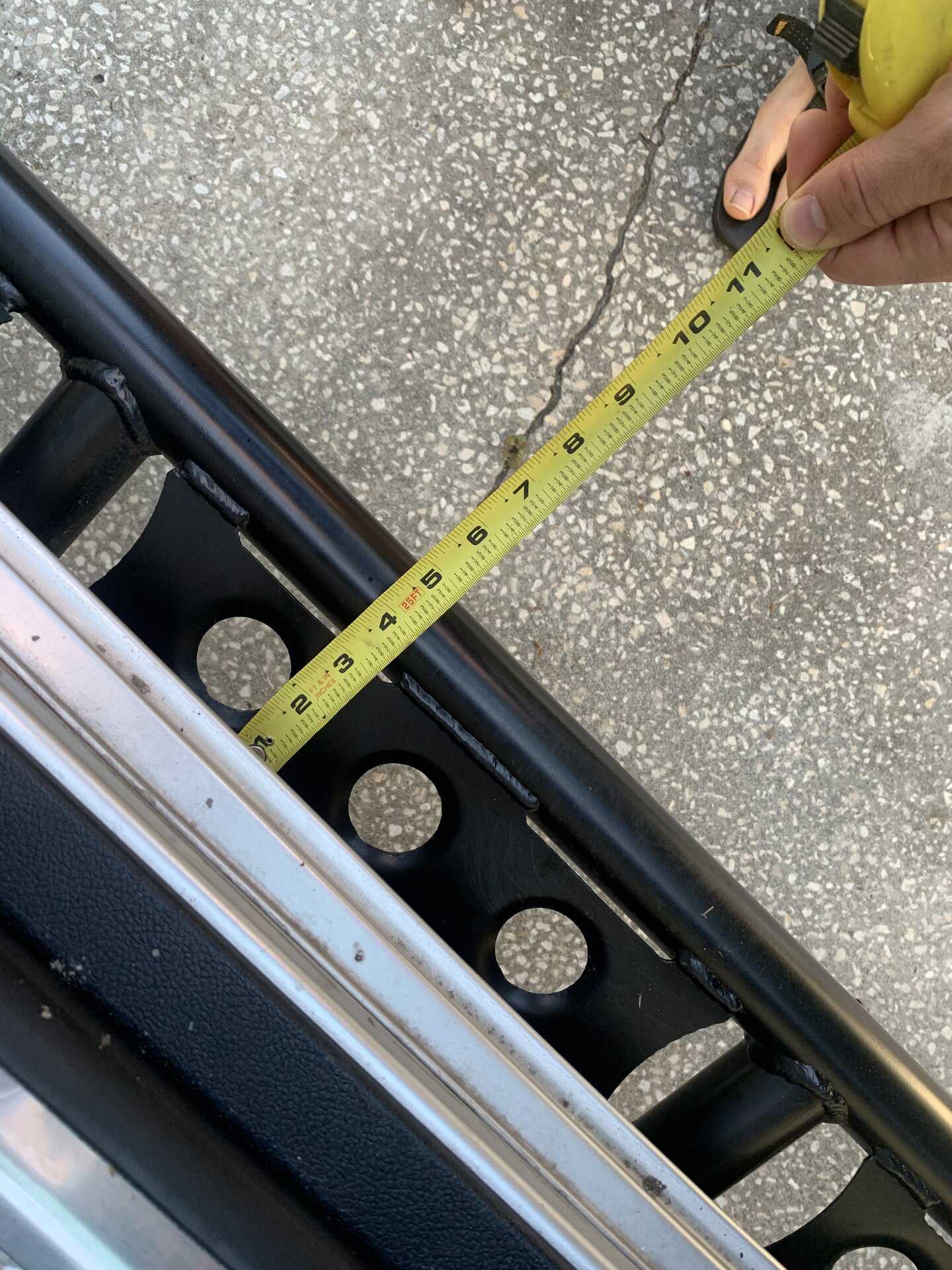

Can you take more pics fructose? Curious with the door open does it stick out enough to step on it and get in on the front part.
So sliders weigh like 85lbs together, the cage and running board we will be removing gotta be at least 40 lbs so this shouldn’t add on too much.

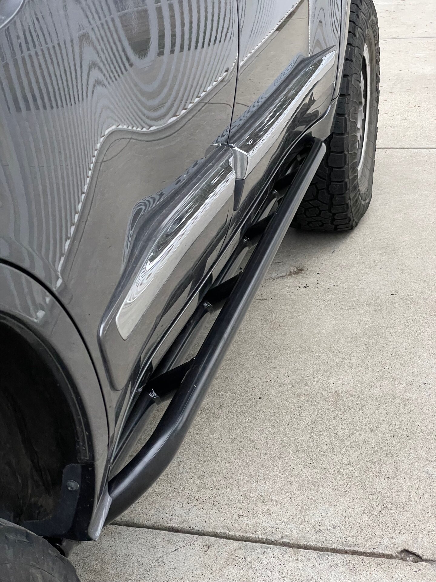

Due to the excess depth associated w being able to slightly tuck your feet under the body…you gain an easier entry with these vs oem.
Also, with the kick out in the rear it really helps w backseat access…as well as the obvious benefit of kicking your vehicle away from a rock/tree if you happen to end up to close

Anyone with the high-and-tight style have some good photos? Is it still possible to use them as a ledge or are they completely tucked against the bodywork?
