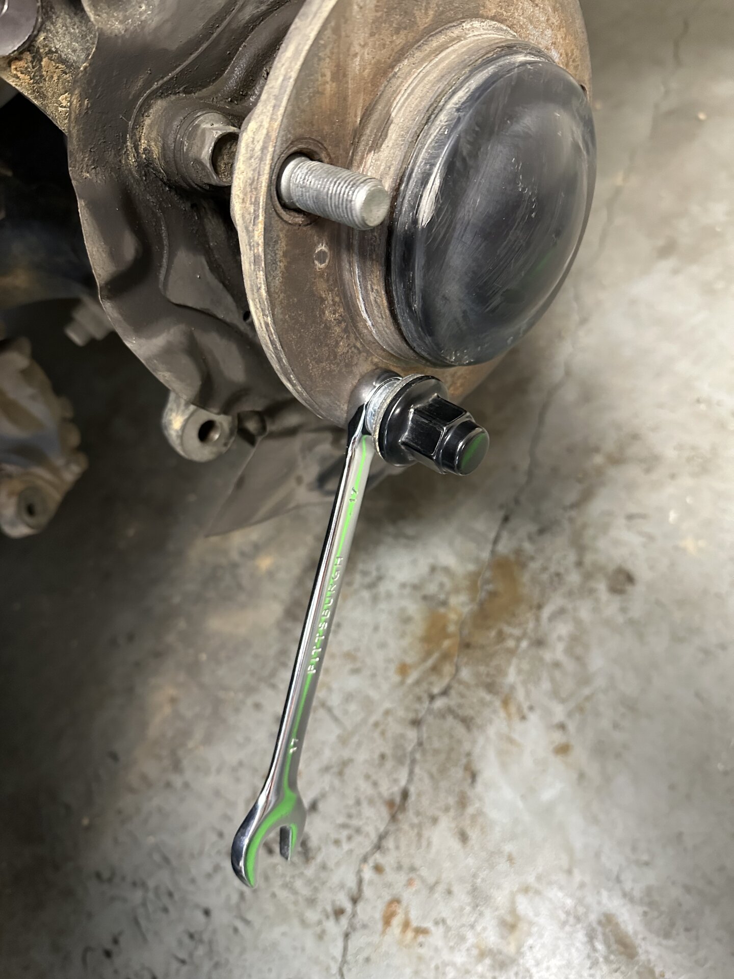

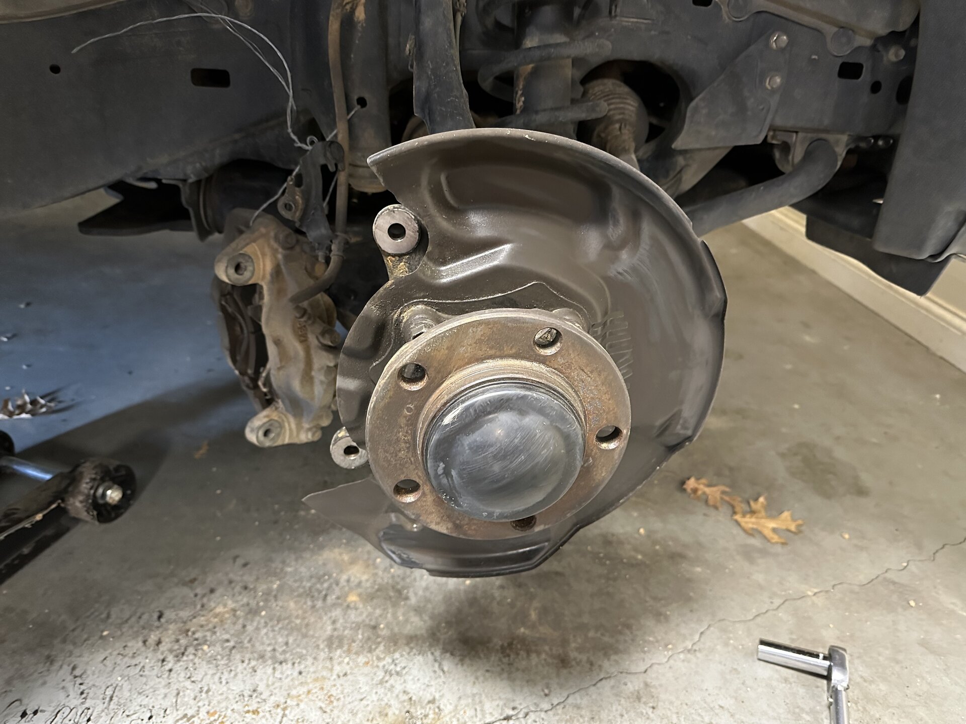

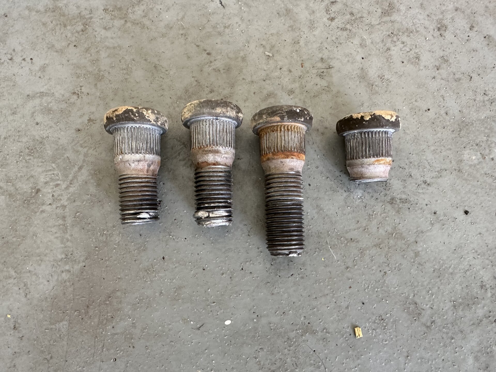

Replaced all 5 wheel studs on the Front Right wheel. I do all my own 5 tire rotations since I bought the rig, but apparently this wheel had a history of air guns over tightening before I bought it.
That’s not scary at all, guess I’m adding studs to my planned spring work.
It's really not a difficult job. Part numbers below if helpful. The OEM black lugnuts are super cheap compared to chrome. Might as well replace those too.
Part NumberPart NamePriceQuantityTotal
90942-02083Wheel Lug Stud (Left, Right, Front, Rear)$5.865$29.30
PT076-0C200-02PT076-0C200-02 Toyota Black PVD Wheel Lug Nuts Set of 5 - OEM$12.091$12.09

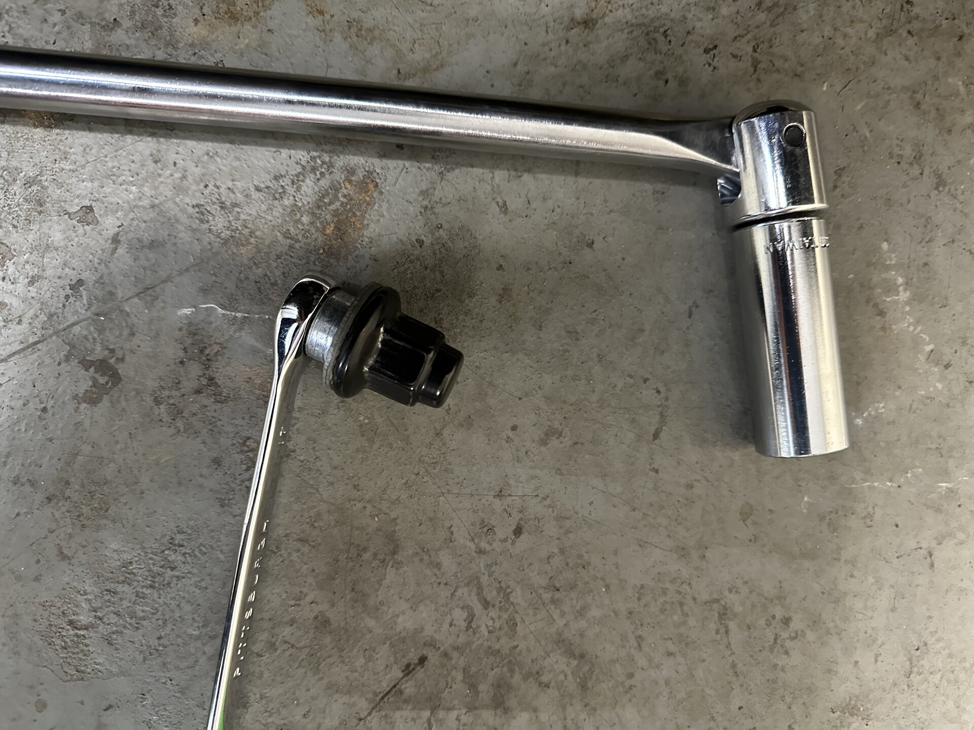

Tip when installing. Use a cheap 17mm wrench (or a big nut) as a 1/2" spacer. You want a big enough inner circle for the cone shape of an old lug nut to “seat” into, while the flat back of the wrench or big nut presses against the hub. Then use an old lugnut to "pull" the splines of the new stud into the week.
Yeah I’ve got a couple spare lugs and a lug installer/bearing in the tool bag. But proactively replacing is a new novel idea.

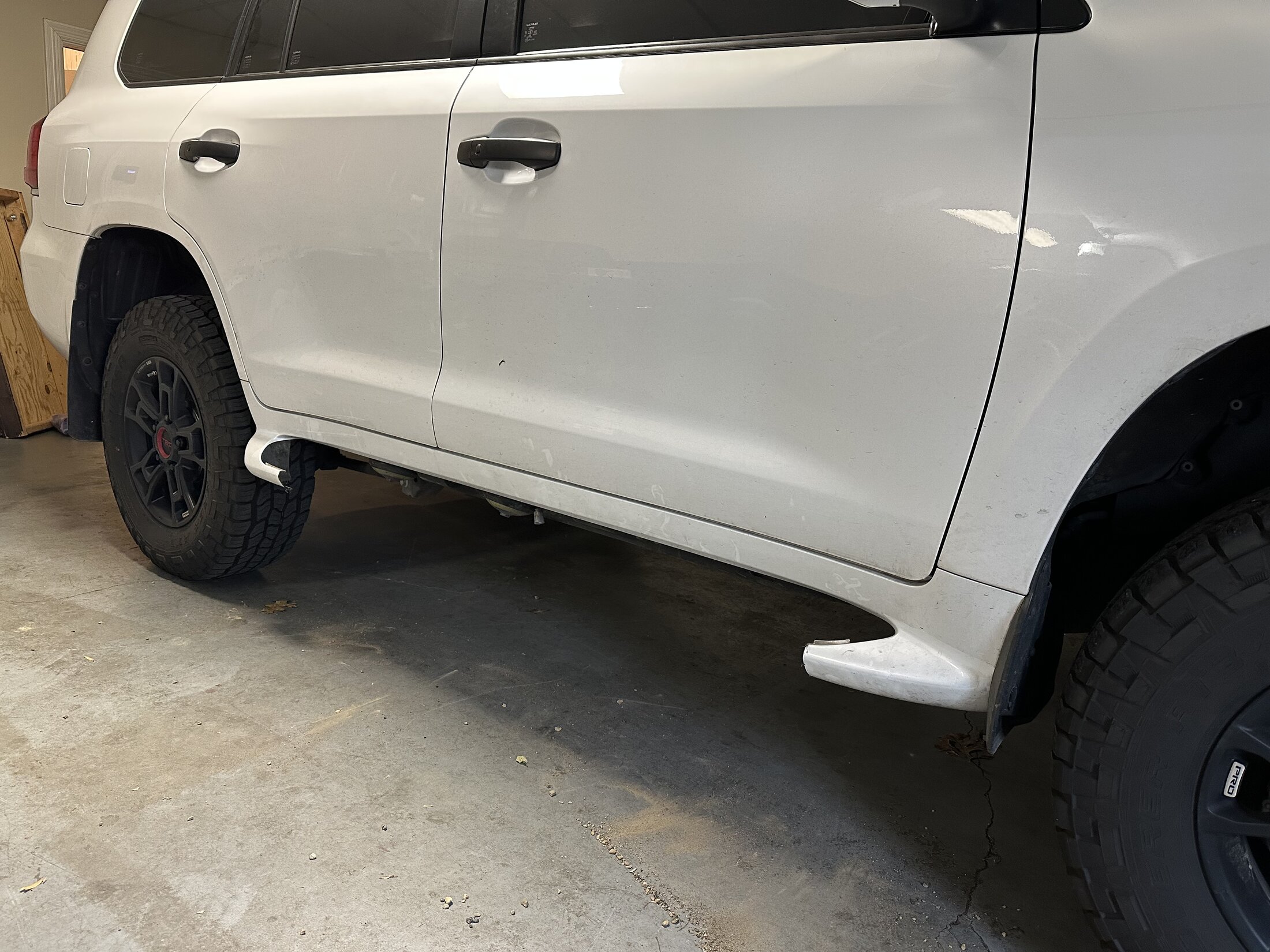

Forgot to update the build thread with my TKO fabrication slider install. I went with black powder coating + kickoff + dimple down.
A few scuffs as a result of UPS shipping, but they are built stout and I was able to install in the following timeframe:
- Removing LX570 steps: 45 mins
- Cutting the LX570 trim pieces: 30 mins (Actually takes 5 mins, but this is the step you want to measure 5x, cut 1x)
- Install TKO sliders using floor jack for extra set of hands: 90 mins
