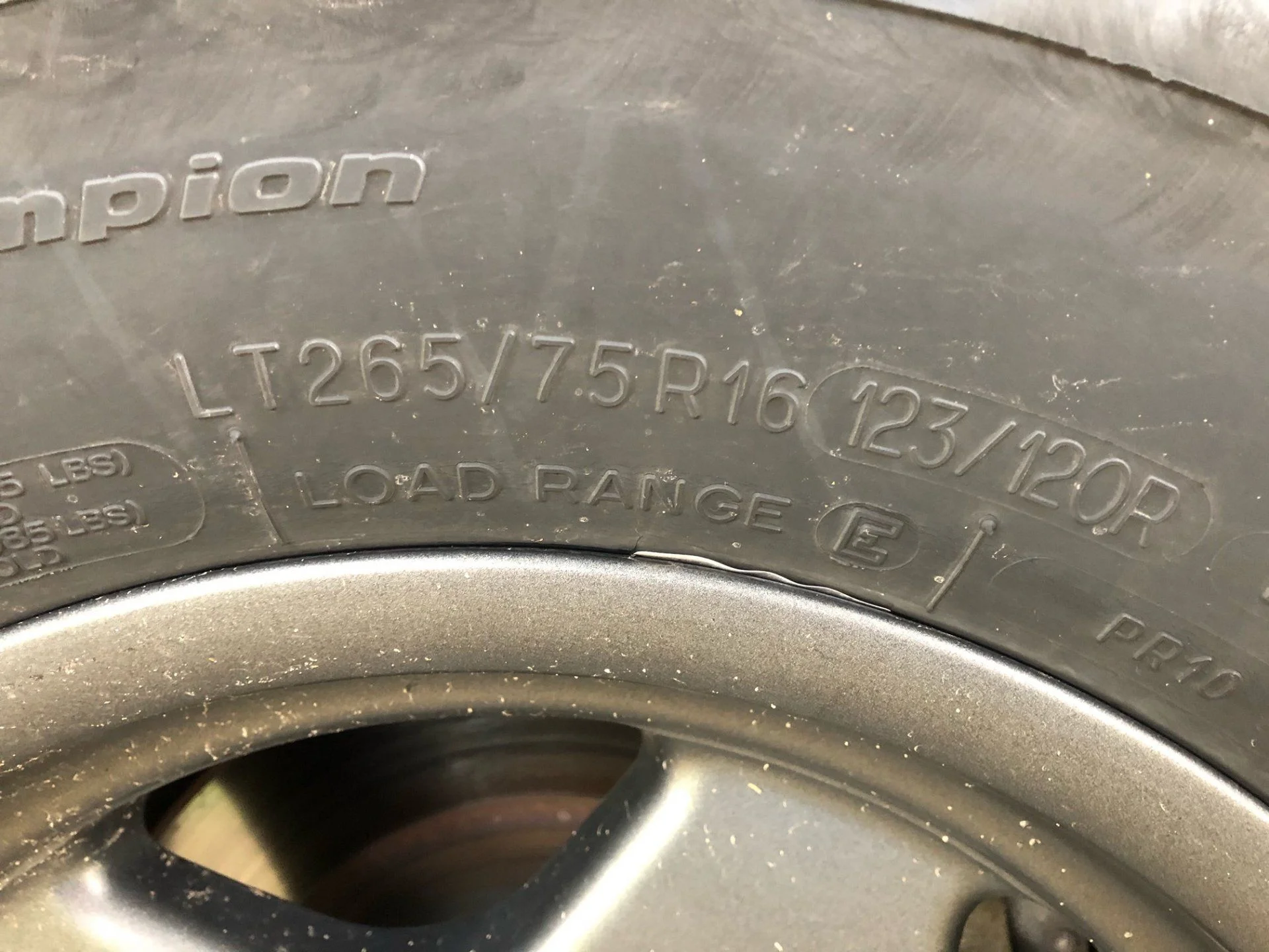

Will you tell me the RCTIP for a BF Goodrich All Terrain TA KO2 LT265/75R16 123/120R Load Range E on a 2012 Tacoma DCSB 4x4
Hopefully all the needed info is below.
Thank you!
The E Series BF goodrich tires tend to run heavy.
If you underinflate them, you run the risk of crappy fuel mileage and handling, if you’re overinflate them they tend to go bald in the center.
All of those recommendations are based on OEM P-series tires, not light truck E-Series tires.
Yep, that's why I'm asking Gaijin for the correct info. I posted the PICs of the stickers so he would see the OEM info. Several pages back in this thread he asked for that info from someone else asking a non 200 series question.
When I asked for this info earlier, it was for an Australian diesel 200 - so, still a 200 series.
I have avoided offering RCTIP for vehicles other than 200 series because it opens me up to much more research than I can comfortably handle in order to accurately answer all the questions.
In your case, however, since you have volunteered all the info I need, and you looked up the info for your LC200 all by yourself and saved me that effort, I will make a ONE TIME ONLY recommendation for your 2012 Tacoma.
The RCTIP for those LT265/75R16 tires on your 2012 Tacoma is 38psi Front / 41psi Rear.
NOTE TO OTHERS: Please, no questions about recommended pressures for vehicles other than LC200/LX570. Thanks.
HTH
