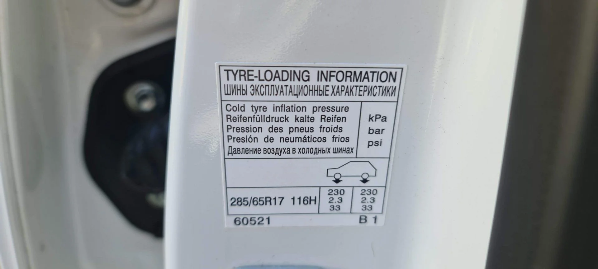

Sorry I couldn't help with your desire for a cushier ride, but let me share why the 46psi is the RCTIP:
Your stock 285/65R17 tires have a Load Limit of 2579 pounds. This is the amount of Load required of the tire to make the suspension system safe for your vehicle.
When replacing a non-LT tire with an LT tire, the Load Limit needs to be adjusted down by a factor of 1.1, this means that your replacement LT285/65R17 tires must have a Load Limit of at least 2345 pounds. At 46psi, your new tires exceed the requirement with 2379 pounds (45psi would be a little low, so rounded up to the nearest whole psi).
At 37psi, your new tires have a Load Limit of only 2041 pounds - not enough to safely meet the 2345 pound requirement.
At 42psi, you're better off at a Load Limit of 2229 pounds, but still not enough to safely meet the 2345 pound requirement.
Stay safe.
