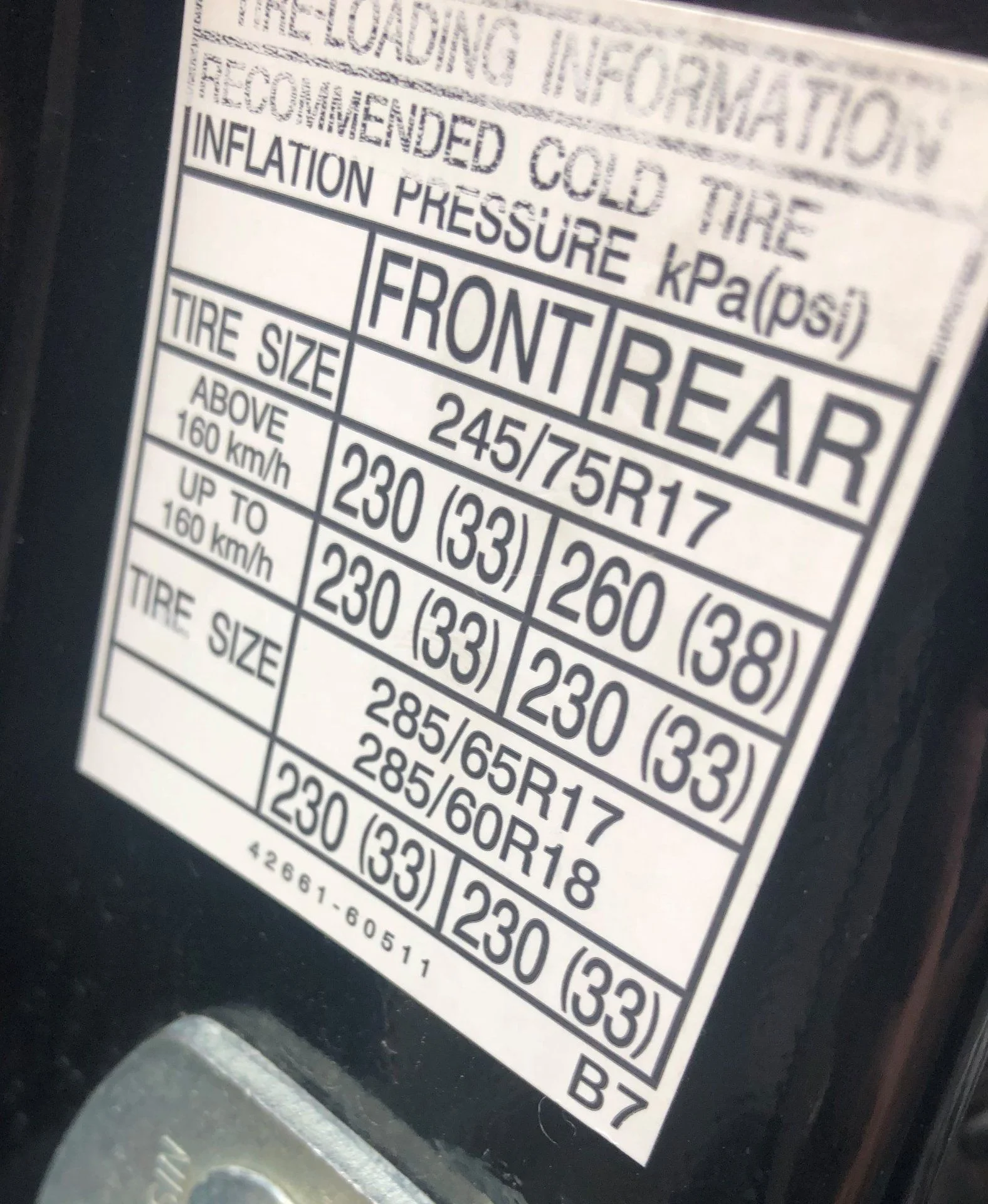

Maybe because my door label says to run at 33, the tire shop guy filled it 33.
Did a skim through this thread and wanted to confirm the recommended cold tire inflation pressure is 41PSI on a '21 LC200 for both of these tires?
