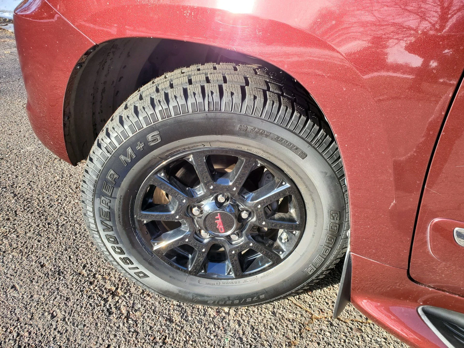

1. 2014 LX
2. Cooper Discoverer M+S 275/65 R18 (Not LT)

1. 2014 LX
Thanks !
Well... this is an interesting one. The Cooper Tire web site does not list the Discoverer M+S in this size (Cooper Discoverer M+S on Cooper Web Site ). Discount Tire only list the LT-Metric version (Cooper Discoverer LT275/65R18 at Discount Tire ) which does not give me the info I need for your size. Tire Rack does not list any Discoverer M+S tire in your size (Cooper tires on Tire Rack ).
As such, I cannot confirm any tire pressure recommendation.
If you look on your tire sidewall and can determine the following two three tire specs, I can give you a conditional recommendation:
1. Load Index (will be on the tire as something like "116T" "114" etc.)
2. Standard or Reinforced Load Rating (will be on the tire as "SL" "XL" "Reinforced" etc.)
3. Max Load at Max Inflation Pressure (will be on tire as "Maximum 2750LBS @ 45PSI" or similar
Without further info, I cannot proceed.
Yes, interesting that TireRack doesn't carry the Cooper Discoverer M+S.
Copper Discoverer M+S Studdable
275 /65 R18 116S SL - Max Load 2756 Lbs. Max Pressure 44 PSI
my local Discount Tire matched the DiscountTireDirect $, as you would expect, and ordered them in. They were $127 last week.
https://www.discounttiredirect.com/buy-tires/cooper-discoverer-m+s-studdable/p/27856
Thanks again.

Great! Thanks for the info - all I need.
The Recommended Cold Tire Inflation Pressure for the 275/65R18 116S SL tires on your 2014 LX570 is 30psi F/R.
HTH

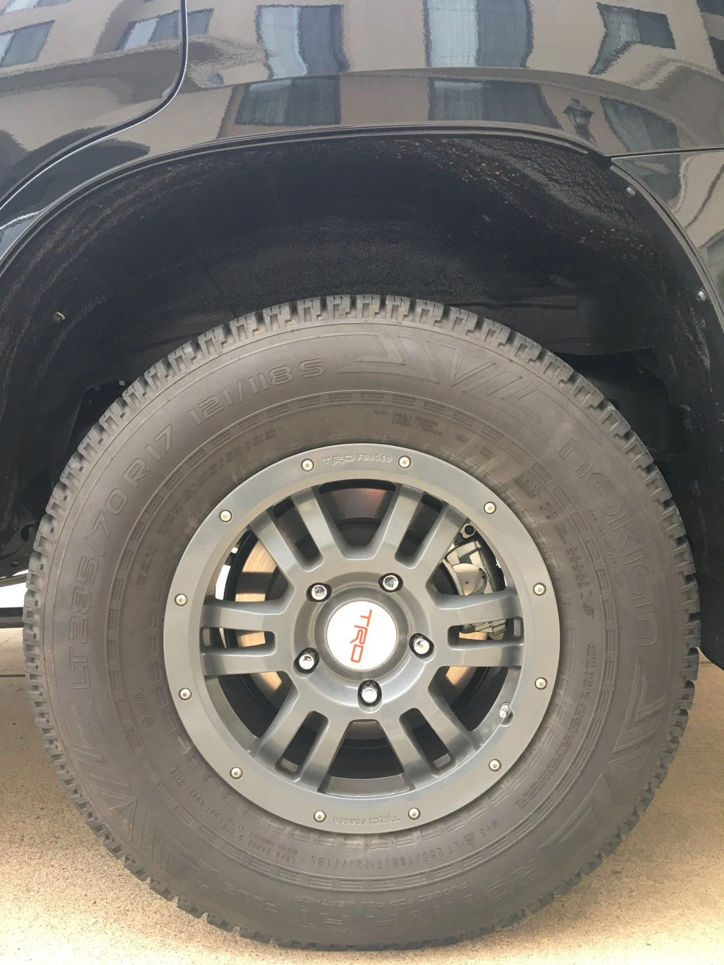

Greetings Gaijin,
I am running 40 psi in my Nokian Rotiva AT plus 285/70/17's load range D. Could you please tell me if this is correct? TIA!
Greetings Gaijin,
I don't know - too much confusion and too many unknowns :hmm:
You say you are running, "285/70/17's load range D" tires, but your picture shows LT285/70R17 - are you right or is the picture right?
There is no "Nokian Rotiva AT plus 285/70/17's load range D" tire listed on the Nokian site, only LT285/70R17 - are you right or is the Nokian site right?
Do you have a LC200 or an LX570? RCTIP is different depending on which you have.
So... help a brother out and lend some clarity to the situation.
TIA
TIA
Sorry for the lack of info. Yes LT 285/70R17, the picture is right. Running these on a 2020 LC HE. Thank you.
Then yes! The RCTIP for the LT285/70R17 tires on your 2020 LC200HE is 40psi Front/Rear.
HTH
