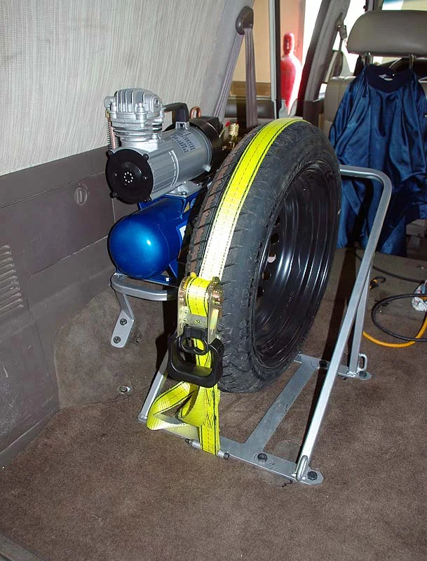

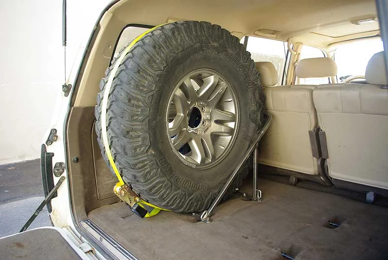

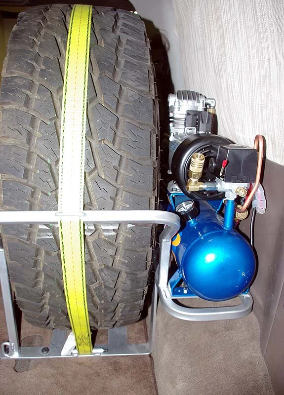

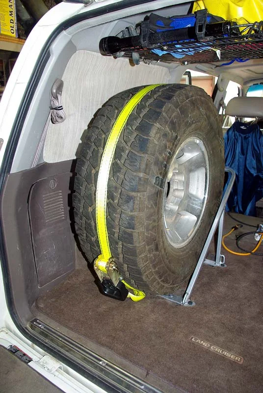

They bolt to the factory holes, no body drilling (the rig must have 3rd row seat bracket holes). The spare rolls in from the back, is held in place by the ratchet strap, no need to unload cargo to get it out. Holds spares up to 37", as big as will fit in the hatch. Is designed to hold a Puma compressor or the shelf can be made longer/different to hold other things. Can be somewhat customized to fit the need.
