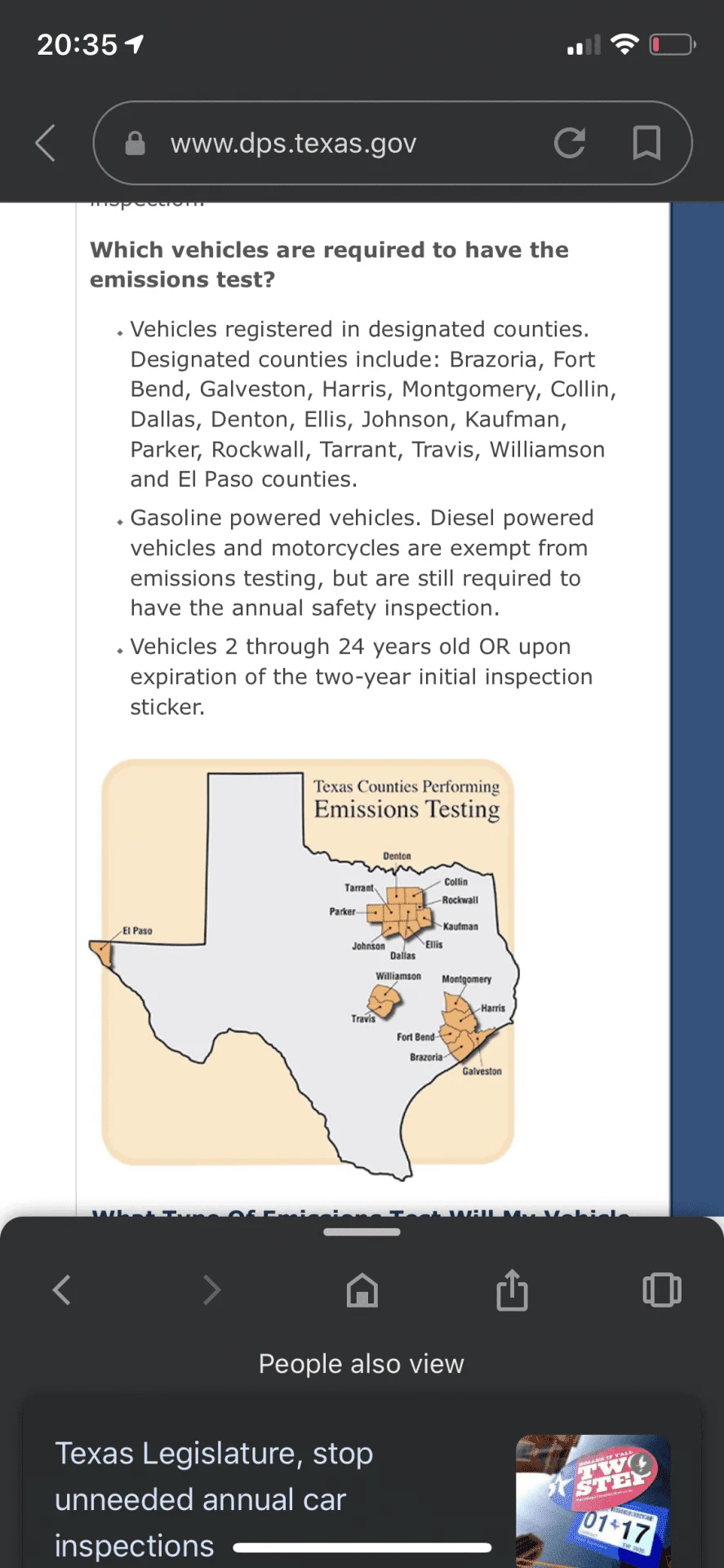

Dunno but according to DPS site it’s 24 and only 17 counties that do emissions testing.

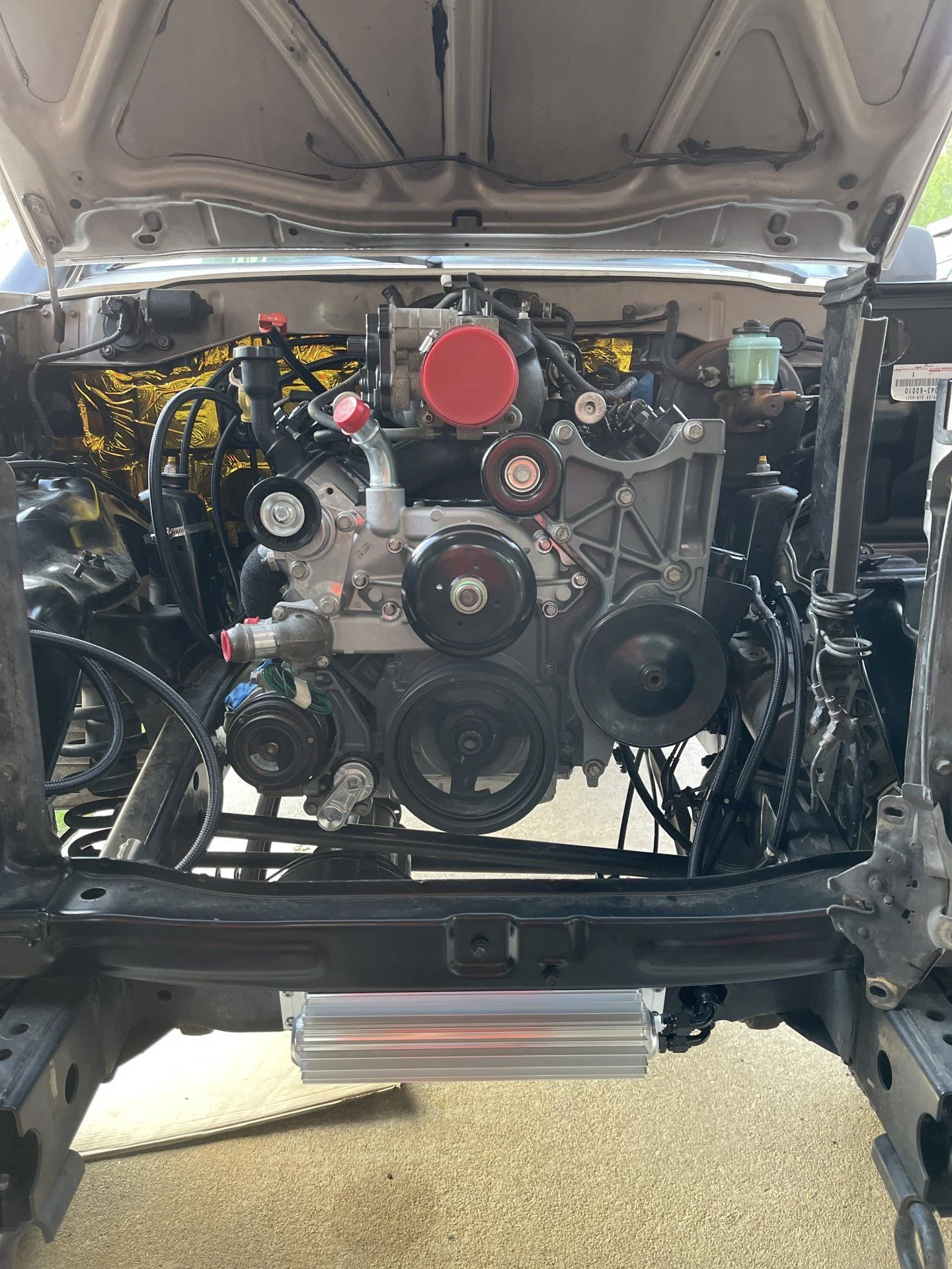

Sorry for such a hiatus. Working from home with a 1st grader and two younger ones makes it challenging to work on the rig. Here’s where I’m at..
Motor is in woohoo 🙌🏾. Power steering plumbed, just need to add clamps to low side line. I tried my hand at making some 6AN PTFE lines. We’ll see how it holds.

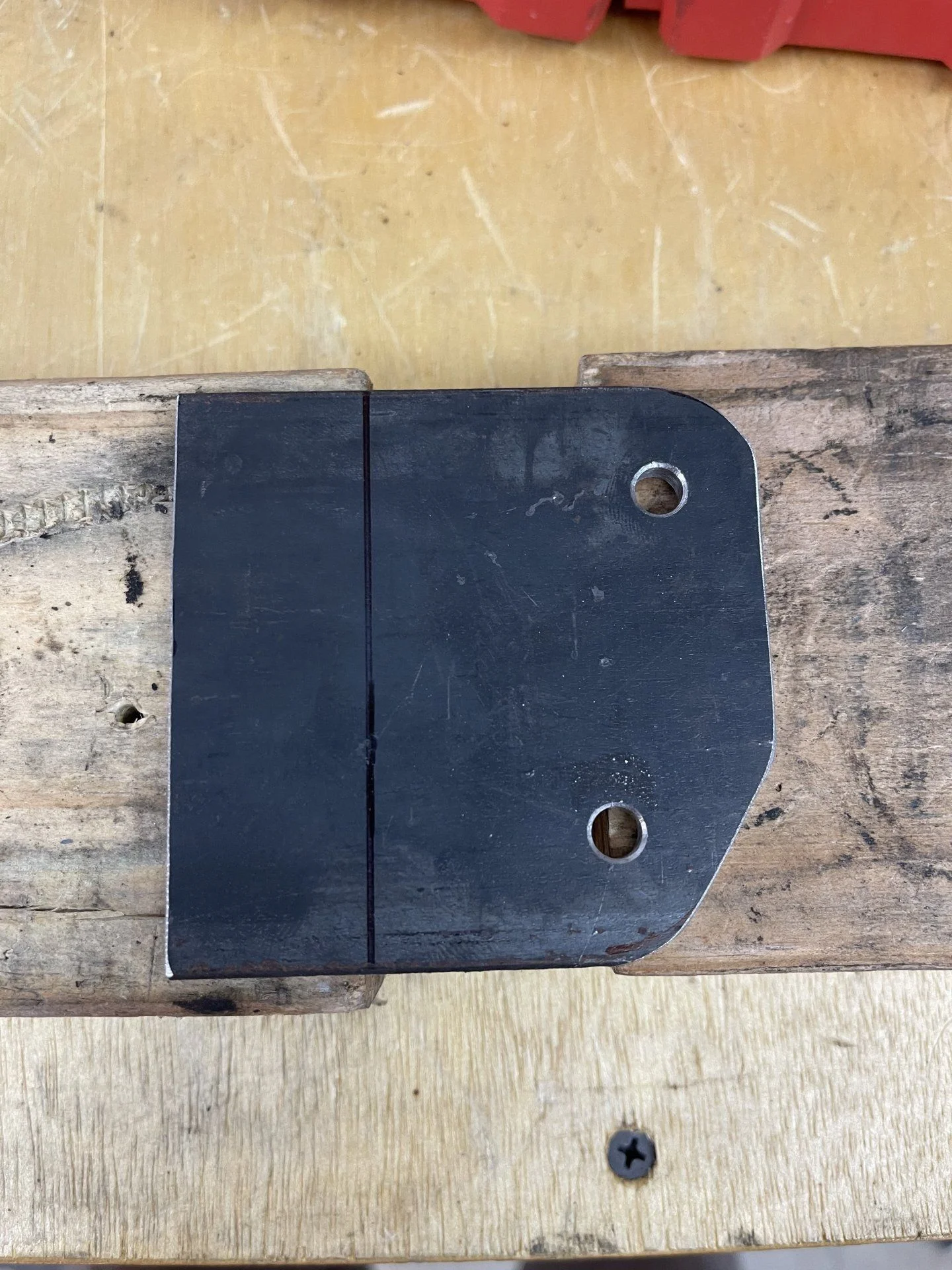

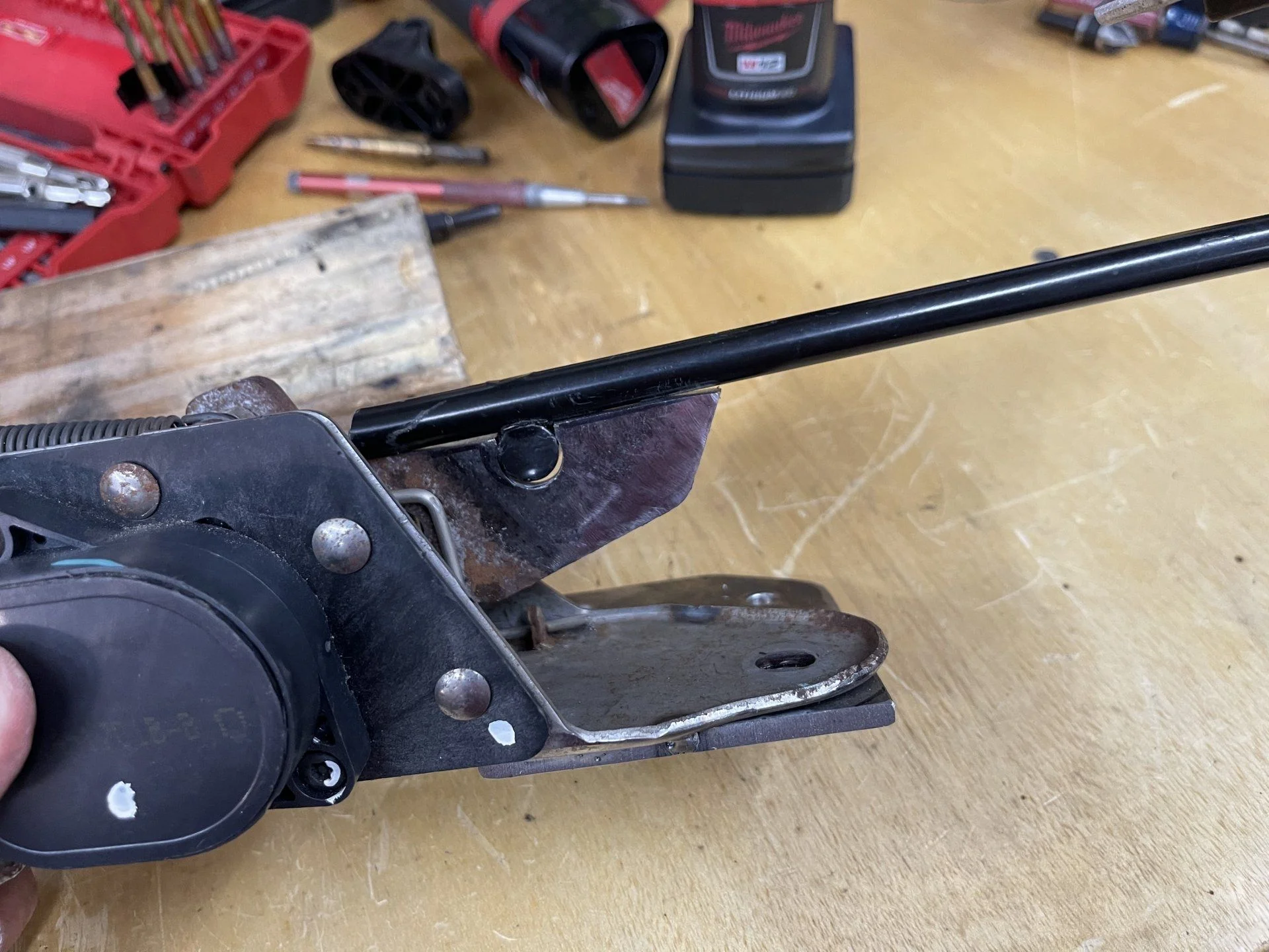

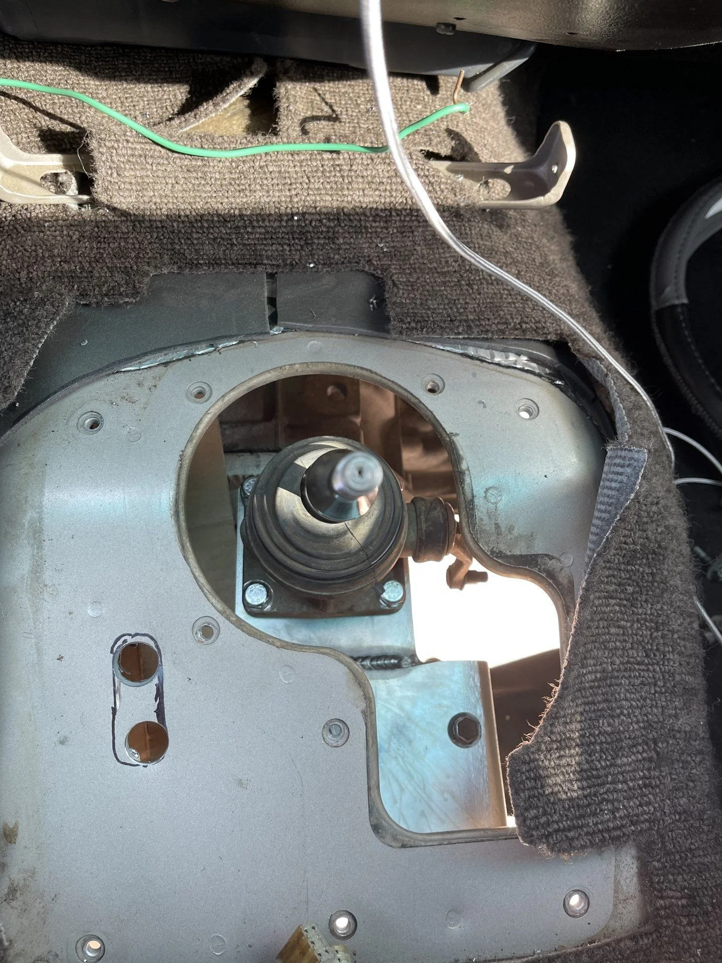

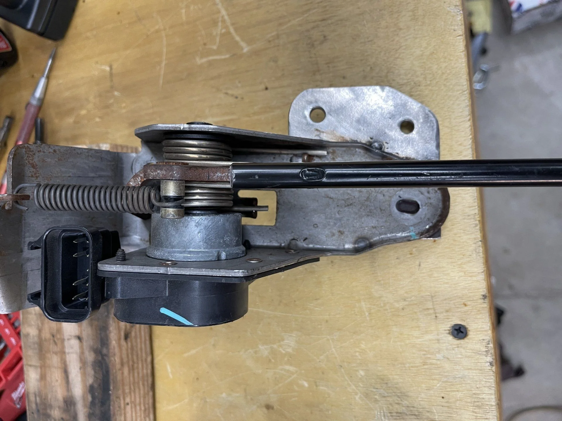

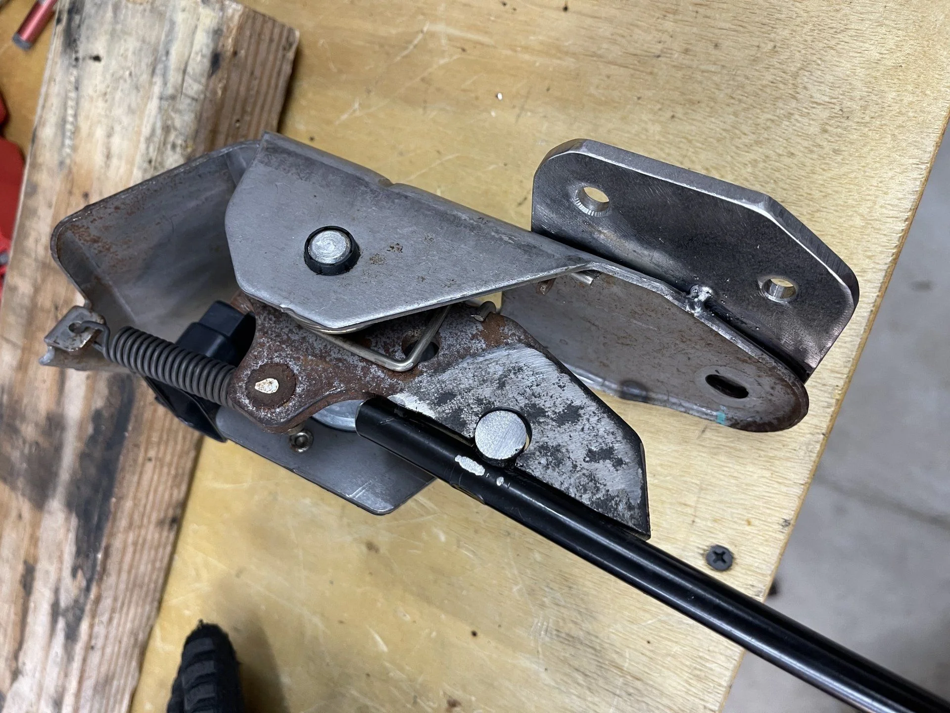

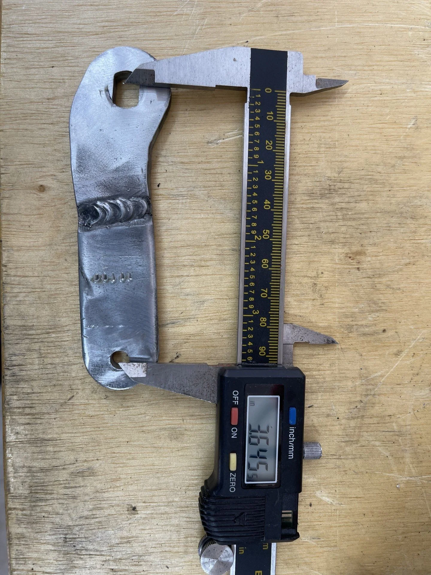

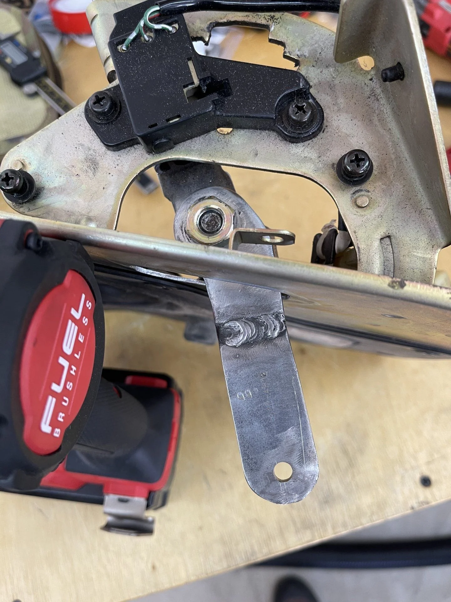

Need to modify the shifter and make a bracket but it doesn’t seem too difficult so long as I keep that distance from center to center 3.65” on the shifter arm.
Engine bay has been painted and firewall got the DEI gold treatment
Currently running fuel lines. Got a question though.... return hard line is smaller than 6AN... so did some of y’all run 6AN return all the way back from filter or run regular rubber line to hard line? I wanted to make it look nice while I’m in here.

I ran -4 for the return line.

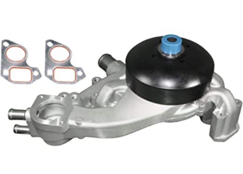

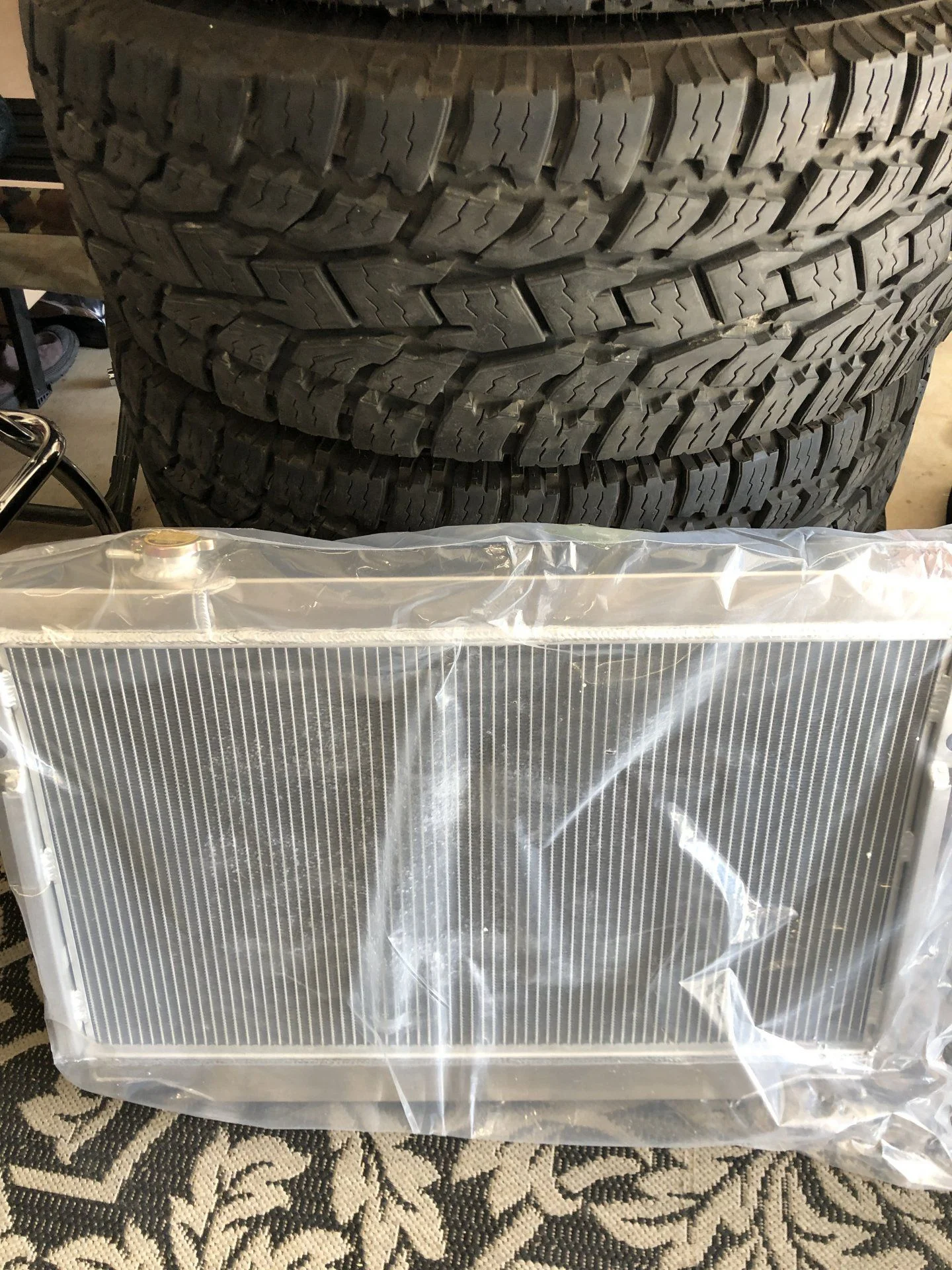

Also, as a heads up... I much prefer the placement of the Gen 4 upper water neck. It puts the rad hose way out of the way of the intake piping.
Thanks for the tip. New water pump setup came in and on the engine. Like the output much better. Had to order a new thermostat housing and thermostat... although they look very similar, it’s a very small difference in the mounting holes of the thermostat housing.
part number?
