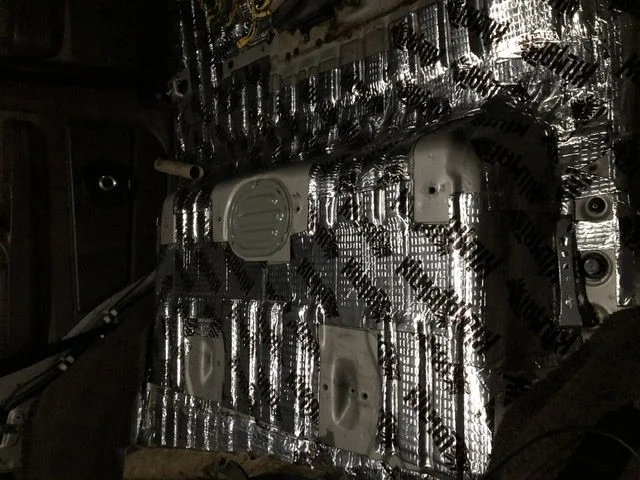

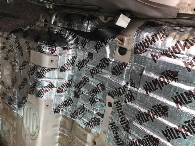

Just a little update... interior gutted and been working on adding sound deadening and closed cell foam layer on top of that. Area behind second row seats done and working forward. Doors next.
Question... good time to remove heater under passenger seat?

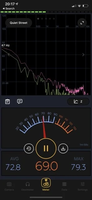

Interior all buttoned you and cleaned... it was pretty nasty as PO spilled soda or coffee. It’s all clean now. Entire floor and rear quarters has a layer of kilamat and noico sound deadening with a closed cell foam layer on top. Doors getting the same treatment but after the engine swap. So far it’s made a difference.

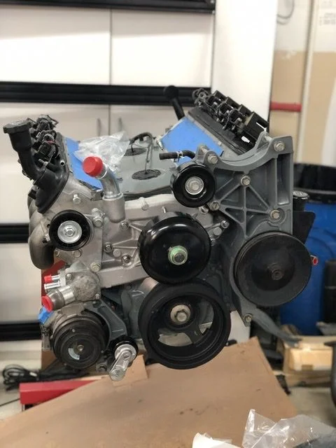

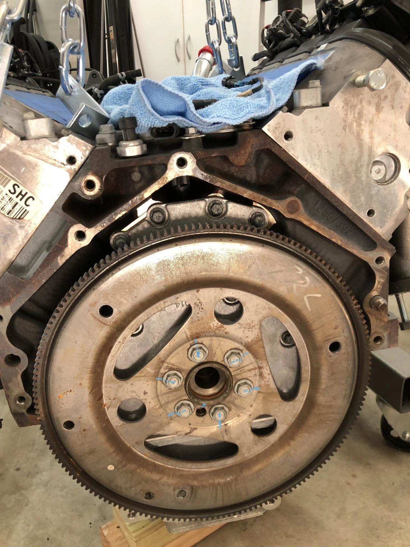

Accessories back on so motor can be fitted between the frame rails. It’s going to happen soon.. real soon.

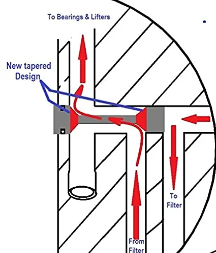

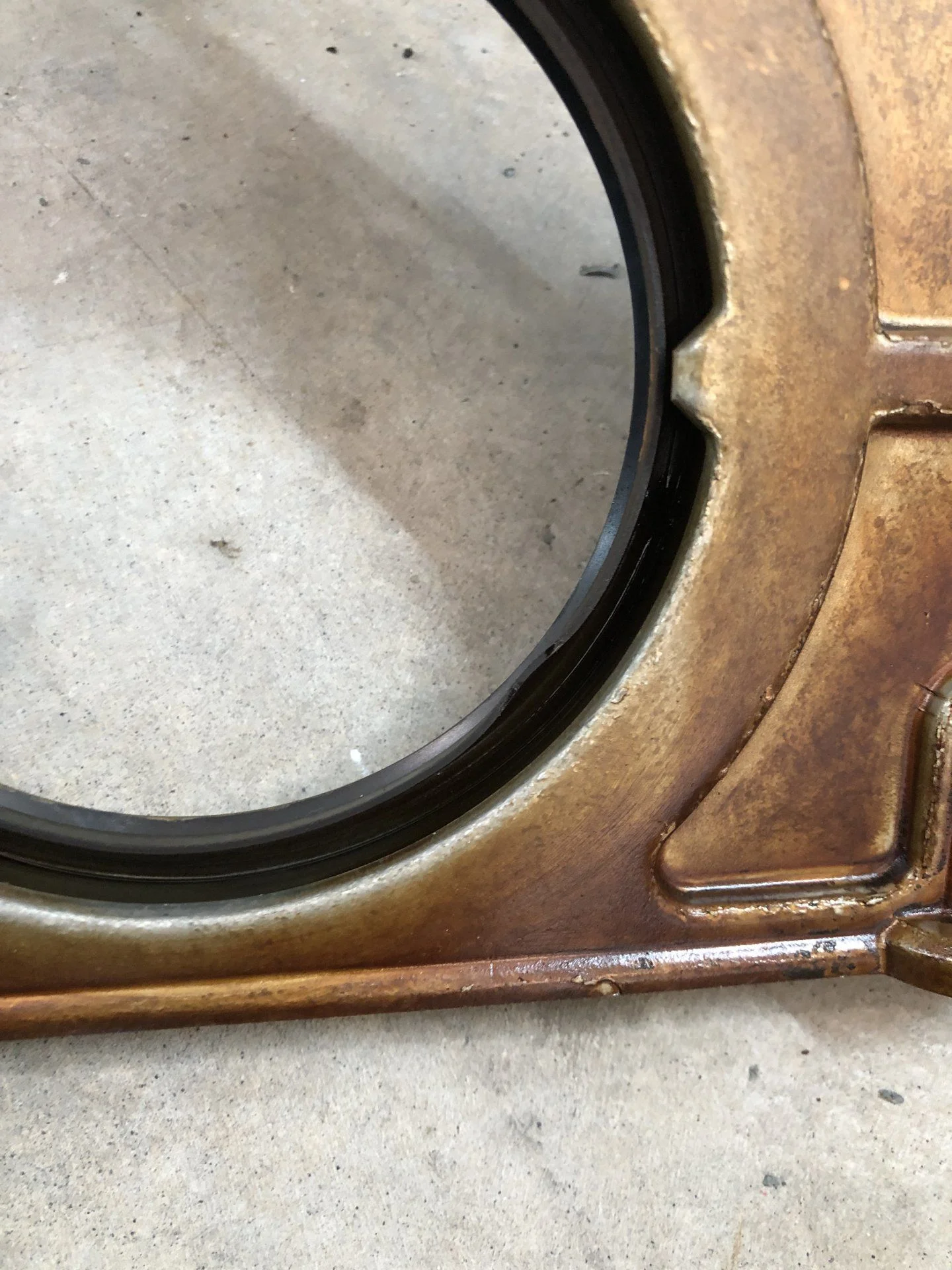

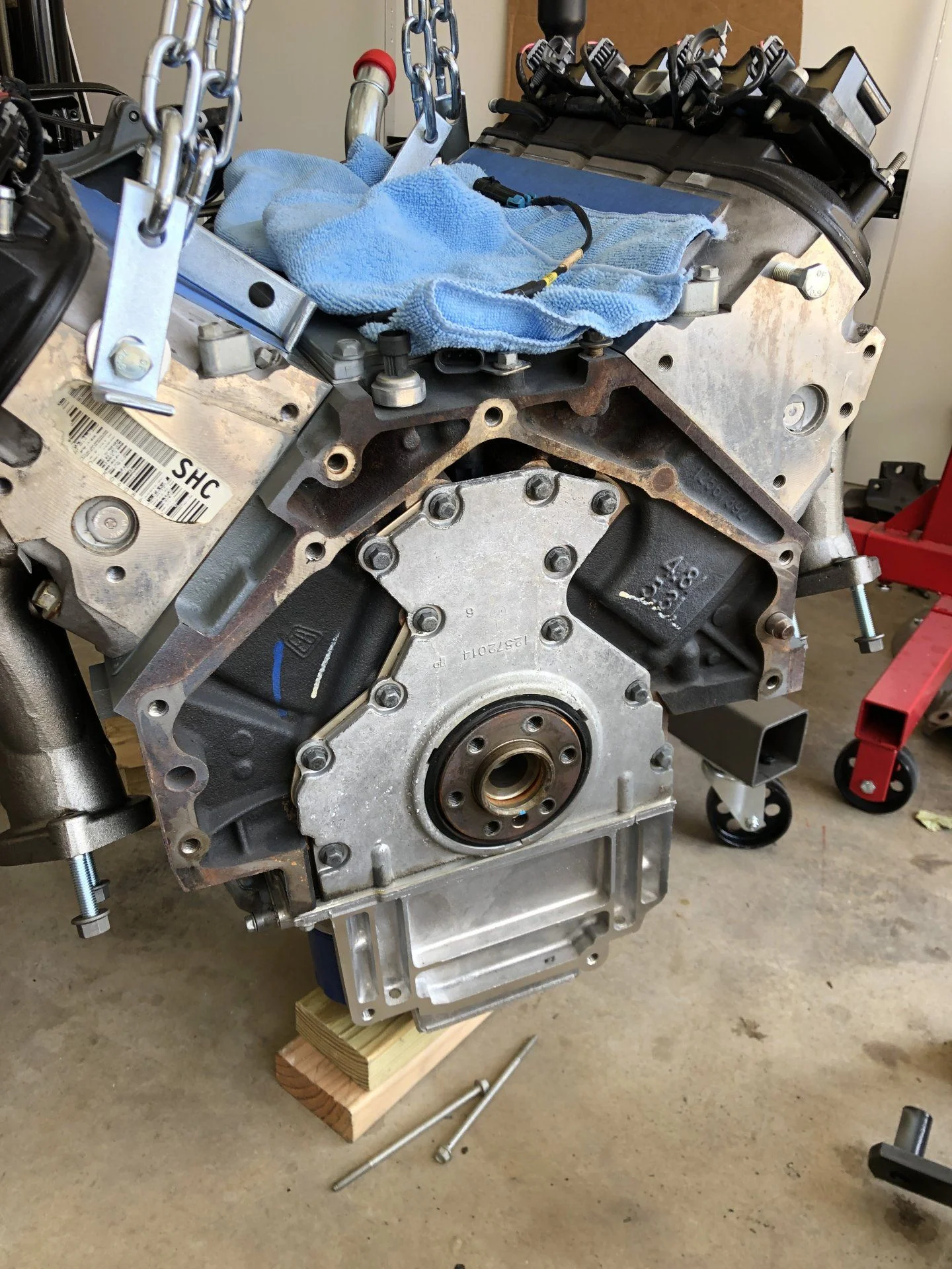

What is the oil Barbell?
its in the back of the engine block, behind the rear main cover, from factory they are plastic with an oring, lots of good stainless and titanium ones, it effectively acts a oil galley plug to divert to the oil filter, IF you don have one or if it starts to pass it means oil goes through with out being filtered , it than allows oil to come from the filter up to your bearings and lifters.....
its actually a really really really important part that people over look.....

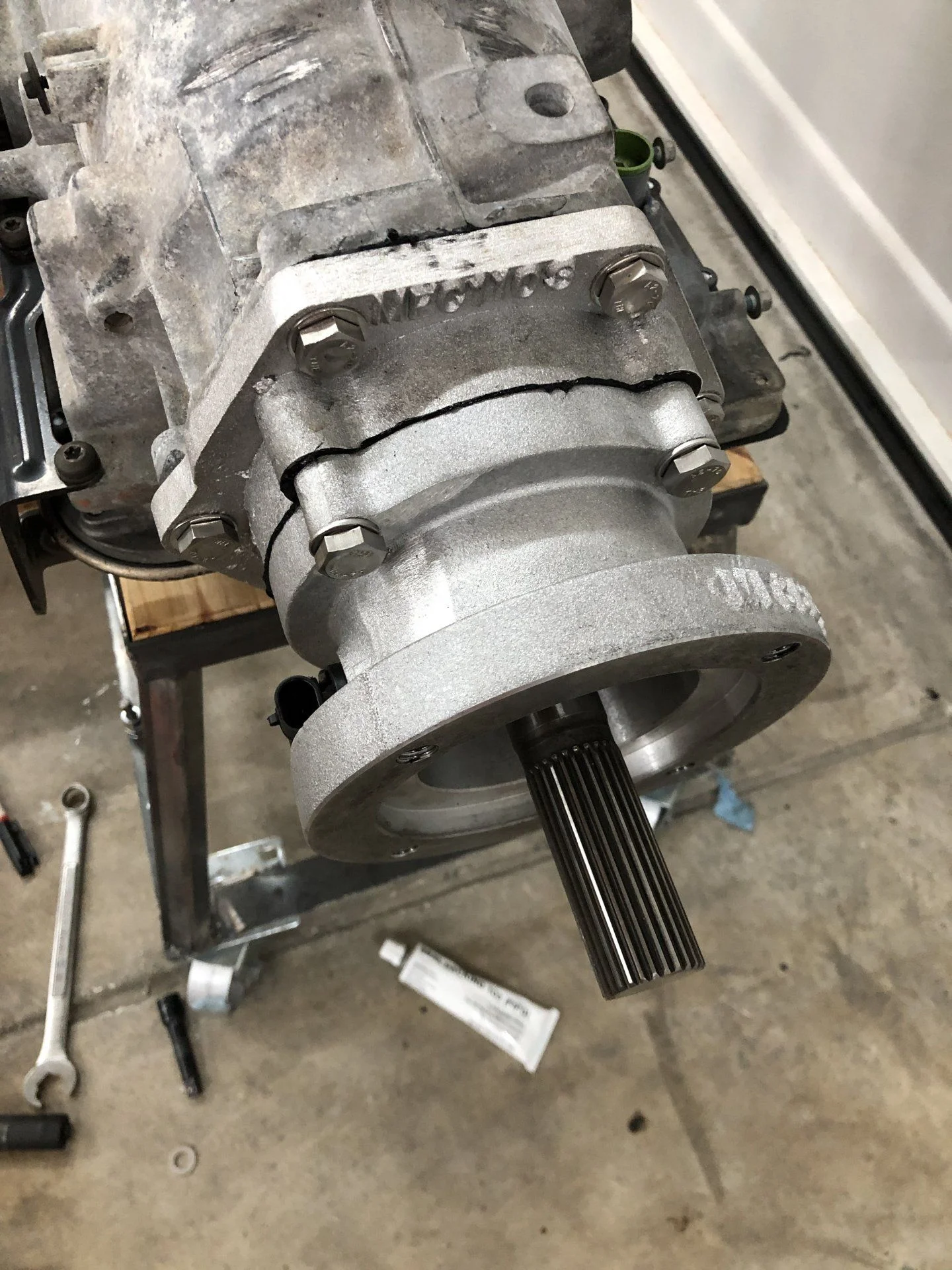

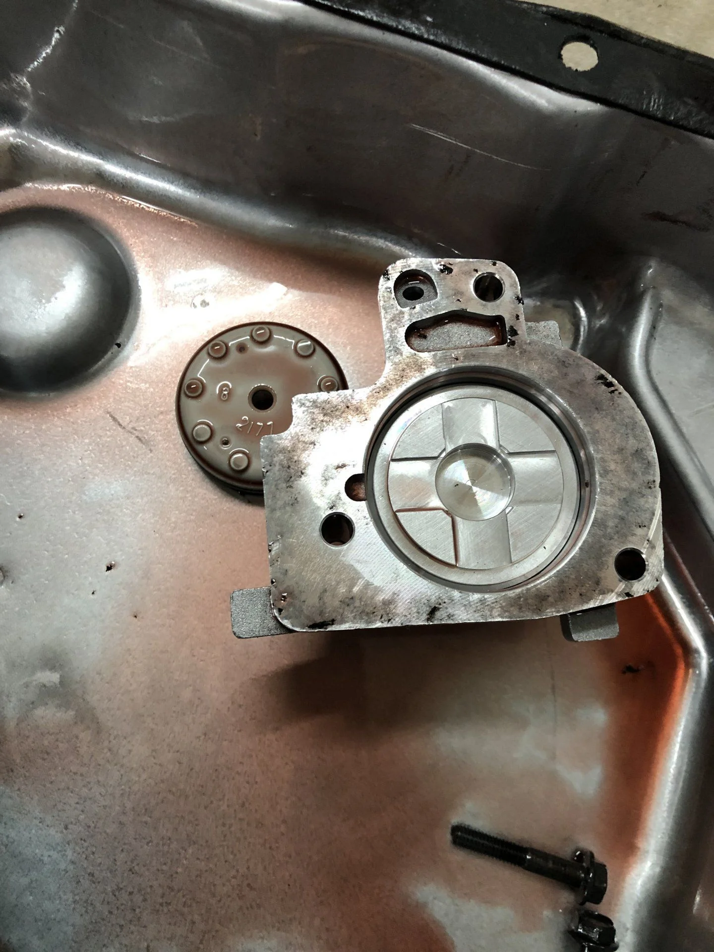

Got around to install the sonnax 4l60e accumulator piston kit. So what this does is in GM units, it is common to have poor shift quality, burnt bands or clutches due to accumulator piston wear. Easy install but the last thing to do on the trans. Now I can mate it back to the engine.
