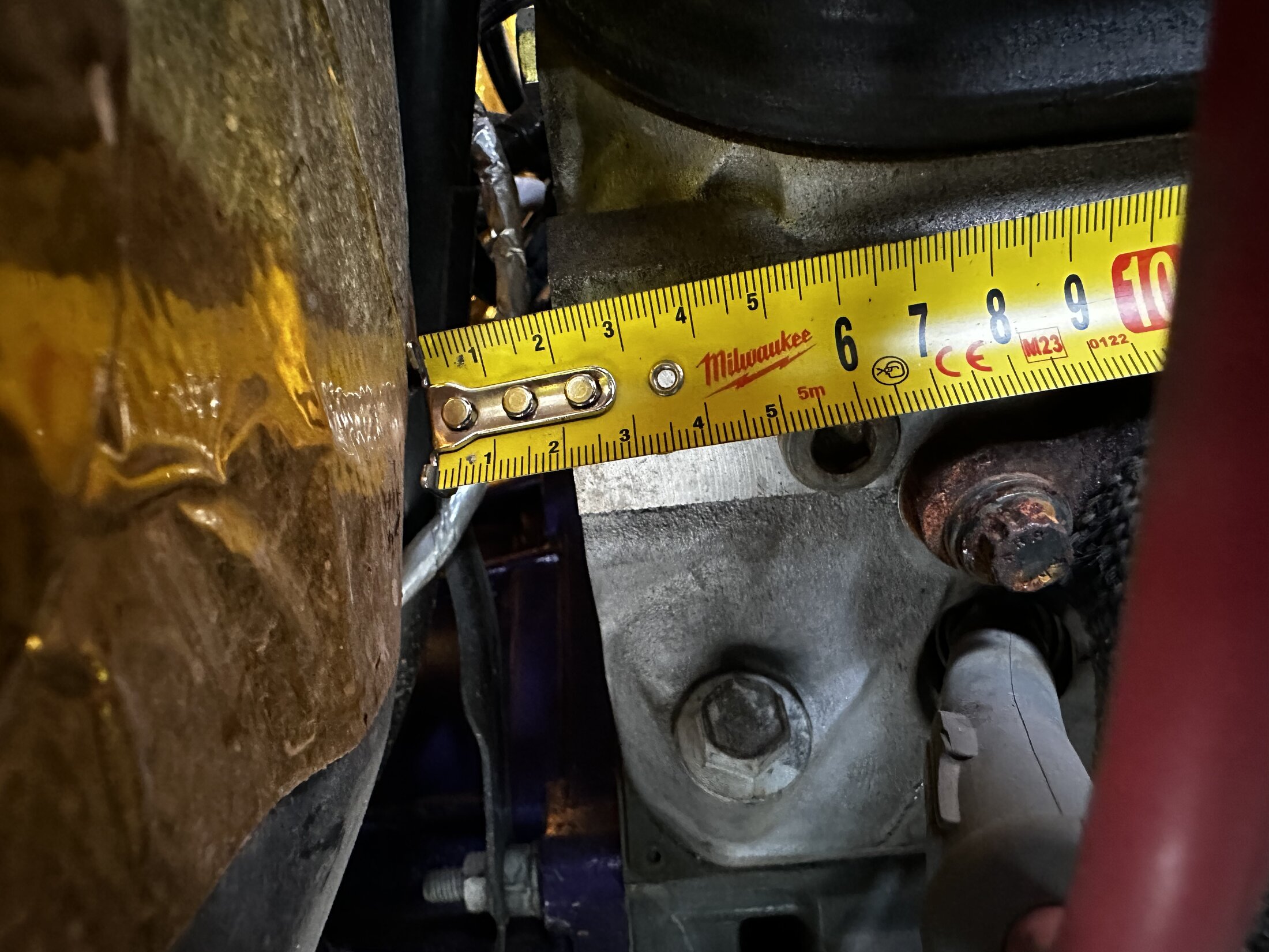

How much room do you have between the passenger side head and the firewall? I'm at 8-10mm clearance!
Thanks
Thanks
