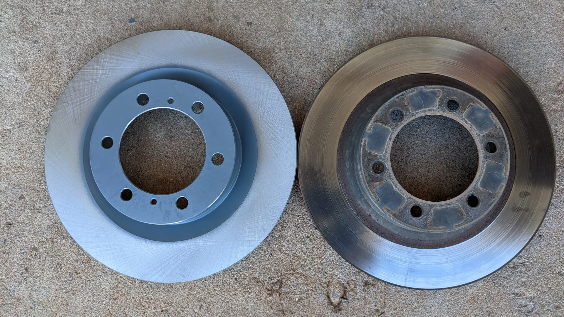

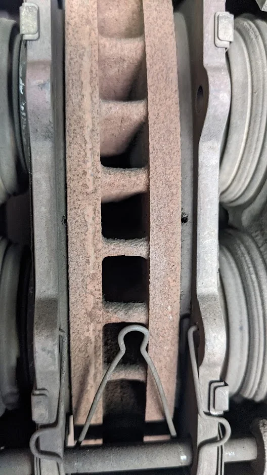

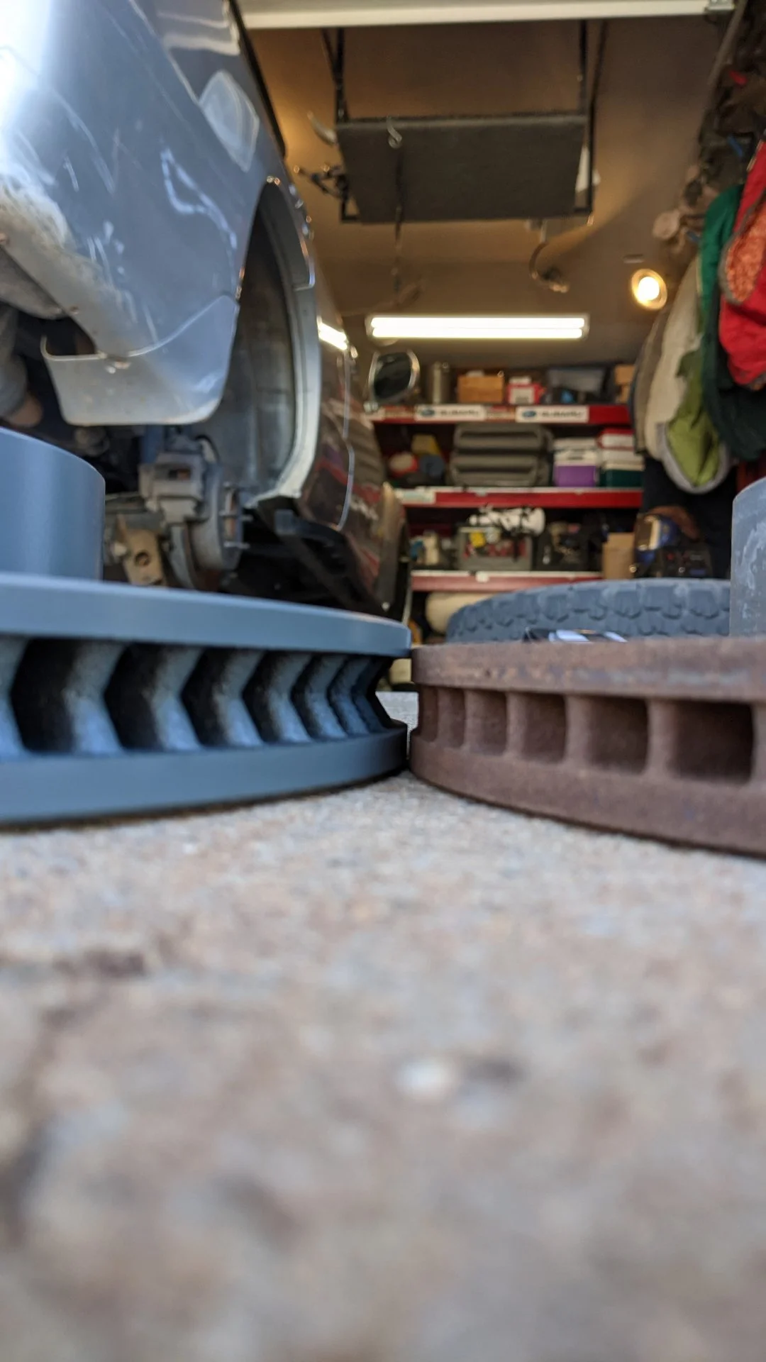

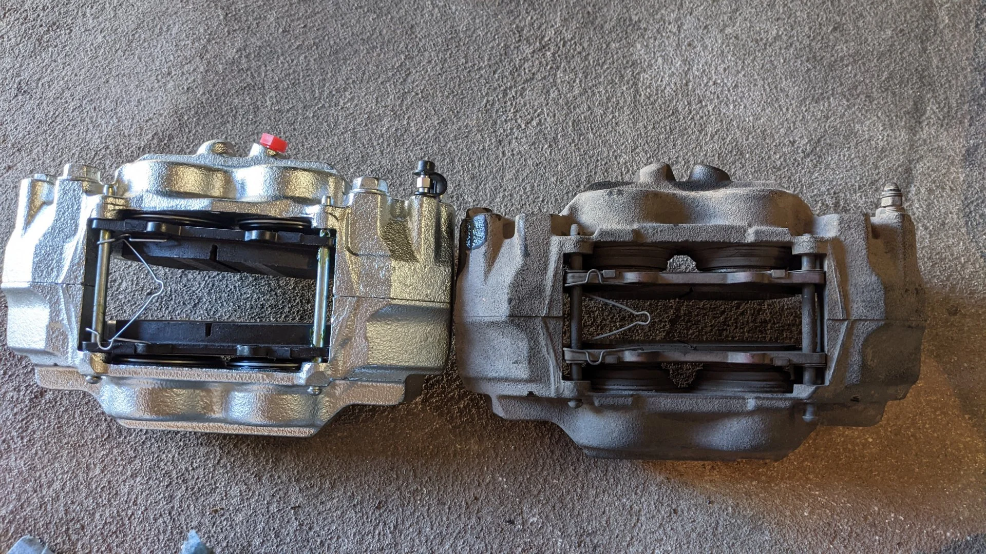

Question: So, the 460 rotor is a little thicker than 470 rotor, but there's no diameter difference, right? Since 460 and 470 use same pads, is the only caliper difference accounting for the thicker rotor?

It's a fair price. Yeah, the 460 rotor is thicker due to more caliper. That is why they hold up so well to 470s.
So I am looking into this also. The 470 and 460 calipers are identical except for maybe 460 are a little wider to accommodate the rotor.
But wont the 460 caliper have stuck pistons also if they are identical besides width?
You need to get 460 rotors with the 460 calipers, right?
