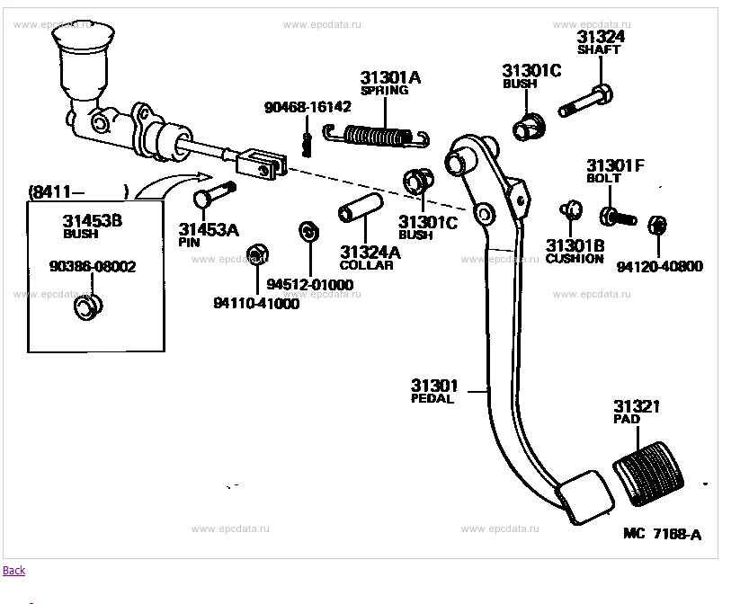

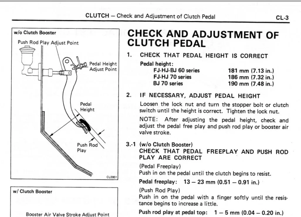

Do you have the return spring at the pedal? Are you making the correct adjustments to pedal height and free play?

Yeah when I bring free play back in the squeal comes back. If the free play is set to what FSM calls for it squeals. Springs are all good around the clutch pedal. I have played with that a lot. I can decrease to no free play and it disappears but the clutch isn’t happy like that. So I pretty much can’t get around changing it I guess. But now since I plan on dropping the trans I have tacked on possible other to do’s while it is out. Rear main seal maybe. I don’t know that I can do a transfer case rebuild in a weekend alongside the bearing change but thinking on it.

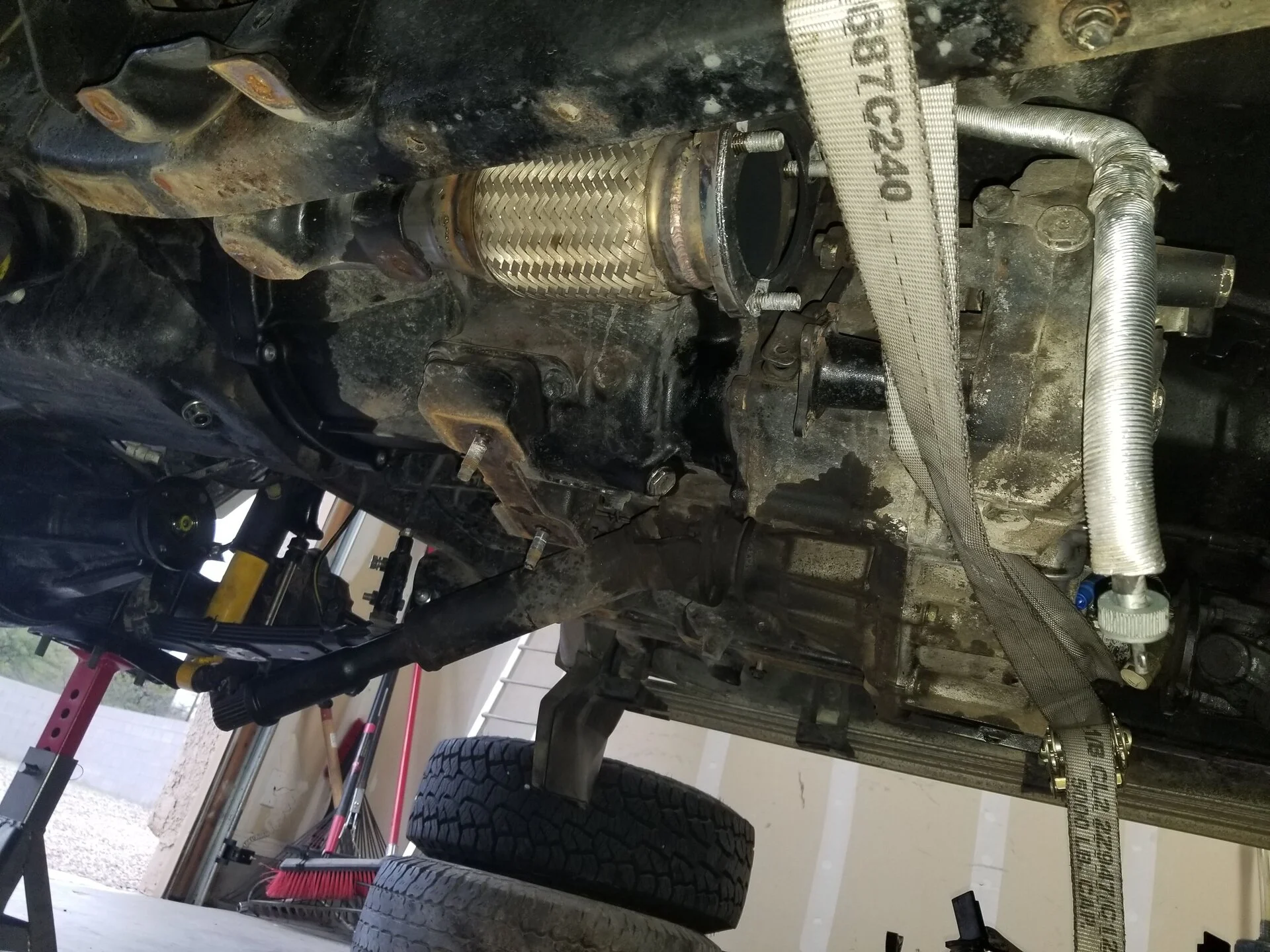

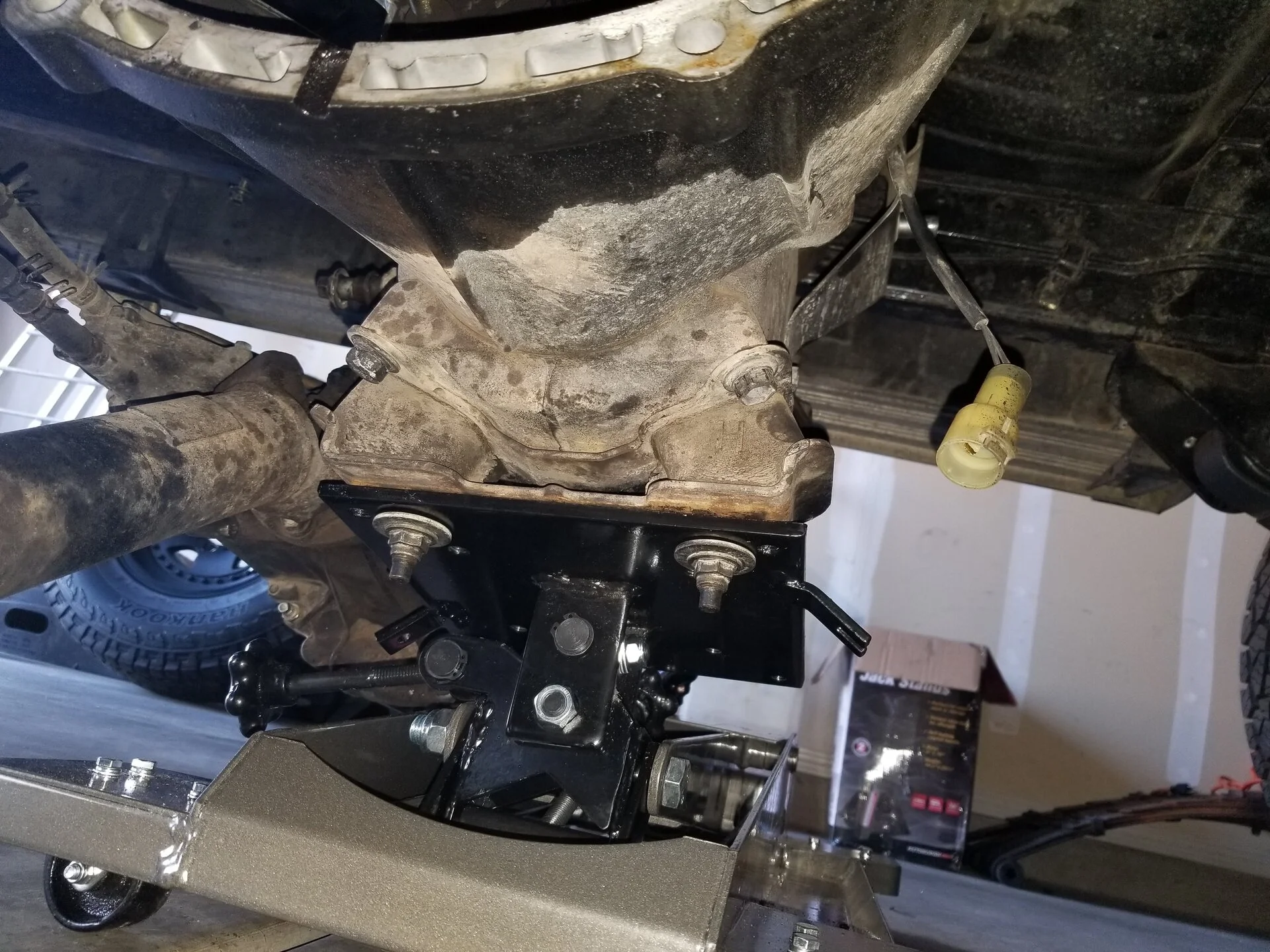

Not sure what your garage/shop setup is. But if using a transmission jack you can drill holes and bolt the mounts to the jack itself. Just need a strap to hold the tranny/tcase in place while removing the cross member. Tranny and tcase comes out together.
Credit goes to @CenTXFJ60
Ha. Now I may have shared this idea with you Mark, but I give credit to the MUD community as this is where I learned of this great tip :).
well that certainly is a "hot damn!" idea
