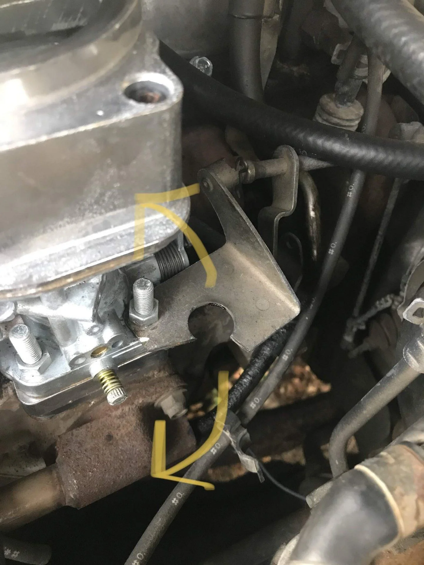

Heres a pic. Yellow arrow shows how I could rotate mine to adjust and then tighten the bolt down.

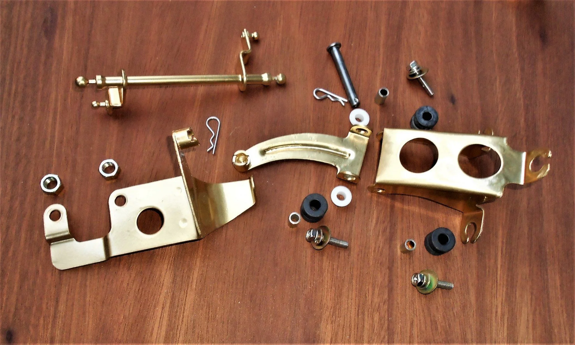

I can help with the linkage tech , info , pics of all
Related parts
stand by for all that
I know fj60
Linkage very well
usually it does not communicate well
Mechanically with the non toyota Webber design flaws
never really intended or well thought out to use factory linkage set up parts
I see you modified your carb base bracket a tad bit ?
I have not seen this approach before ?
where or who told you to do this mod this way
this will help determine your nest fee positive steps foward twatds sorting this out so you have a safe no hang up linkage going on

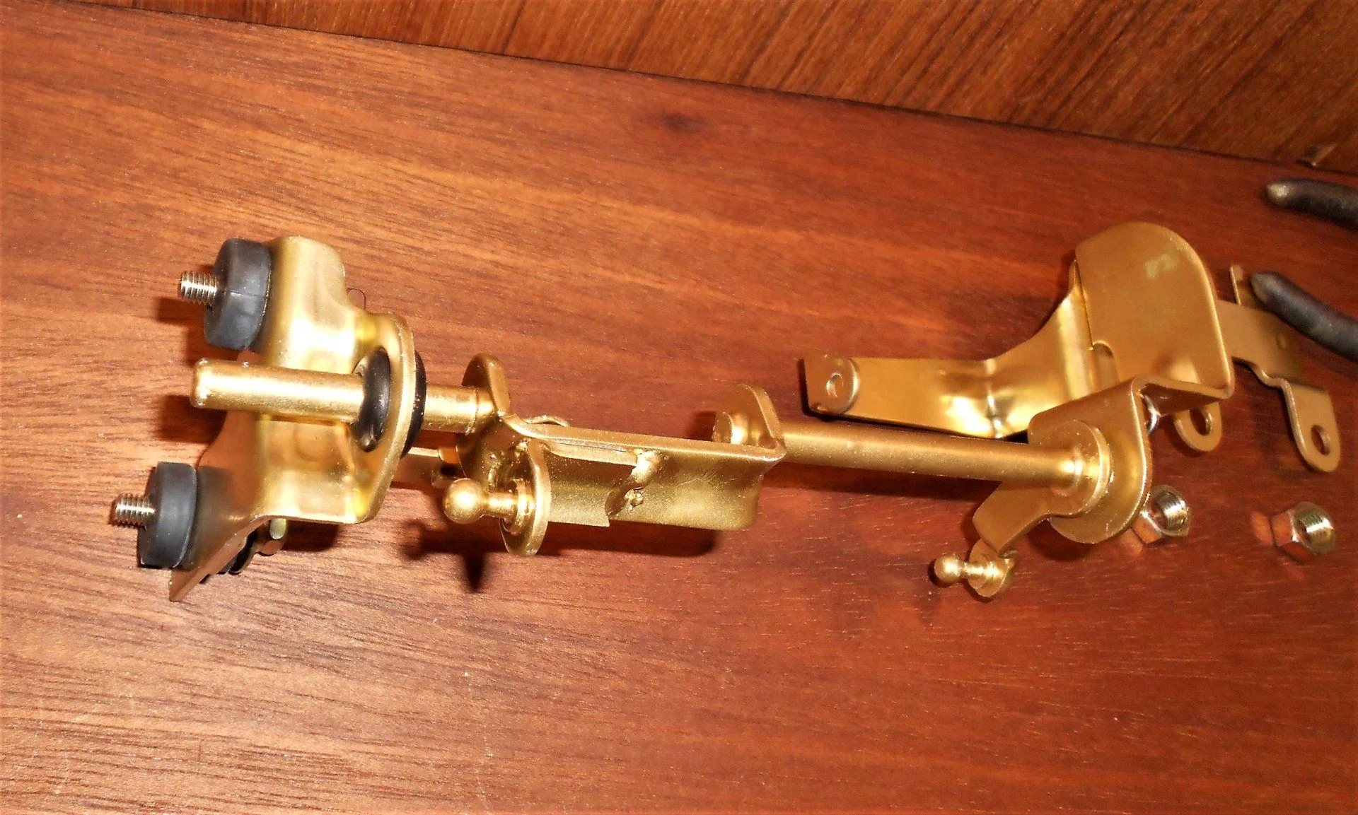

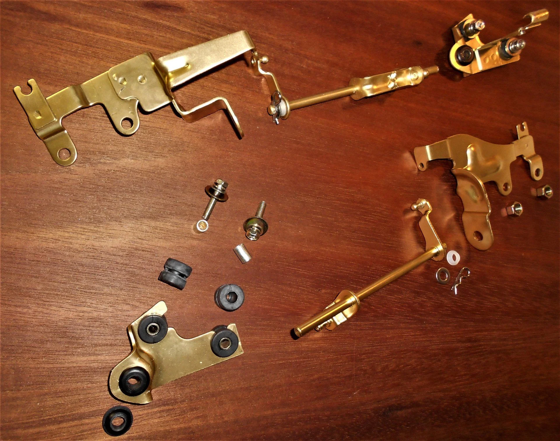

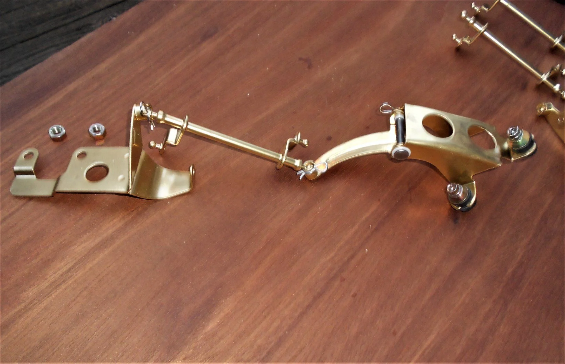

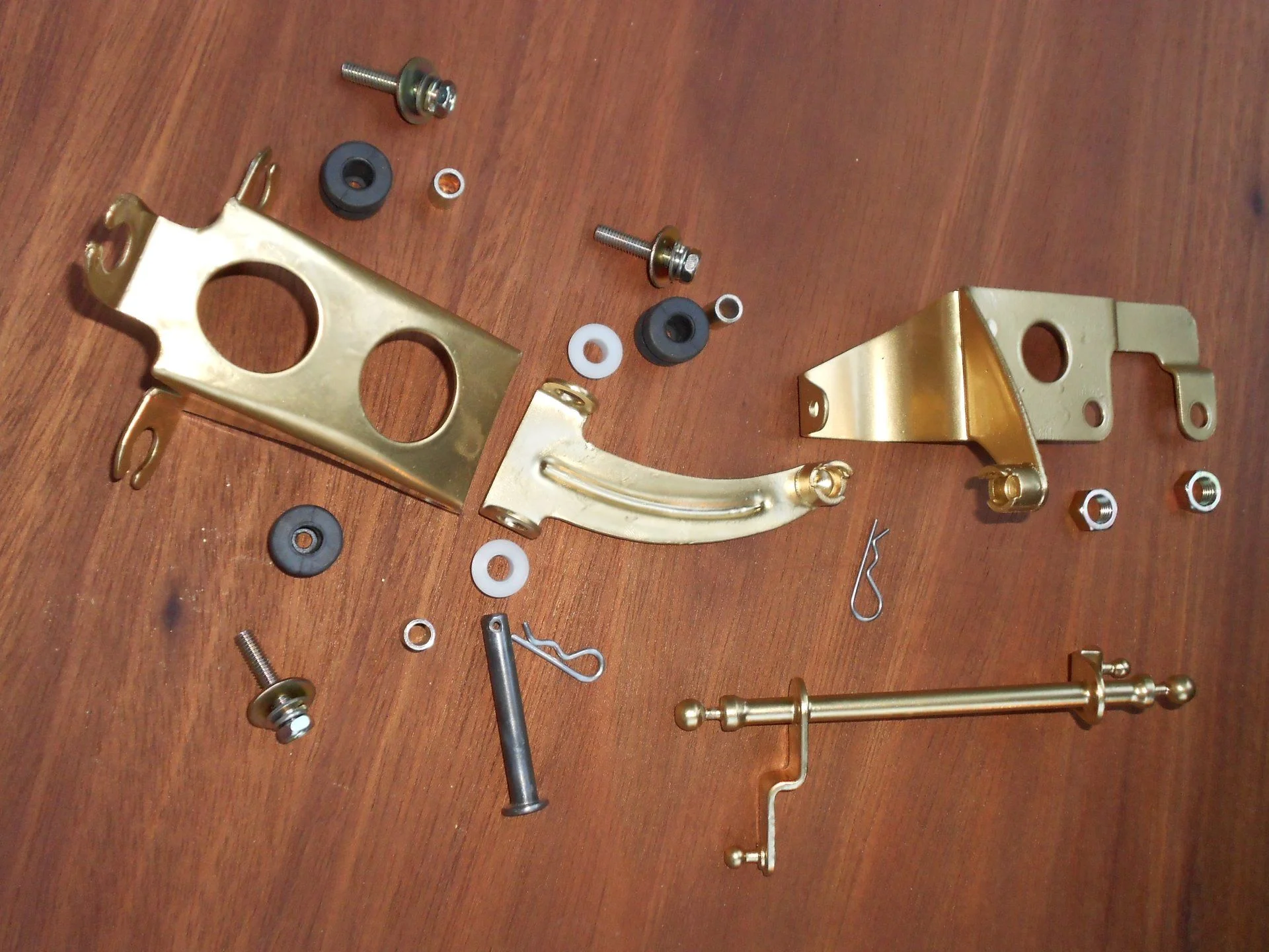

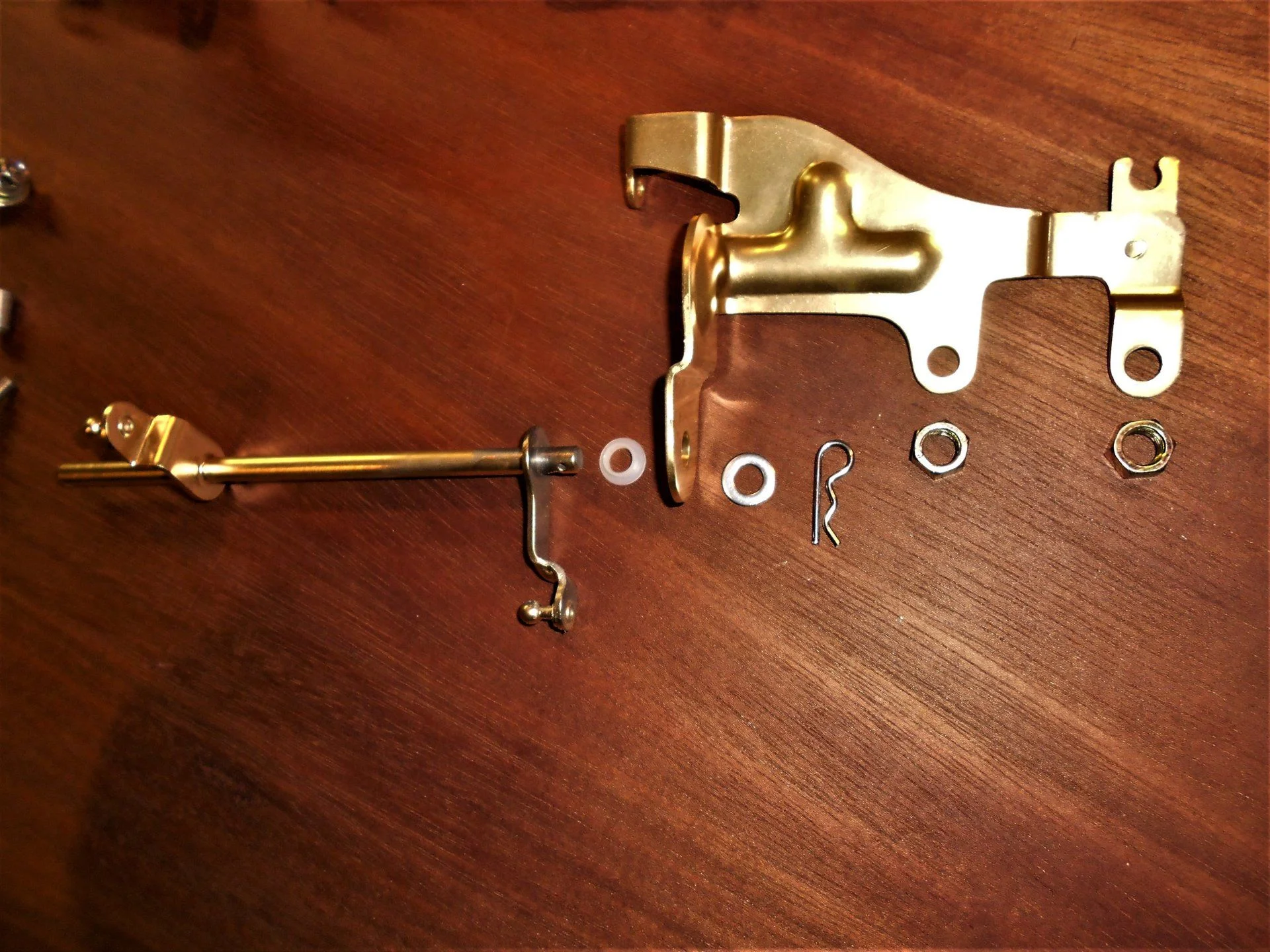

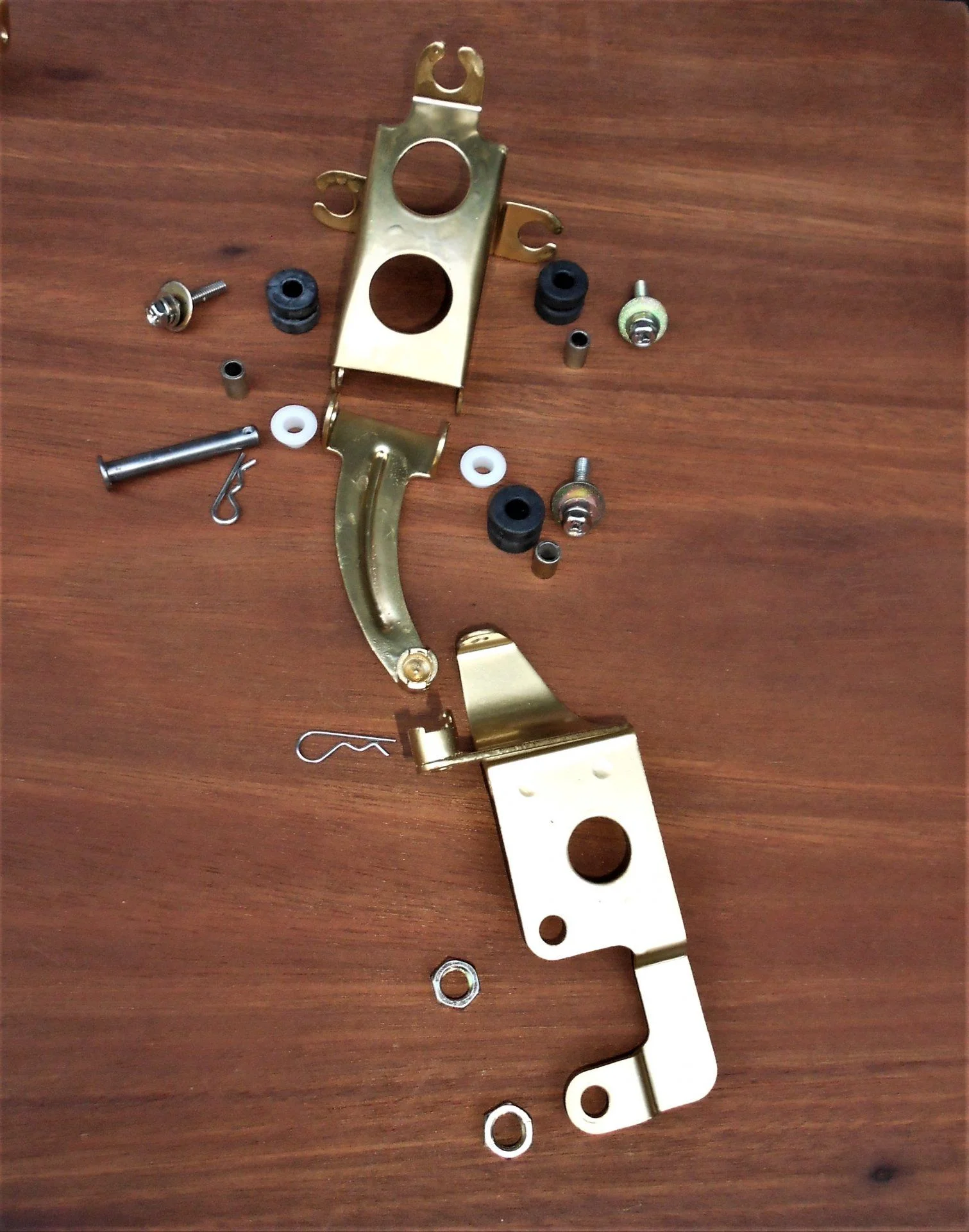

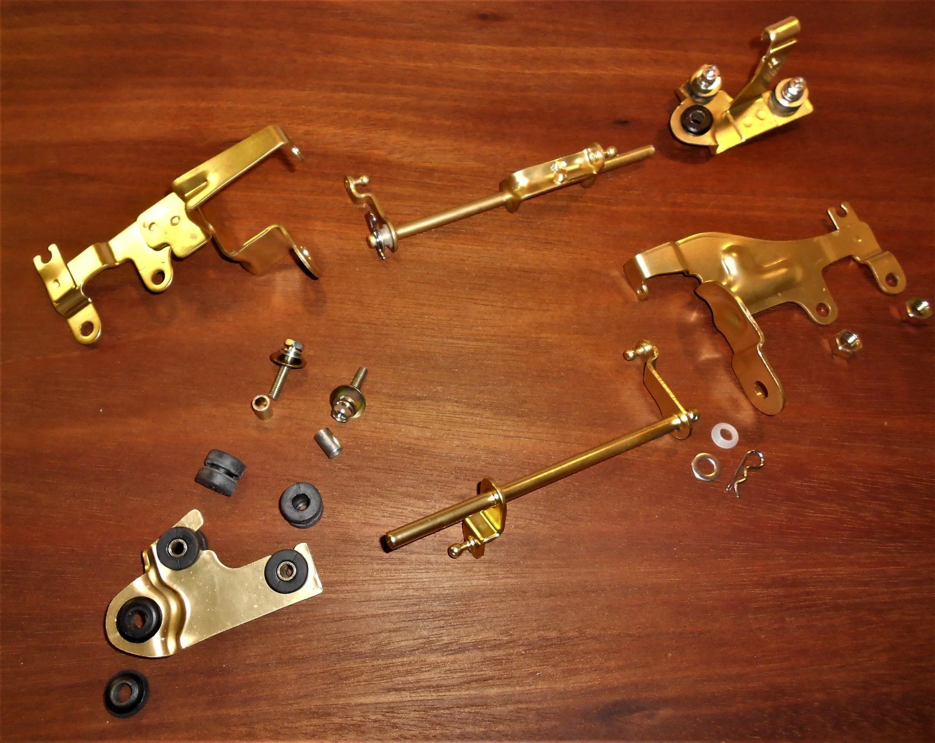

I have Fully Restored FULL Linkage Kits with NEW OEM Push Rod and Carb Side Small Accel ROD too ..
In this case Being Cheaper can cause a Jerry Rigged Cable to Hang up and well somebody WILL get hurt to say the least
