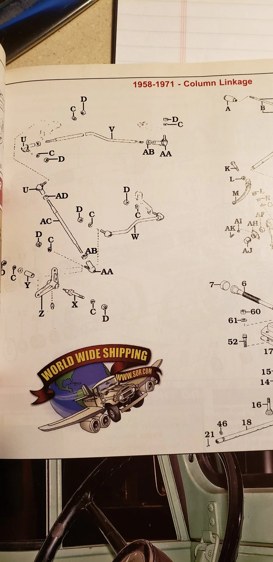

In this diagram (please remove if not allowed) I'm looking for 2 AA's, 2 U's and one W. The W worries me does anyone have a part number for that?
When I rebuild mine, I purchased 2 LH (U) and the rest RH thread. I discovered they were LH after I twisted it the wrong way. You have the part numbers as stated previously.
And as for "W", I just rebooted it with new boots from the extra new RH-connecting rod ends I ordered ("W" is NLA-Toyota 33730-60021 Rod, Gear Shifting 1969-1973 Toyota Land Cruiser 3373060021)

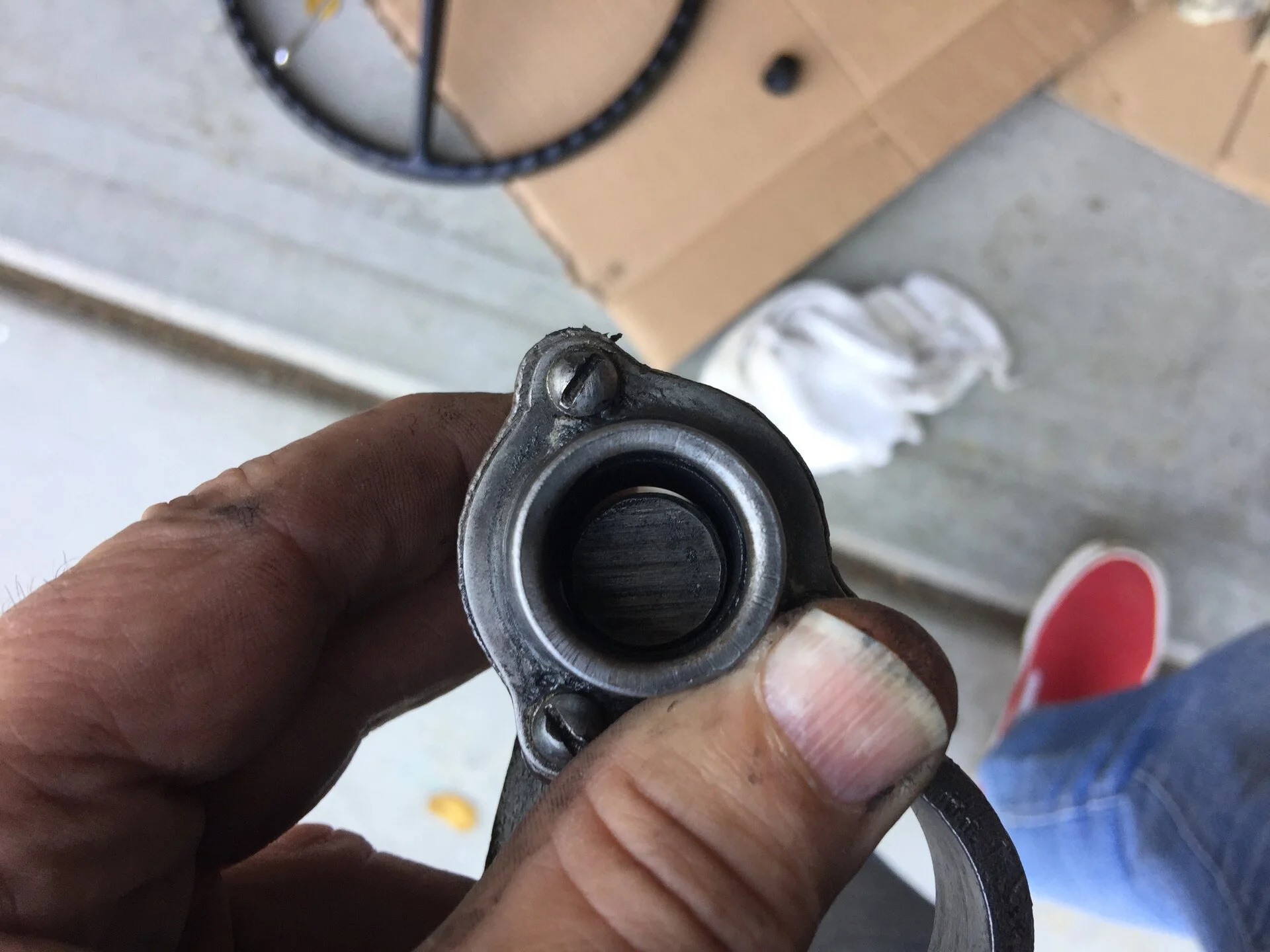

After fussing with the plastic spherical bushing, replacing several times, gave up and installed an aluminum bushing with a grease fitting. If that end of shift rod is loose, you cans make up the slack in the rest of the linkage.
This is the original bushing, look close you can see the gap between the shift shaft and the bushing.

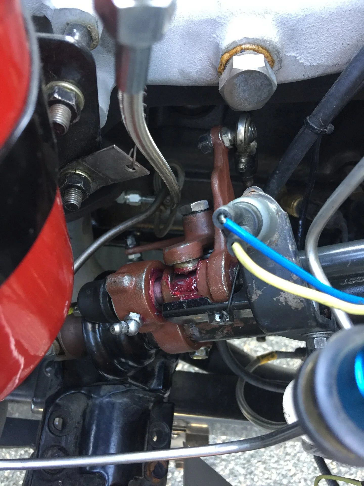

New Aluminum bushing.
Installed….with grease fitting….nice and snug.
When I rebuild mine, I purchased 2 LH (U) and the rest RH thread. I discovered they were LH after I twisted it the wrong way. You have the part numbers as stated previously. And as for "W", I just rebooted it with new boots from the extra new RH-connecting rod ends I ordered ("W" is NLA)

As far as the ball and socket rod ends, all replaced with spherical rod ends…with grease fittings….look at bottom picture, the rod end on the column linkage. No slack, no slop, direct shifts.
