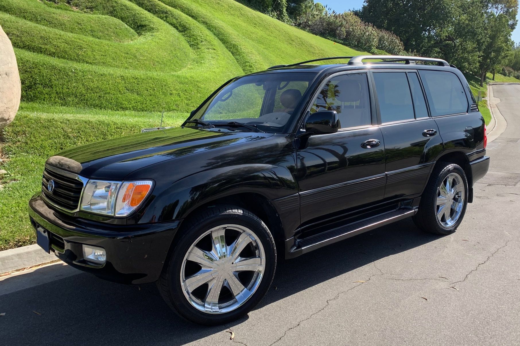

Hi All,
I have been eyeing a 100 series and talking with an owner about one. It has 270k miles and was in an accident back in 2018 (have the records and photos before/after). The owner was daily driving it until getting a smaller car this past month and is looking to sell because they don't need something so big.
The owner has been trying to solve some intermittent brake issue with the traction control light coming on and the vehicle braking, but the dealer has been unable to correct it since January. In that time they have replaced the brake master cylinder and ABS anti-skid ECU. The latest dealer recommendation was to replace some other computer, but I do not know any additional info. I have a call in with the tech that serviced it to get more info.
The original asking for the vehicle was $8k. Due to the ongoing braking issue and the possible $2.5k fix the dealer recommended, the seller agreed to drop the price to $6.5k. I just got the results of the PPI and it doesn't sound great. but I wanted to get some input on if you think I should walk or try to negotiate down and spend the time/money to fix. I am handy and would be looking to get my hands dirty as much as possible.
PPI Finds:
  • Antenna Mast In-op
  • Right side exhaust manifold leak (driver side maybe?)
  • Power steering rack and pinion leaking
  • Oil residue at engine to transmission junction
  • Pass side rear door lock not working and others stopped working after 1 use
  • Tailgate electrical lock not working
  • Driver side master switch assembly missing a button and some are faulty. Recommended replacing master assembly
  • Windshield Cracked
  • Tailgate rusty next to latch
  • Hood shocks need replaced
  • Power steering hose from reservoir to pump is leaking
  • Lower radiator hose at thermostat housing is seeping
  • Might be due for spark plugs and fuel filter
  • On the positive side, no rust, but I guess this is expected from a socal car.
Anyway, let me know your thoughts. Current plan is to pick it up this weekend if I pull the trigger. I would be looking to fix whatever I buy up so I can use it as a second vehicle for adventures.

So just spoke to the mechanic who did the PPI. Here are the updates he gave me from the original notes:
  • Exhaust manifold leak
    • Corrected this was the passenger side and he heard something that may be a leak but he did not diagnose it.
    • Confirmed leaking from both passenger and driver side.
    • Confirmed dripping, not a huge amount but some drips.
    • Corrected that this is just a rock chip above the wiper blade on the driver side. Said it could likely be repaired before needing to get replaced.
    • Clarified this is on the inside of the upper tailgate to the left of the latch. About 2" area where the paint has flaked away and the bare metal is rusty.
    • Clarified this is just damp.
    • Clarified this is crusty and stained from a past leak but not leaking currently.
Based on this I am thinking I would monitor the exhaust manifold and replace the steering rack. I think my only real concern is the oil leak at the engine/transmission junction. I know this is an older truck and expect some oil to be leaking. I assume this is the rear main seal which would require dropping the transmission to replace. Sounds like it might be fun to try but I would want to make sure I understand the scope of work before diving in.
In talking with the owner this morning they don't seem too enthusiastic about dropping the price more from $6.5k. I was thinking of accepting that price since any truck might have these main issues and sell for more since they do seem pretty common items that come up over time. Does this sound like a good strategy?

On second thought, those wheels and rabbit skin seat covers are a deal killer... move on.
Seriously though, those pics show the body well. A lot of potential on this Hundy.
Useful pics would be under the hood/engine bay, frame/undercarriage from front to back, the hatch rust spot, and any other rust mentioned by seller.
