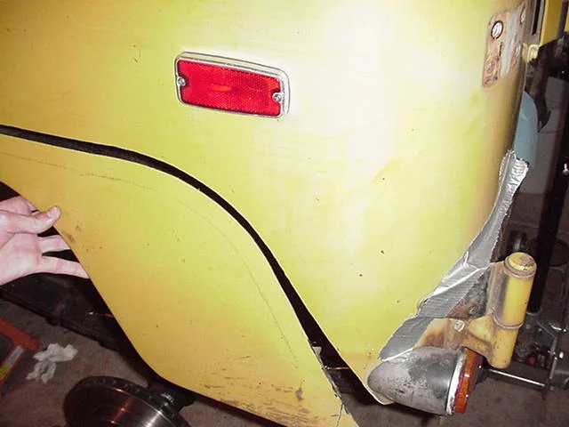

Love the extended wheel-base from my 55 springs, but was never happy about affect on wheel-wells.
Finally decided to do something about it.
half way there :D

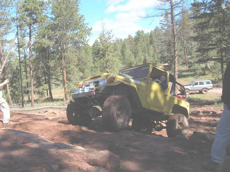

Why go to all the trouble of closing in the front side? Just trim the back out so that the tire is centered in the new opening. That way you've got room for bigger tires as well. In my opinion it looks better than the factory fender opening anyway and is much more functional.
I don't have any clear close up shots right now , but here a crop from a picture I do have handy to show what I mean.
Mark...
Metal...both sides, pretty much ready for primer/paint = 5hrs
Originally I was looking for TJ flares, but never found any...
Game-plan is to shoot the whole truck next WE, and felt It was worth centering the rear wheel-wells in advance.
thanks,
manny
Mark...
x2...
I've got a stack of those "sorta crescent" shaped pieces like on the floor in your first picture. Left over from opening up fenderwells after SOAs.
Mark...
Thanks for the posts, guys!! Now I know how I'm going to handle the lift on my '74, 55 rears, flipped 40 fronts, extended rear wheel-wells with TJ flares ! Probably 2.5 OME's all around, I have a 2" body lift already. Then drivelines and 38" Swampers. I LOVE THIS PLACE !!
