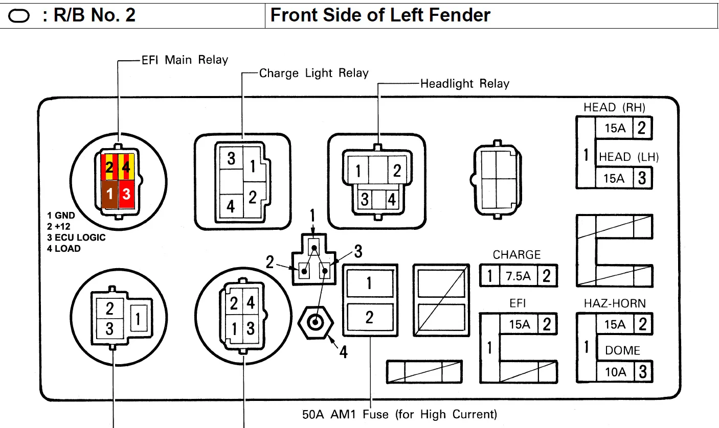

Nothing in the HVAC system gets a constant +12. Everything is switched by the ignition switch.
However, the interior lights are fed a constant +12. If you remove the DOME fuse from the under hood relay box, I would expect this gremlin to go away. Once verified, we can continue.
Pulling the 10A dome fuse does stop it.

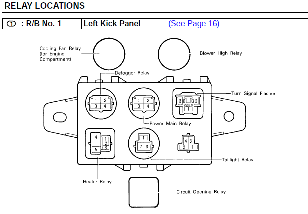

I'm trying to figure out where this ground loop is originating from. The only common ground points between the HVAC system and interior lights is ground point BF which is under the center console. That is the ground point for the rear heater relay, which is most likely the buzzing sound you're hearing. Please verify that this relay is the one making the sound that you claim is coming from under the steering column.
I could not localize the sound to any of the above mentioned relays. None had a vibration I could feel. Pushing and pulling on them made no difference in the sound. I pulled several, and had the wife confirm my observations. She has much better hearing than I do. Some or all are activating when the driver's door switch is activated with the lift gate up and the interior lights in the auto position as before.

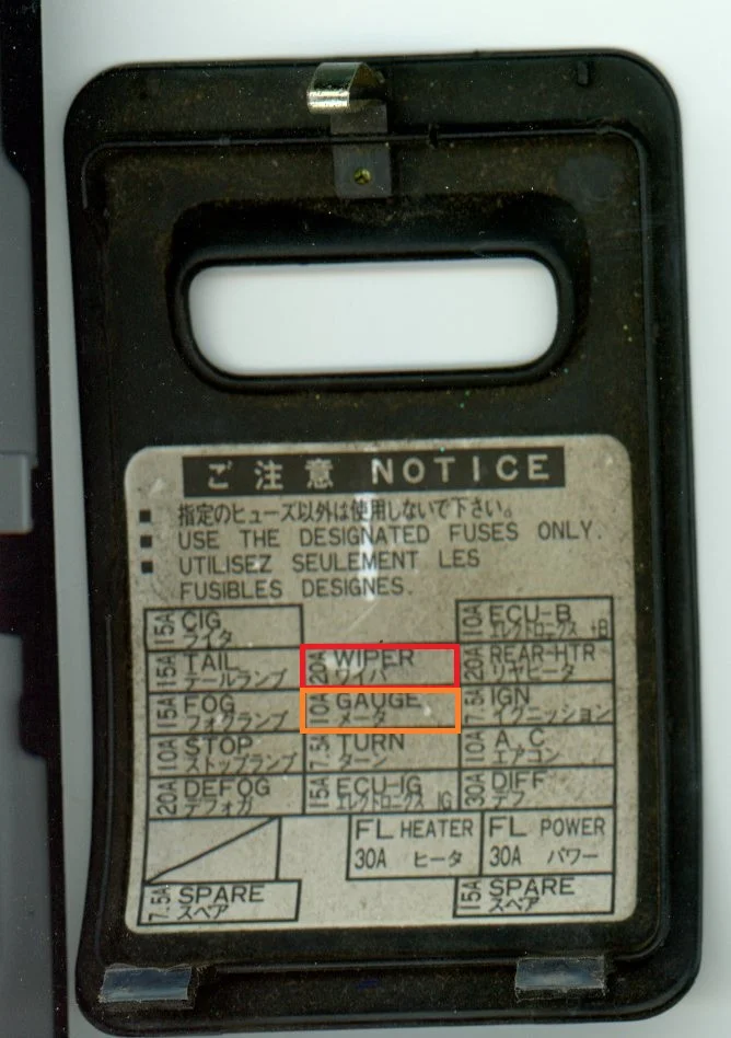

The fuses near the drivers' left knee may have privided a clue. The 20A wiper, and 10A Gauge fuses both stopped the noise. Taking the wiper switch out of the park position also stopped the noise.
I can feel and hear the relays activating. They are all jammed together so determining which on is being activated is difficult.
You can put a finger on top of the relays as they are being activated to determine which one it is by feel.
