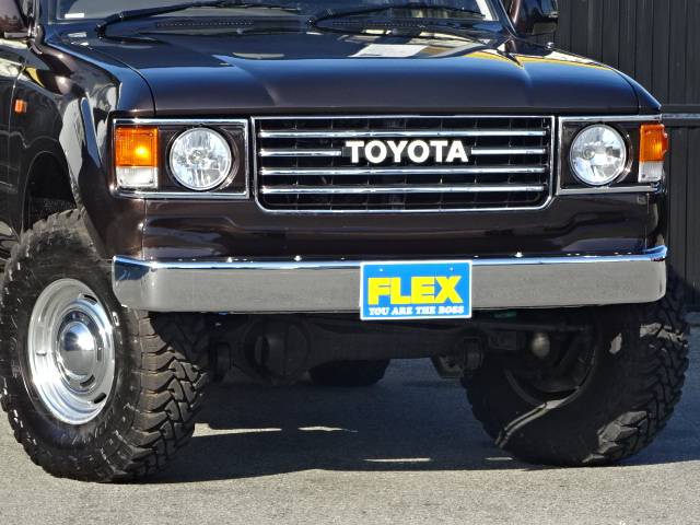

This is beautiful...somebody make it for me (60 headlights on an 80)!
That looks like a much easier approach than having to graft new fenders. Looks like all they did was modify the lower valance to fit and add some filler material under the corner light.
You are right. "Some filler material under the corner light" is the ugliest part of the face. I'm will change it.
very cool, no fender work is much appreciated. Now I just have to find or duplicate another one for me :(
If you have enough bandwidth to upload a bunch of pics of the grill with a meter-stick next to it and show all the construction details you can. If I feel ambitious I might try to duplicate it later in my build (2016-17) but if anyone wants to tackle it in the meantime I'll sign up on a group buy.
Can you fab up something like Shevgen has? Then you could leave the fenders stock...
yes but I don't think it looks good. It looks unfinished to me. I'll be using the 60 turn signals like Flex in Japan does. It's only gonna be 3 pieces of sheet metal to add (per side) 2 for the fender and 1 in the valance. Cut weld grind bondo paint.
I'm interested
Think it'll be that easy? I dunno. Seems like the 60 corner light isn't going to blend into the contours of the 80 fender/corner light. I think the square edges of the 60 light will stick out in the corners unless you do a lot of modifications to the fenders - if you want that seamless look. Lower valance seems simple to fix. The hard part will be those corner lights. I haven't compared in person so it may be easier than it seems in pics though.

I just picked up a 60 series grill and headlight plastics for mock up yesterday. I think to do this right you need to do the 60 series valence too. Then you can have the option of running a 60 series Arb or Tjm or you could cut a bit off the bottom of the 60 valence and run an 80 series bumper.
Unless people are more interested in the other style? I find it less complete but I guess if you added maybe a cross between the two you could make it work. The other style doesn't have the bevel around the corner lights or the add on piece on the hood either. I think it looks terrible with the stock bumper. I could potentially get conversion fenders replicated in FRP if anyone is interested. Depending on the direction could get the valence replicated too.
would a 60 bumper have worse approach angles, or do they work around the valance enough? I want it to look good, but I also don't want to go banging the bumper around.
