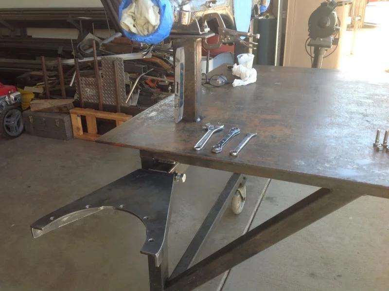

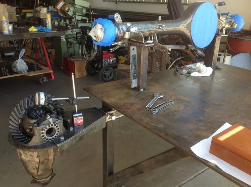

Prior to starting the front end rebuild and ARB install I designed and fabricated this handy jig. I have been using this for the third member rebuild and it really works well. I welded a receiver to the bottom side of my welding table allowing a secure platform drilling/tapping, hammering and checking backlash. I drew it in CAD and cut it from 1/4" on the CNC plasma.
Once the work is completed I can pull it and stow it, then use the 2" receiver for another application.

very clever!!! way nicer than my old coffee can. time to upgrade!!!:cheers:
Very nice design. I mounted mine to an engine stand. Nice being able to rotate it. I could do the same with your design. Could you email me the cad files? Thanks
