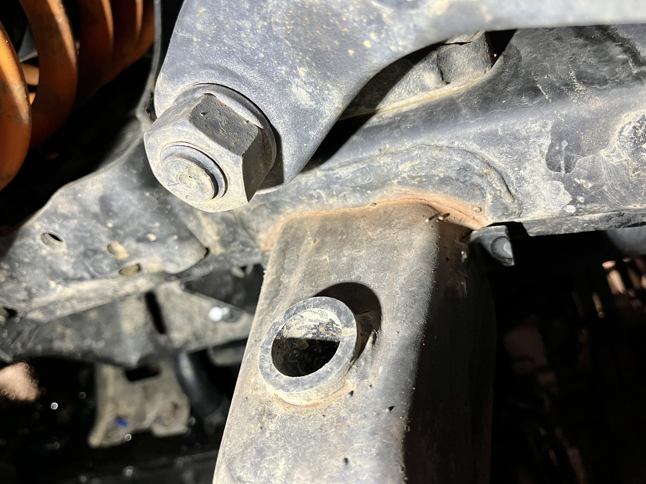

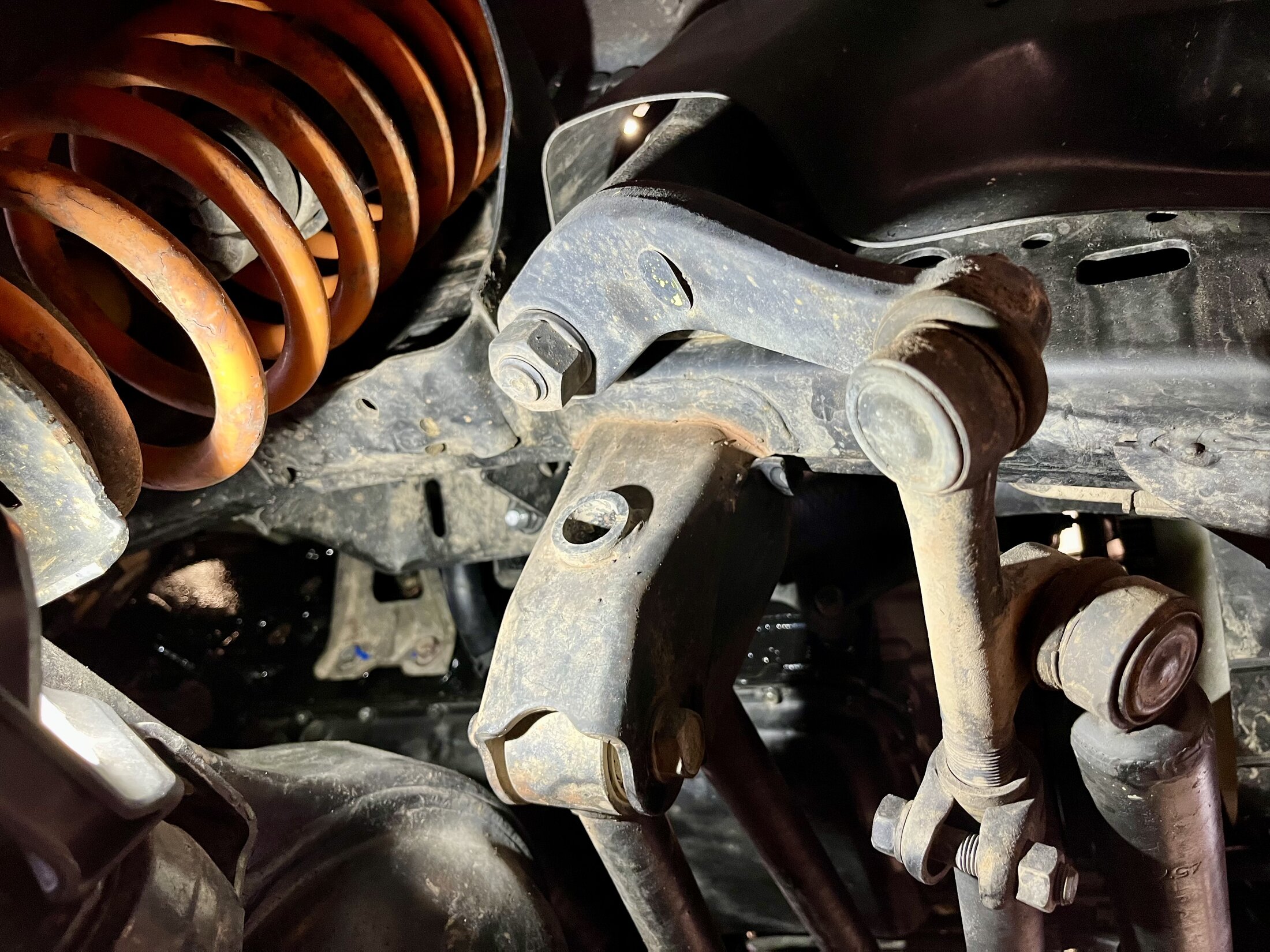

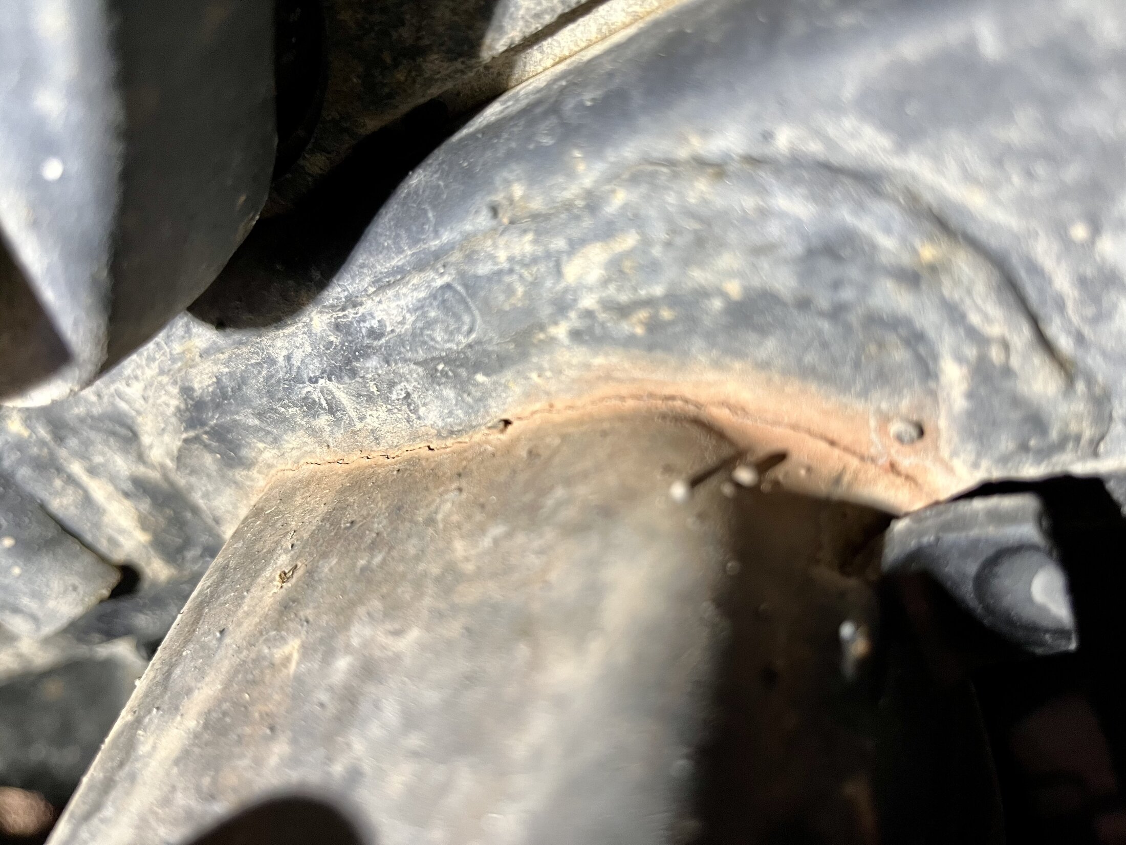

I’ve welded in the reinforcement. That involved me removing steering box & steering arm. Now I’ve also put in delta 3L lower controls arms and pressed the bushes in myself (noticed the crack right after that).
After assembling everything together with new steering stabilizer, it just sounds off when driving, especially breaking. Sounds loose and can almost feel it in the steering. Can’t really notice or hear anything at speed or when accelerating, mostly when braking.
Steering box has new 1/2” grade 8 bolts, all are tight.
Control arms bolt and nuts are tight.
Knuckle arm bolts are tight.
tie rods and steering stabilizer is tight.
Steering coupler is tight.
Took the brakes off on the left side, caliper is tight, brake pads are good (still making noise after putting them back together).
Bled the brakes.
Checked for bearing play, none.
I can’t find a single loose thing, took it for alignment at stellar built and couldn’t find anything on the rack either.
The reinforcement is still welded it and hasn’t cracked off even with my booger welds.
Is there something I’m missing? Or just increased road noise transfer from the new arms? I mean it almost sounds like balls in a drum….

Chasing my own tail here…
Bled the brakes.
I'm going to say drive shaft.
Pull the front and use the center lock to go for a drive.
If the nose persists put the front back in and pull the rear and repeat.
But my money is on the front as you just changed the pinion angle with the new Delta arms
i think you’re on it. Because I’m getting like “tire balance” vibration at 70 now.
Dang, blowing money makes you blow more money. What’s the solution, double cardon?
