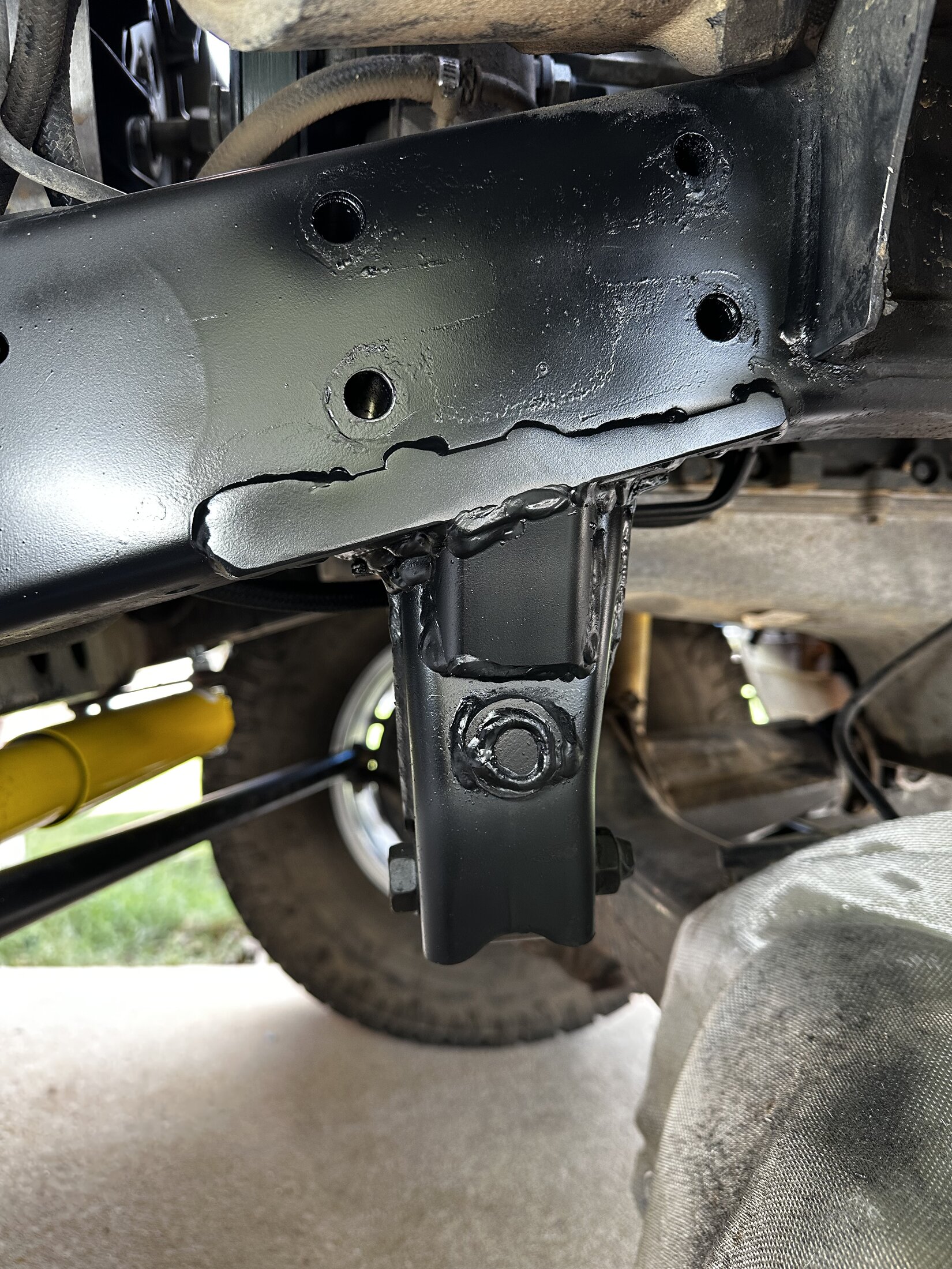

I found out why my 80 was suddenly started to wander again. No parts old or worn on the front. With my son moving the steering wheel back and forth, I could see the crack at the base of the pan hard bar mount. Time to bust out the welder and see how I can best reinforce this.
That sucks…make sure you put in reinforcement or it will happen again.
Yes. I have plenty of scrap steel. I’ll drink some beers while I ponder how I want to do this 😜
If you're looking for a solution with random scrap, here's what I did
Find the extreme ends of the crack,
Drill 2-2.5mm hole through the frame at each end of the crack,
Clean up and re-weld the crack,
Gusset between the outer corner of the frame rail and panhard bracket with 1/8" x 1" flat bar,
Stitch weld gusset in place.
My thoughts were, a gusset transfers the bending moment from the middle of a flat surface (underside of rail) to the corner of the frame rail. It's a more rigid part of the rail.
The welds for the gusset are away from the fatigued metal around the crack.

FWIW the DIY solution in post #7 get my vote as one the best fixs offered.

Stripped as much as I can to weld the new brackets on. The outer fit is good, inner fit needs to be trimmed on few spots.
Definitely going to be a challenge to get to the top inner bracket, especially with those brake lines in the way.
IMO those plates mostly address steering box issues. There not going to do much for the side to side forces the Panhard mount see.
The out side one could be useful to tie a brace into like the one @Richardlillerd! used in post #7 or the one @808keith made in post #49
@mudgudgeon uses the same logic in his post #43 brace the mount to reduce side to side motion/flex !
Unless the frame is cracked around the steering box mount I would not use the inside plate as it's to hard to get a proper weld let alone Prep /clean the area for a good weld. if the motor was out that would be a different story.
I'm by no means a engineer but I would like to see the holes in the out side plate bigger to allow more penetration of the welds.
