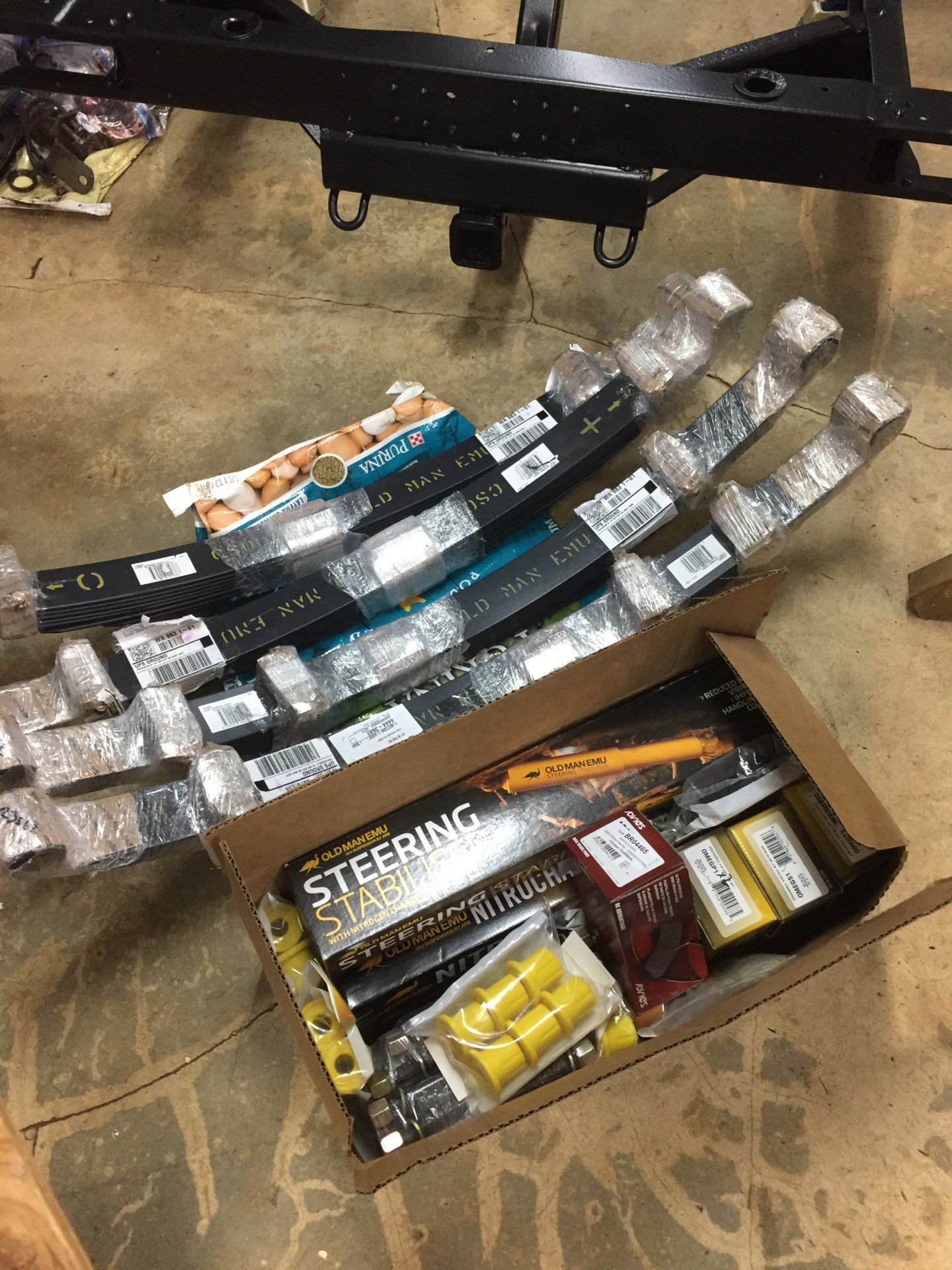

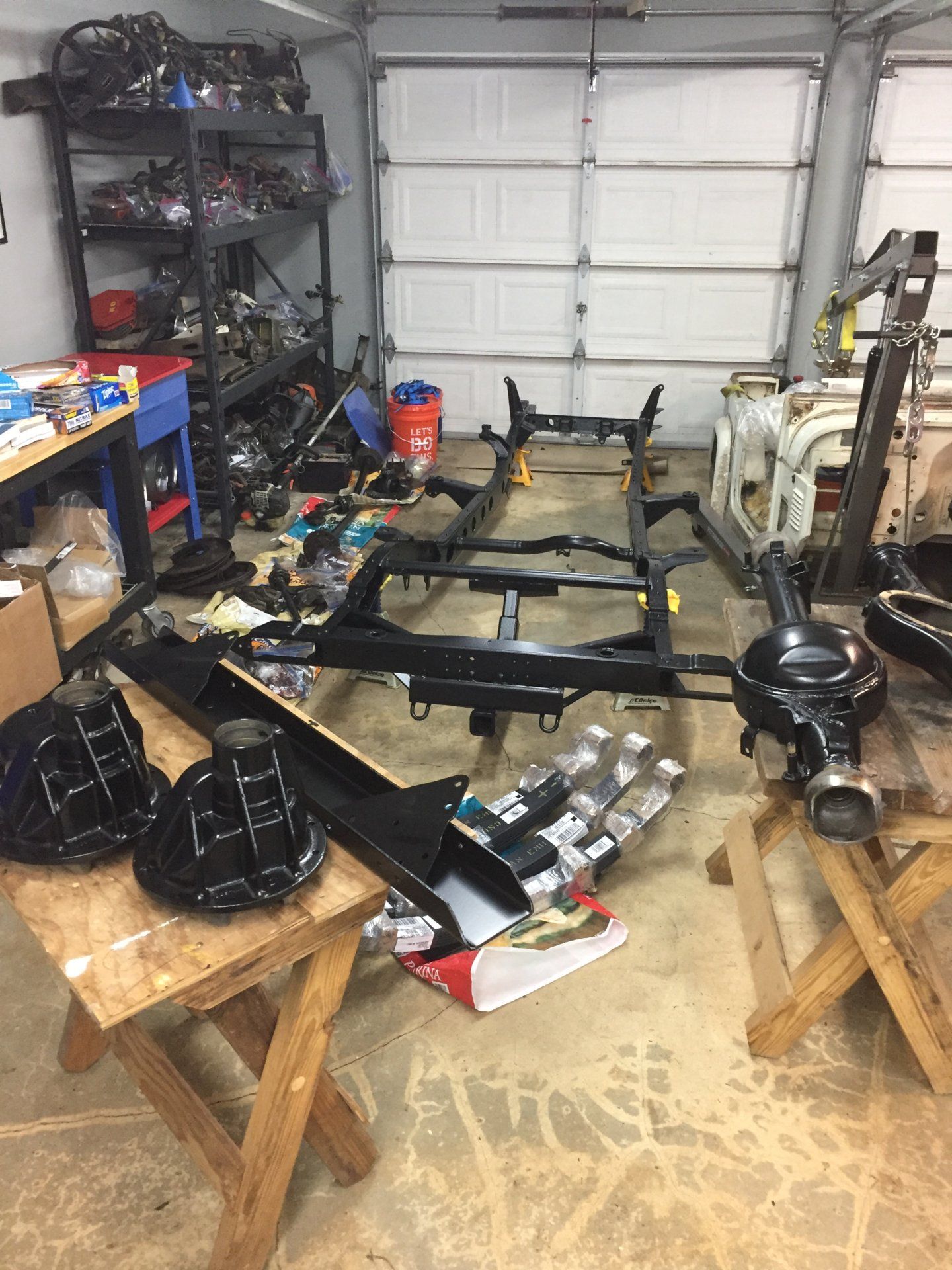

Today is a huge milestone! Got my frame, axle housings, and front bumper back from powder coating. Looks great. Also received a new OME 2.5” Heavy suspension from @cruiseroutfit (ters).
Thanks again!

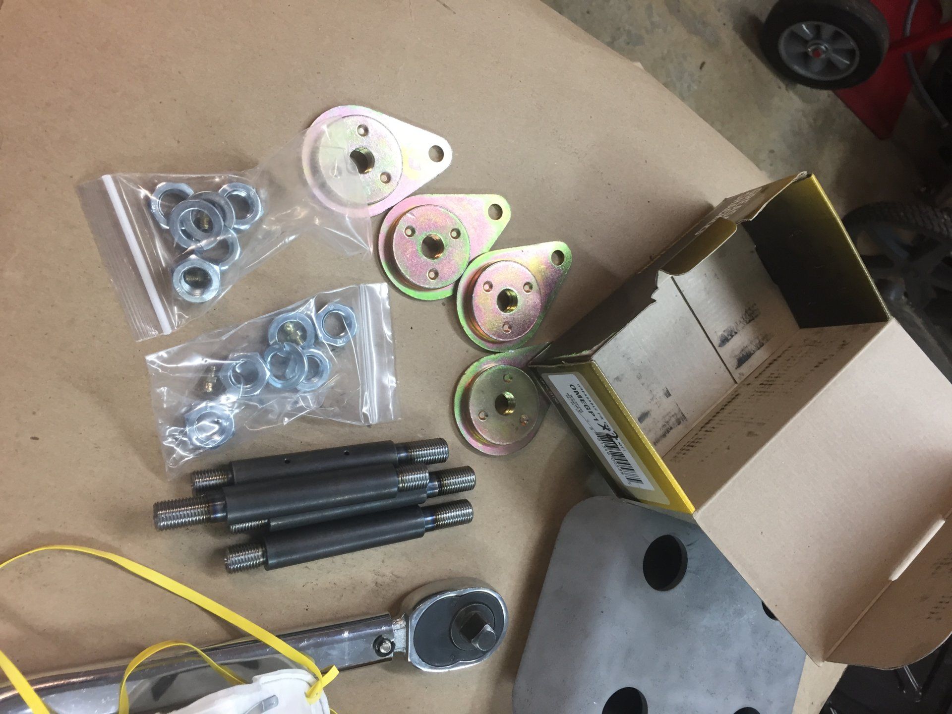

Did that new cross-shaft retaining bolt arrive too?
It did, but I seem to be missing my stickers... :) I framed the autograph.
Ha! Bryce brought a box into me and asked if I would sign it, I knew exactly who was asking :D
If your stickers are missing, let me know and I'll mail off a batch.

Nice! The frame looks great, good choice on the Cardinal BK08 ;)
Suspension on! OME Dakar 2.5”.
Yeah.. was like that from a PO. Seems pretty stout. I don't plan on towing anything with this rig. Do you see anything I should remedy?
Its not uncommon to see an FJ40 with Rear Crossmember bowed out from some moron trying to pull a stump with strap tied to crossmember. That one looks like it has some serious bracing.
Can you take a picture from the rear of frame?
It looks like it hangs kind of low for my taste. But seeing how the Powdercoating is all done, i would probably just move on and not worry about it. :meh:
Interesting trailer hitch
Yeah, since the powder coating is finished I'm betting it's a great hitch... :) But seriously, it is well braced. It did have a 4" lift on it so it was probably about right.
