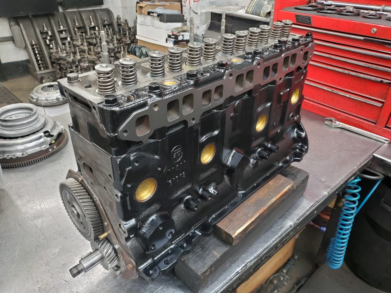

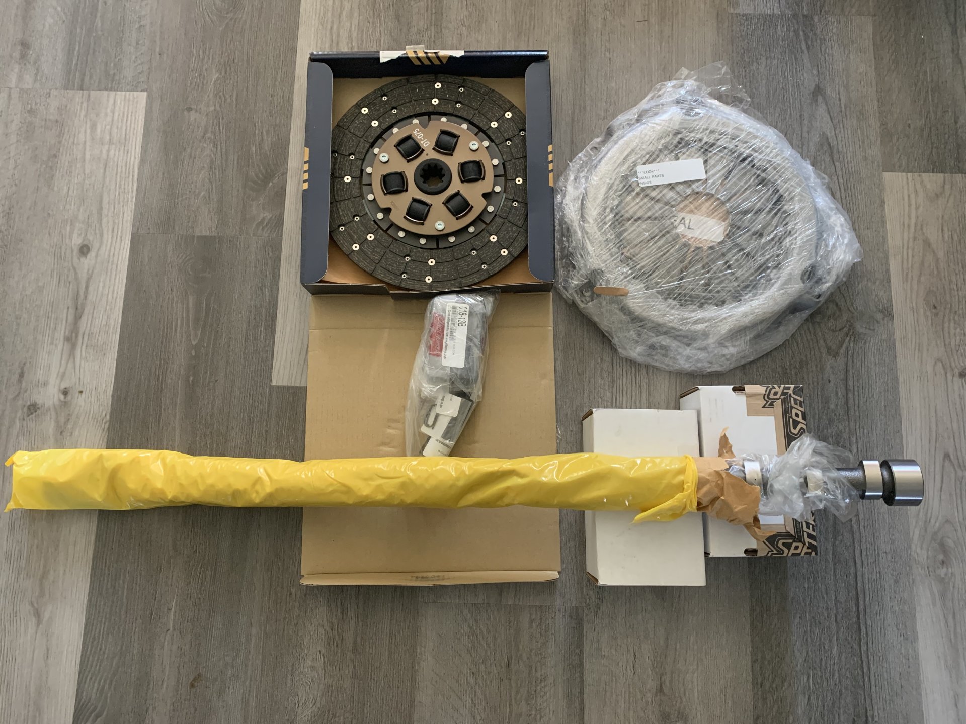

Received two boxes of goodies today!
I am anxiously awaiting my engine’s return! Getting some excellent pics and info from the shop as they wrap it up.

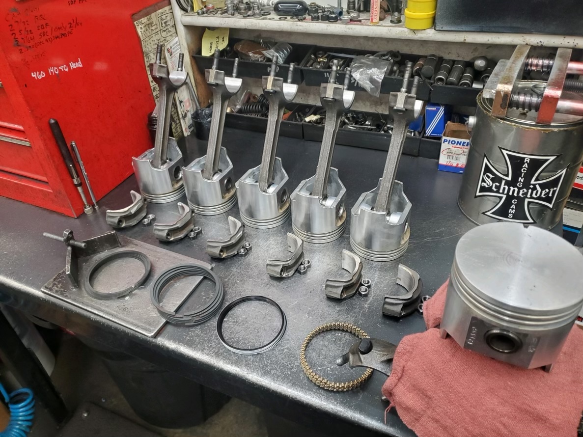

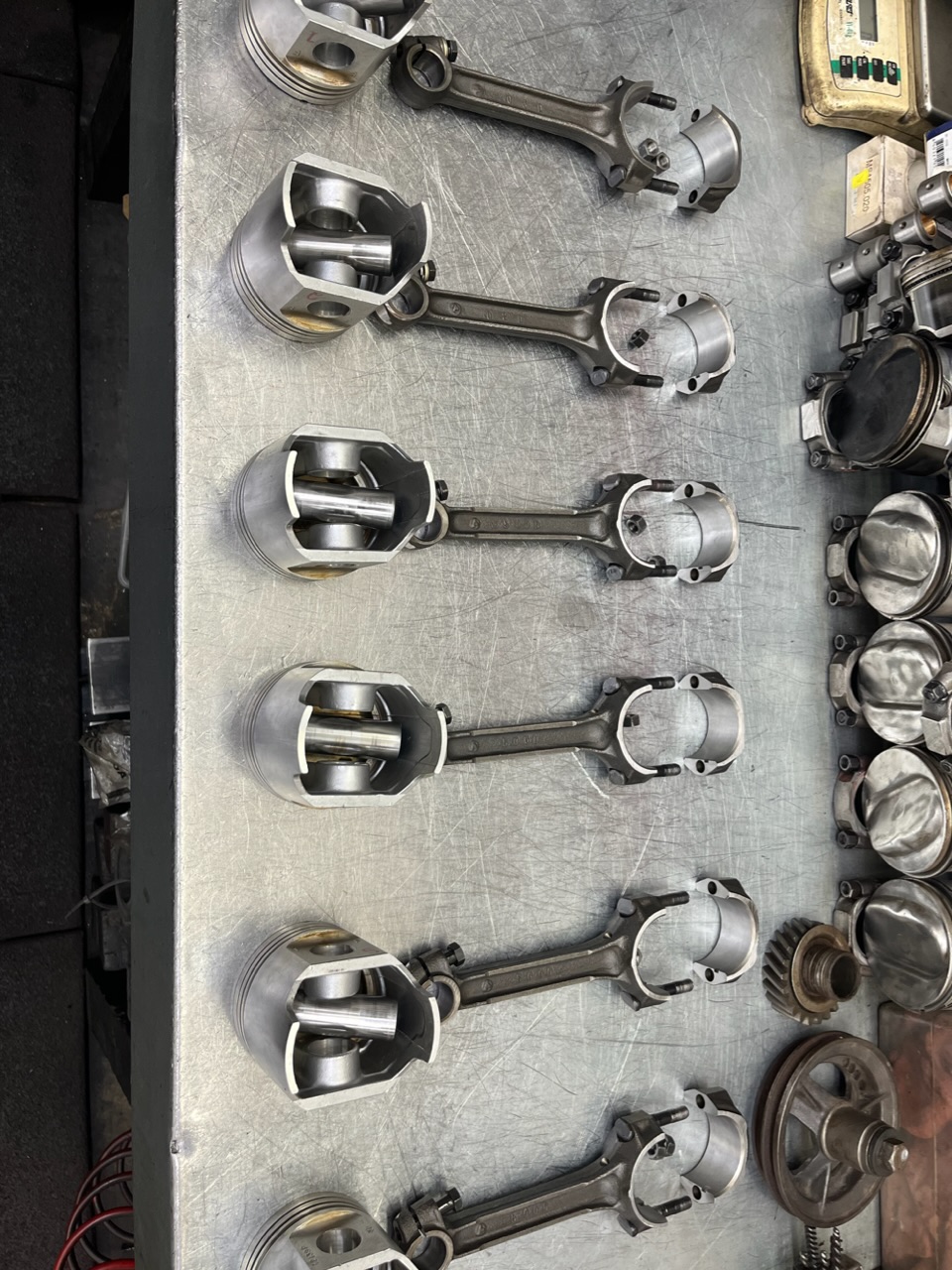

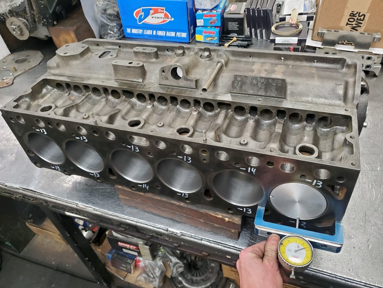

-Finished up the diamond hone.
-Rods all reconditioned/ pistons all clean up and everything matched and balanced.

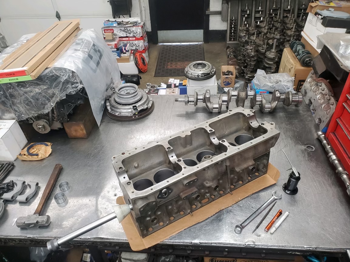

-Mocking up before decking.

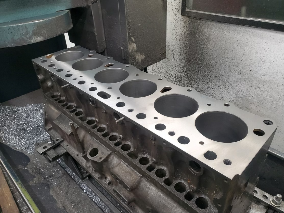

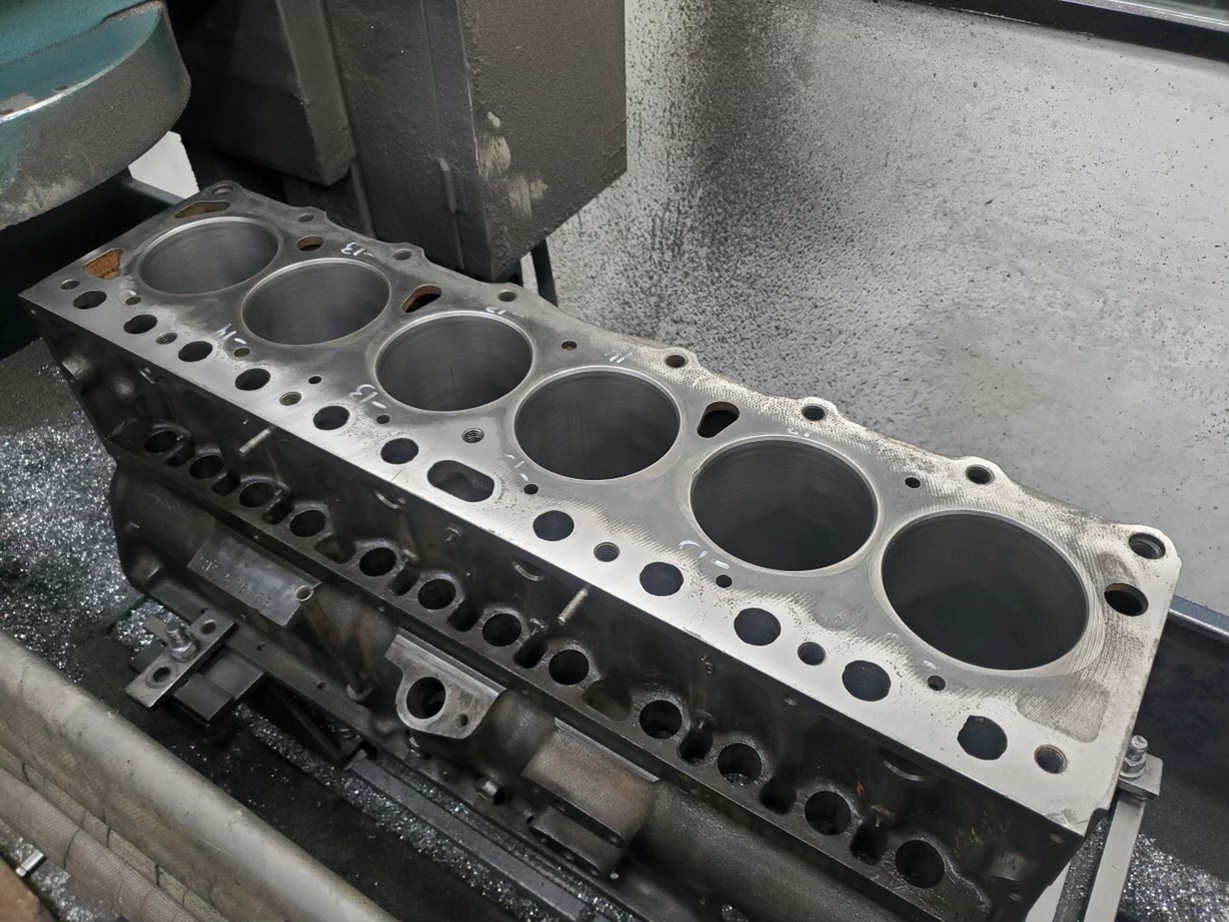

-One skim on the deck you can see how warped it was.
