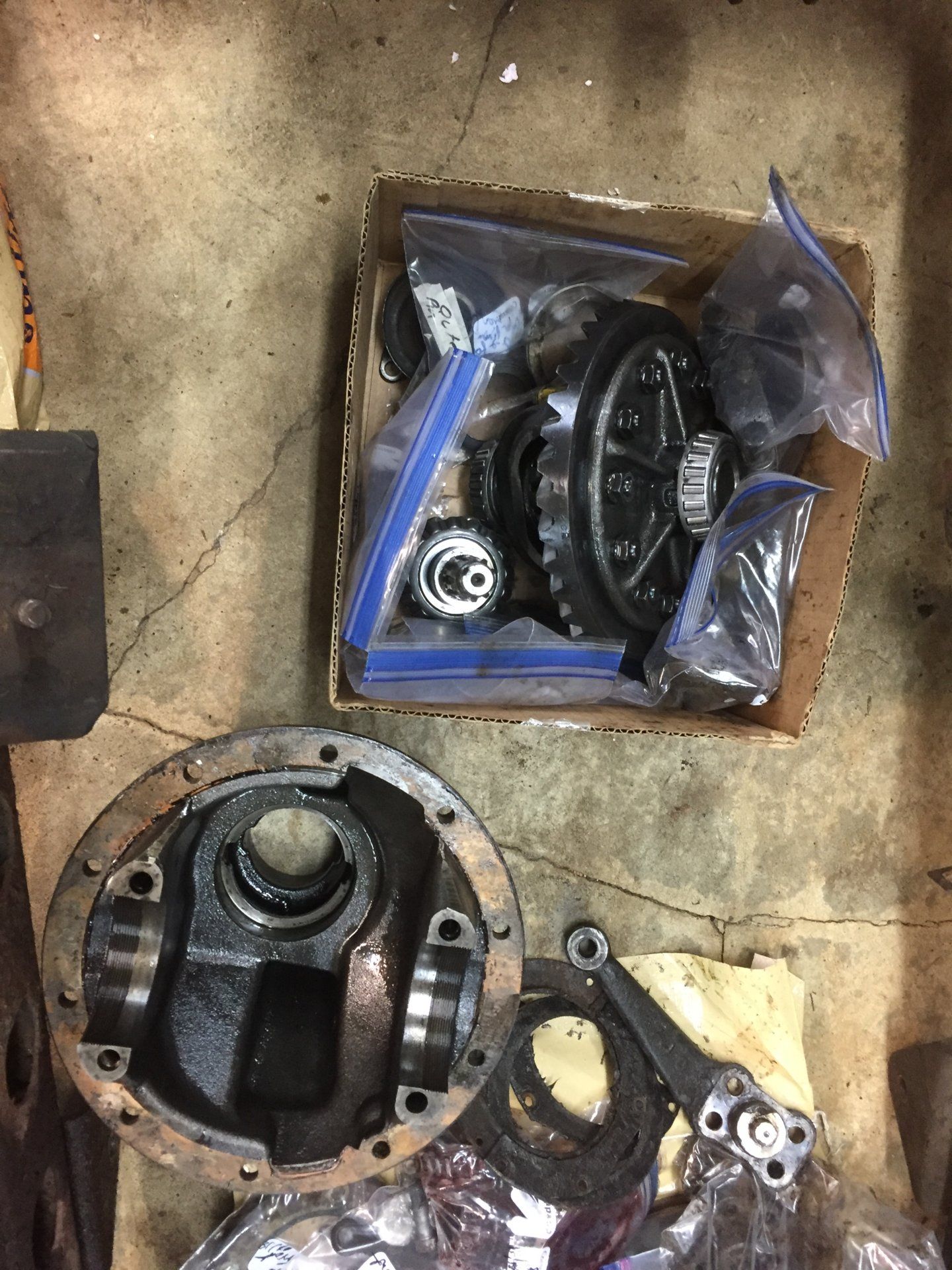

Since this is my first time I was able to compare the excellent rebuild kits I received from @cruiseroutfit with what I took apart so that I’m able to wrap my head around everything. Looking good!

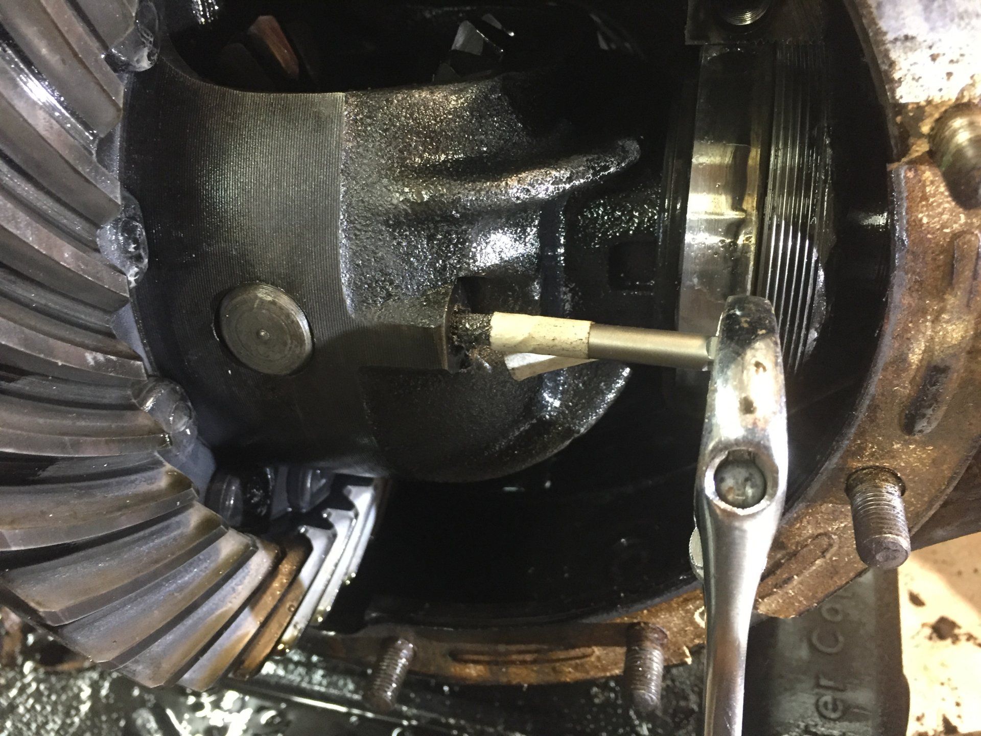

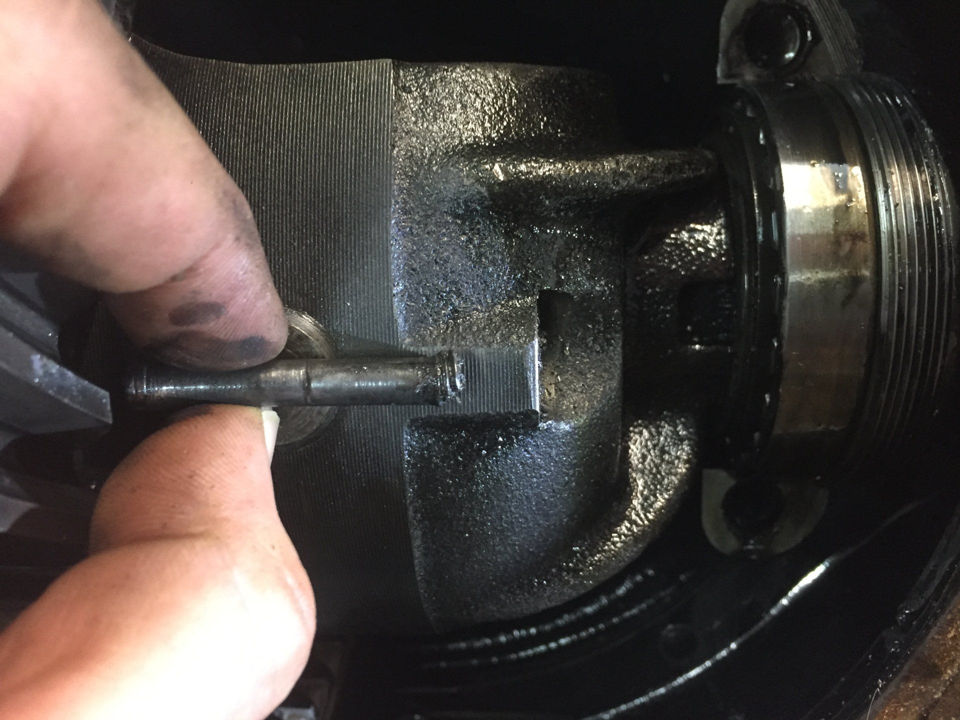

Got the broken pinion shaft bolt out!
Drilled a small pilot hole through the broken head, put it back in and used it to drill a centered pilot hole in the bolt shaft, then drilled out the shaft with a larger bit, then inserted the Irwin Hanson extractor, set it with a hammer, and backed it out.
Great save!

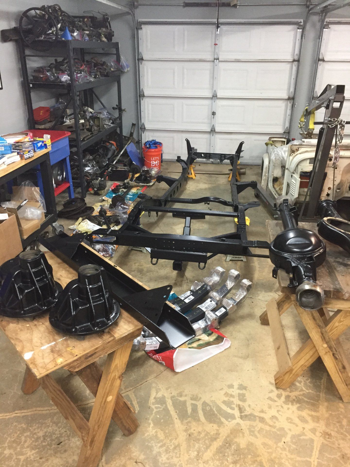

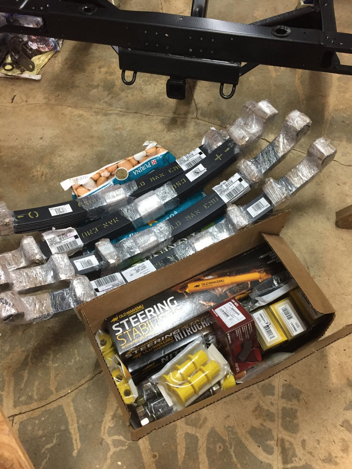

Today is a huge milestone! Got my frame, axle housings, and front bumper back from powder coating. Looks great. Also received a new OME 2.5” Heavy suspension from @cruiseroutfit (ters).
